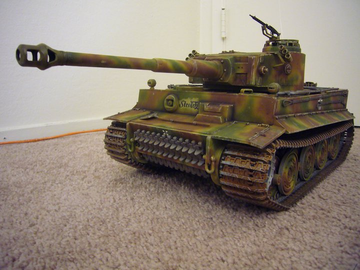

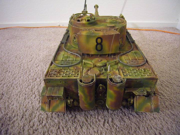

I just convert a my HL tiger into late style.
However, before my convertion, I bought inital decal..........
then....I used it, so, can anyone show me pictures that will fit my tiger?
There is no number of "8" for late style right?

That is a very well done Tiger.

There were some late Tigers with single digit numbers. I recall a photo of a late tiger from PzAbt 508 in Italy with a "1" on the turret bin. So I think it may be possible for an 8 to have existed.
Your writing on the front plate, I have seen that before in a photo. I forget what Tiger it was.. I like the camera angle on your front-side photo.

One thing is a late Tiger would not have the smoke candle launchers on it. But as it has been said the # 8 could have been used.

You wont most likely find another pattern too fit the name on the front. That tank was that tank.

This looks like your tank here:
[link]http://members.iinet.net.au/~wackywheelz/tigers/strolch_meyer_8.html[/link]
It has a black "8", and the "Strolch" on the front plate. Schwere Panzerkompanie Meyer. Though it is an early model, not a late..

Your Tiger is the "tramp or vagabond" of the Heavy Tank Company Meyer. Basically a homeless, wandering Tiger, that doesn't know whether it is coming or going lol. That is what it means..

Hey Pang,
To really convert to a Late Model Tiger, you need to notch the front area where the tow shackles are. The smoke launchers have to go. Late Tigers had only 1 headlight in the center of the front.
On the rear the tool box needs to go. And if you get really picky the adapter plate must be modified. Also in the picky picky area is the rear engine cover has to be modified with a triangular cover. The air cleaner intake is replaced with an armored cover.
On the turret there are three posts for use of a portable jib crane. The ventilator is moved to the center. In it's place goes a close in self defense launcher. And you need a turret protection ring, and cut of the bottom of the hinge for the escape hatch.
You need to add C hooks to the upper hull and on the rear left.
Then you need to move the tools around. I'll get yous some more pictures.
None of the above takes away from your fine job, however I can tell you are a guy who wants his tank to look the part.
