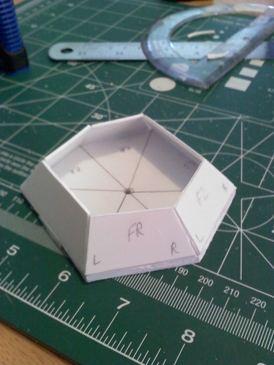

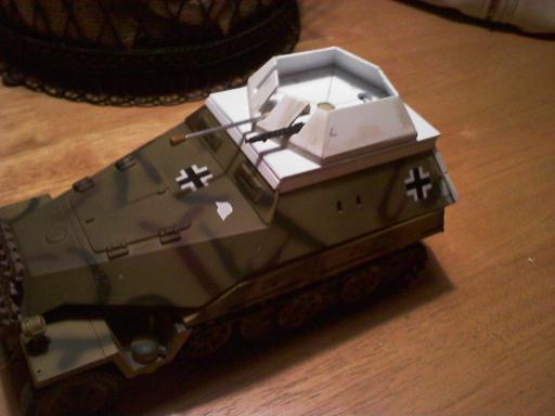

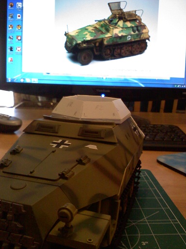

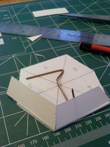

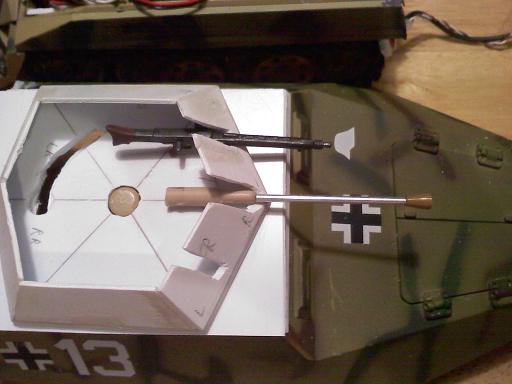

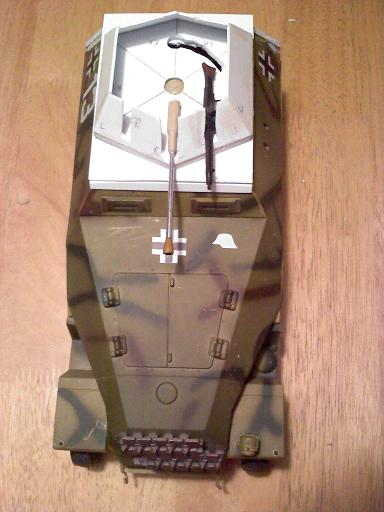

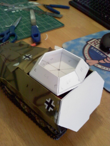

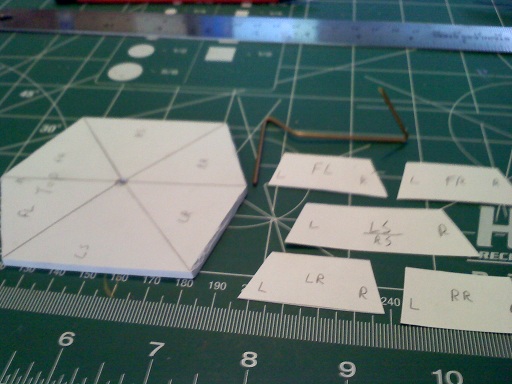

I haven't had too much time to work on the HT as of late. last night and today, I was able to cover some ground. I'm going to use a HL/WSN turret traverse, but instead of using the ring gear, I simply modified a Bandai road wheel plug/cap, cut a hole in the traverse gear, then mounted the cap directly to the final gear shaft. I will mount the turrect directly on to this plug in the center. I went this route for obvious space reasons. One of the pics shows what it will look like once mounted in the compartment directly on top of the DMD.
I also have been working on the turret itself and have cut some templates out of construction type paper and hope to cut out styrene pieces using these as stencils. I made a guide using some wire and angled it to 60 degrees in order to ensure I cut the templates to the proper (or consistent) angle for each piece.
I also replaced the rear plate from the .060 thick styrene to 1.18 stock. This reduces rear flex and gives it a more solid feel/construction.
I'm obviously taking some "artistic license" here since the scale and dimensions aren't correct since this started out as a 251. But... I hope it looks close enough when I'm done with it.
Here are some pics.

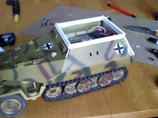

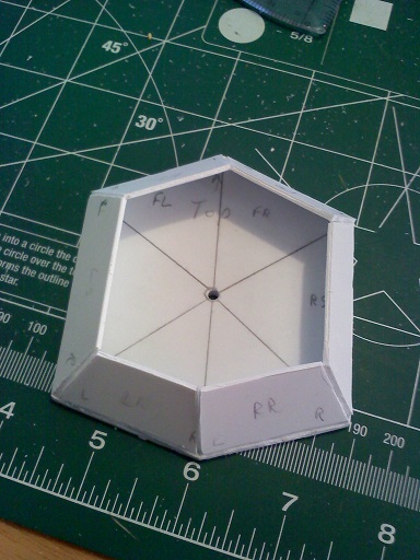

Using the paper templates, I traced then cut out the pieces using .060 styrene stock. I then CA's them to the turret base plate. It's a little rough at this point so filler will be needed along with some sanding etc. But it gives an idea of the overall size of the turret when setting on the body. Due to all the angles, I went with the 6 sided turret (which was more prevelant on the "neue' body anyhow since it was easier to manufacture) instead of the 8 or 10 sided version on eariler models.

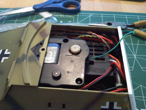

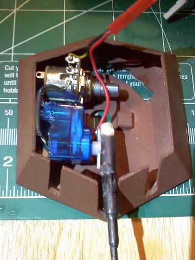

I was able to spend some time on the HT over the last couple of days. I accomplished quite a few things with still more to do.
1. Realizing that I needed more room (especially for the turret traverse mechanism), I begrudgingly decided to raise the ceiling of the HT enough to house all the components I needed. I didn't want to do this since it changes the look completely, but it was needed to make this work. I thought about following the 60 degree angle of the side plating, but this meant I had less top surface area for the turret and would have caused a major turret overhang problem on the sides. So I chose to just go vertical and live with it. To accomplish the lift, I used some evergreen .125 stock and basically built a frame around the top.
2. I also cut out the MG slot and sighting scope slots on the turret. I then made my first pass at a 18th scale 20mm cannon. It's not perfect, but I think it will work for now. The plan is to mount the emitter either under the MG, or, possibly under the 20mm cannon if I can get elevation to work. I don't have much room but am considering some sort of server type of elevation.
Here are some pics.

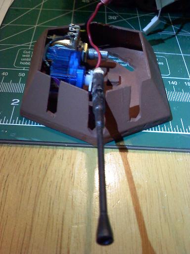

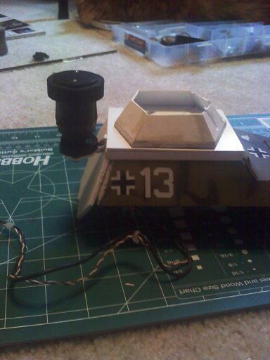

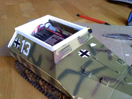

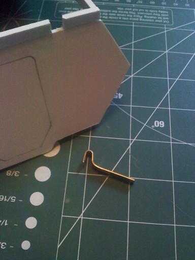

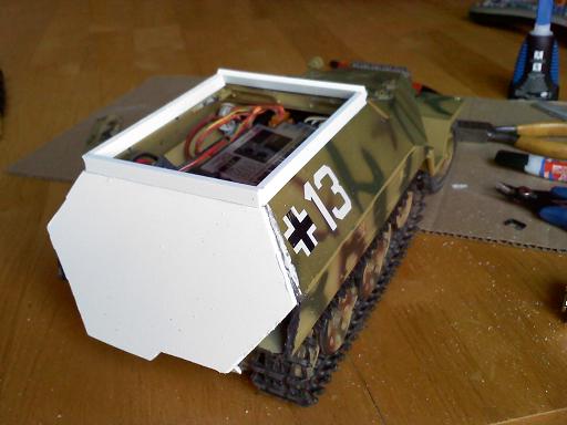

Thanks Rex. Coming from you, that means a lot. I've been admiring all of your scratch builds out here for a while now. You're the master at this scratch building stuff! I just took this on because I can't find a tank I really like! =)

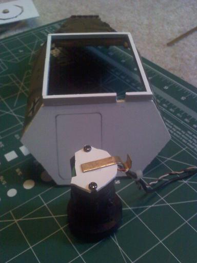

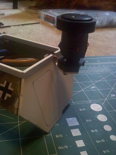

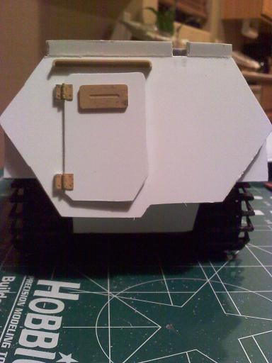

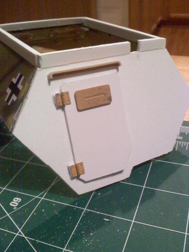

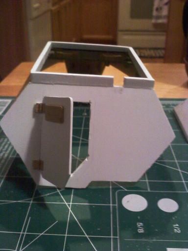

I was able to make more progress this weekend. Two of the main areas of focus were a mounting for the TBU, and doing some modeling/detailing of the rear.
Fashioning a small brass strip and bending it into shape, I mounted it to the bottom of the TBU. Then, I notched a small portion of the upper right side rear of the top of the HT. The brass "clip" allows the TBU to simply hang off the rear of the HT. I went this route due to space limitations in the turret plus I can clip it on and off quite easily.
I considered just mounting a fake rear access door, but I thought it would be cool to have a real working rear door. So I measured and cut out a door. I then cut out the thicker rear styrene for the door to go over. Using some hinges and other odds and ends I scavenged off my Bandai PzIV, mounted the door, view port, and rain guard over the door. I plan on mounting a Jerry can to the right of the door later.
Anyhow, here are some pics. More to come!

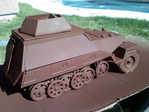

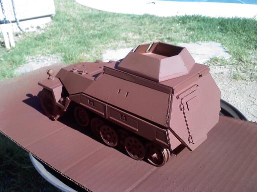

I put a coat of primer on in order to help me see where filler/sanding/attention is needed. I was also able to fabricate a simple (if not clunky) elevation system using a sub micro server (Hitec HS55 Feather) and a potentiometer (pot). The pot is larger than I need but it works for now. I may replace this with something smaller in the future but for proof of concept, works really well. I'm able to slow down the elevation speed quite nicely this way. I can also elevate the gun to 80 degrees (which the 250/9 could do for AA purposes) although I'm not sure who I'd be shooting at, at that angle! Maybe Craig (Streetsquid) setting on the bridge but since he's German, so much for that. =)
Anyhow, here a a few progress pics.

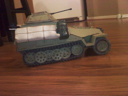

Old 04-19-2011 | 10:58 AM
  #69
CountChocula's Avatar
Joined: Oct 2006
Posts: 342
From: Glendale, AZ
Default RE: SdKfz 250/9 project
Getting closer!

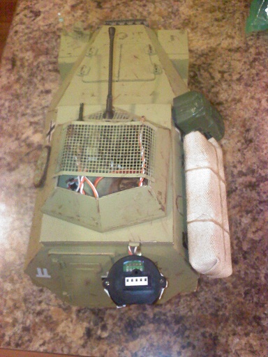

Old 11-10-2011 | 09:07 PM
  #73
Joined: Oct 2006
Posts: 342
From: Glendale, AZ

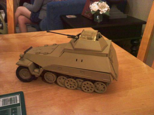

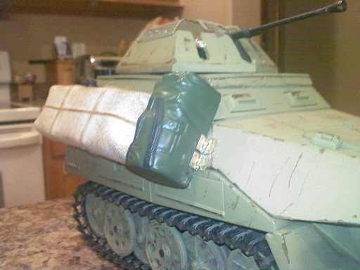

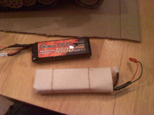

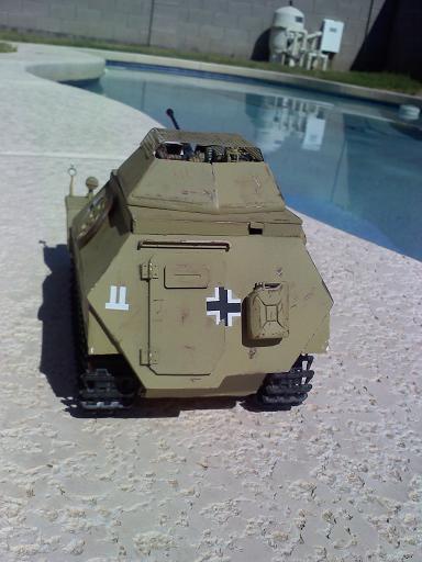

Well, after having battled the little 250, one thing became clear. The AAA battery solution wasn't going to work! At best, I could get in 2 or 3 battles before draining the batteries. At the last battleday we had here at DAK, Jeff Ousley once again encouraged me to try the LiPo route instead. I considered it in the past, but the batteries were still to large to fit inside the Half Track and that would mean getting a new charger, batteries, etc.
Jeff suggested putting them outside the HT which got me to thinking right away. So... here is what I came up with. It's a first pass and it's not finished yet as there is more painting, weathering, etc. to blend it in better still ahead. Basically, it involves covering the batteries in a canvas type of material, some small threaded string, and a plastic duffle bag off a New Toys Mellinium M113 APC that I cut and hinged to the side of the HT to hide the wires. The batteries are as big as I care to get given the small size of the HT but they're twice the capacity of the AAA solution I had.
Here are some pics.

Very unique solution, have you tried in a battle yet?

i just wonder if you go on a bit of a hill on the left side if it will tip over on its side looks like it would be too top heavy to the right side
