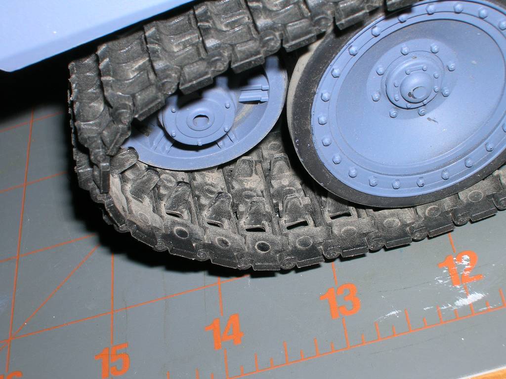

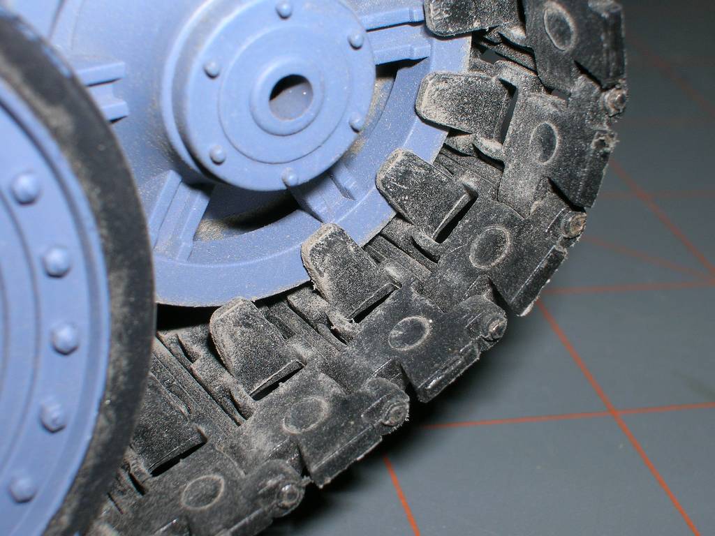

I have a problem with the tracks staying on the idler sprocket unless they are supposed to ride thet way. the first two pics are after running for twenty minutes, second two pics are the way I thought they should be. Any thoughts?
Thanks Guys
Harle

How many links do you have in your tracks?
My Panther G (same "running gear") came with 89 linkks.
After positing a question abbout it a few months ago, I go the reply recommending removing one link.
That solved the problem for me. I think the only thing to check if you do that is make sure it isn't too tight.

Thanks Glen,
I had 89 links also. I removed 1 link and ran about 20 minutes on grass and asphalt until the battery ran down. the battery was warm to the touch,but not hot. The tracks are still in line.
Thanks again
Harle

Are you throwing tracks all the time or just in soft dirt and/or snow? One of the drawbacks of HL tanks is the lack of a tensioner system. Many of us build our own or add aftermarket items. Removing a link or two is always a viable option. If the track is too tight with one link less and two loose with it in you can try trimming down the ilder a little to decrease its diameter. Do not trim too much so as to cause the teeth to bind or bottom out. Stiffer springs or clocking the first and last springs can tighten up the tracks. Tight track will settle down a little as the srings get increased use with run time. Many JPs are "bottomed-ouit" in the front already. It is very commong on the metal gearbox tanks. The lower hull floor should be parallel ot the ground.

Another problem you may have is that the idler is not inline with the road wheels. I had that problem with my Tiger 1. I put an additional washer in between the wheel and hull lined up like a charm and have not had a problem since. Did the same thing with my Jagdpanther. I was putting metal tracks on and checked the alignment added a washer and have not had a problem and it still has nice track sag. Just some thoughts .

I put a straight edge across the wheels all is in line. The tracks move outward on therear most idler, jumping one set of teeth. makes no difference weither it's on grass, sand, or asphalt. Every other wheel runs true except the rear idler.

Bob check out the pics on my first post, first 2 pics show the tracks off the idler after a fifteen minute run second two show before the run.

GSP exit 4.... If you join the TA Club or come to Danville I may get a chance to meet you. Did you reach out to the Texas club? As for your tank, I still suspect the idler wheel itself or an errant tooth on the tracks. Inspect the idler for wobble (tracks off and make sure the two halves arn't separating under stress. Spin them also and check for distortion. If nothing else works let me know and I'll loan you a good set try out. Also check the angle and make sure the ilders are screwed in true and straight.

Removed one link, now all is well with the world.
