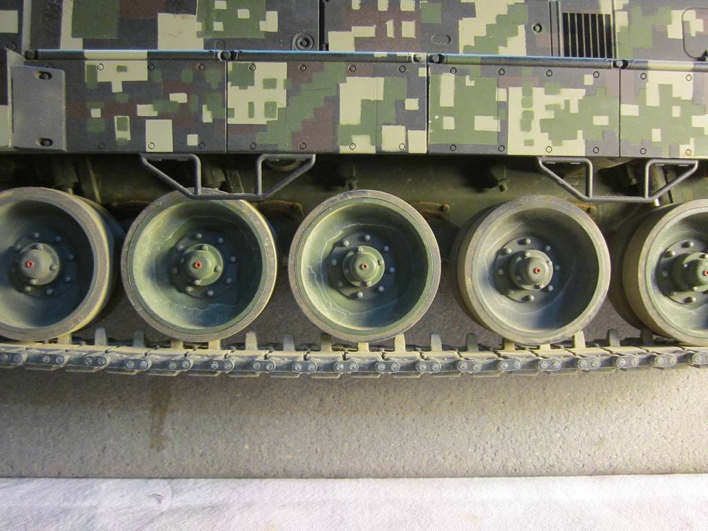

Posting pictures would help us to help you. Can you take a picture of the track droop when you support it so the tracks hang free?
My Leo tracks hang down just enough that the tops of the guide horns are still between the center road wheels, but just a little bit, say 1mm or so.

Here is my Leo supported so the tracks hang free. Compare yours to these pictures.
I'm not claiming my set up isthe best,but generaly the only track related problems I have are jamming the drive sprocket with sticks, rocks, and in the winter, ice. It has never thrown a track.

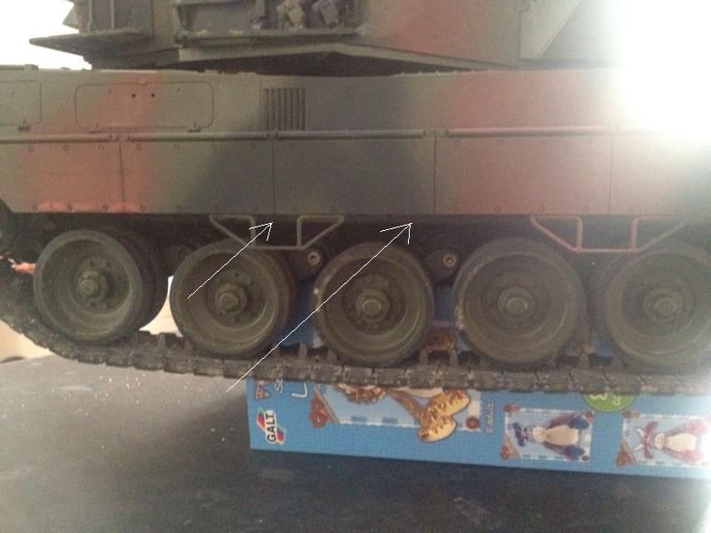

Hey guys! Here's some images of my tracks,
They look ok when the tanks no resting on its tracks but theres a lot of slack when its resting on them<br type="_moz" />

What is the line the arrows point to?

EDIT tell a lie its actually part of the hull

The return rollers should keep the upper part of the track supported above that level.
You should have 4 return rollers per side, 2 short and 2 long ones.
Do you have return rollers?
Myreturn rollersbroke off easy but lucky for me I found them in the grass and re-installed them with scratch built gussets.
Just read your edit...

I also noticed in the upper picture that your turret is not closed completly...  is that because it will not ?
