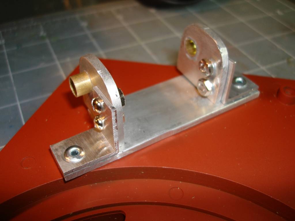

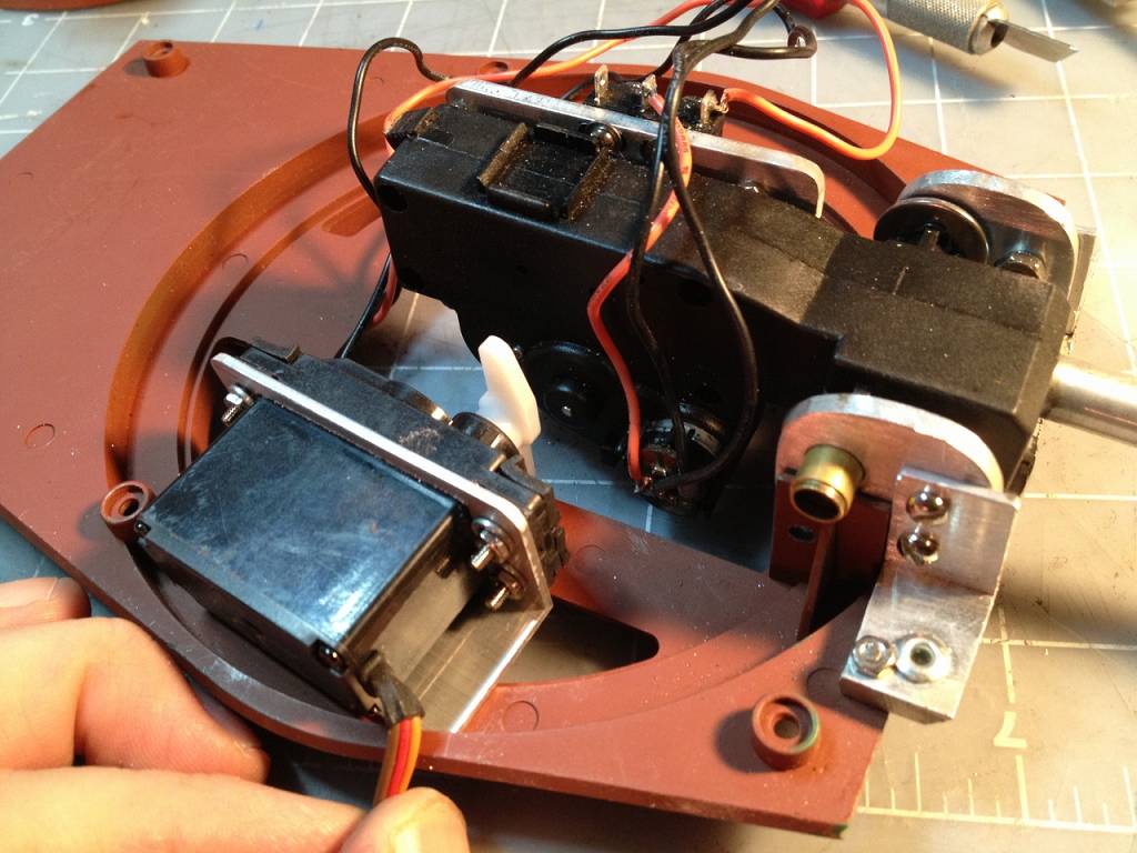

I will probably repost this on my King Tiger Build Thread - but I thought a lot of tankers using the DB2/3 system might be interested in this (if it hasn't already been done).
WHAT IT IS: It's pretty simple; by using my Spectrum TX I was able to MIX in ACC2 and slave it to the throttle. I removed the cam operated motor that controls the elevation and built a cannon barrel mount to the floor of the turret. With the barrel re-positioned, I added a servo that was connected back to ACC2.
For me, this has been the most hated part of the Heng Long system and hence the DB2/3 system. The cam operated elevation always upset me. Plus, I was able to extend the up and down position of the elevation for those pesky Shermans that hide up on the hill.
Here's some pictures:

Again, Here's some pictures......

More pictures of the installation:
Please see video for actual operation (I'll be adding another lower link from the servo to the elevation wheel to beef up the linkage)

I don't have a spring on my throttle for nuetral return. I downloaded the TBS software and will configure the recoil trigger this weekend. I did just have a nasty thought - (ughh), when I fire the cannon by the throttle stick, it will change the elevation of the gun. I need to fire the cannon by using a different button, operation.
Maybe this won't work...

A good morning walk/work out clears the head. First - I can't believe I missed it and second - how stupid was that?
Third - the fix.
I'll run the ACC2 on the RX to the "throttle in" for the DB3/TBS etc. On the TX, I'll modify the endpoints on a three way rocker switch where UP is Fire Cannon, MIDDLE is neutral, and DOWN is Machinge gun. When I flip switch up, cannon fires and down, machine gun fires. Ceneter position neutral.
I'll then run the THROTTLE on the RX straight to the servo that is connected to the gun elevation.
Do you see any problems with this setup and the DB3/TBS?
If it will work, it absolutely TRUMPS the Clarke board (for me) as the cam style elevation ruins the thrill of the shot. Perhaps, because I've been an active bird hunter in my youth and enjoy target practice to this day, I equate the proper aiming of a weapon with firing that weapon. The cam style elevation is like jumping on the Merry Go Round and waiting for it to go round and round and hope it ends up with where you want to shoot.
With this setup (full elevation control, proper recoil, programmable sound and with the optional amplifier to really get things rocking) and the price drop on the DB3, this would be the system of choice for me. It does require a programmable TX (which I like as I just switch which model I'm controlling - I have 20 model memory function including helicopters). It will also allow one complete unit that can easily be switched between models and reprogrammed quickly.

IT WORKS!
IT'S ALIVE!
I finally have my Spectrum programmed with Dan's BD3/TBS to provide full elevation control using the throttle stick and by using the three way toggle switch on my TX for "FLAPS".
The toggle switch allows nuetral (no sound), flip up once for machine gun and next notch for cannon fire.
With the inertia and awsome programmable Benedini TBS sounds with recoil slaved to the cannon fire through the TBS, this system is EXCELLENT.
