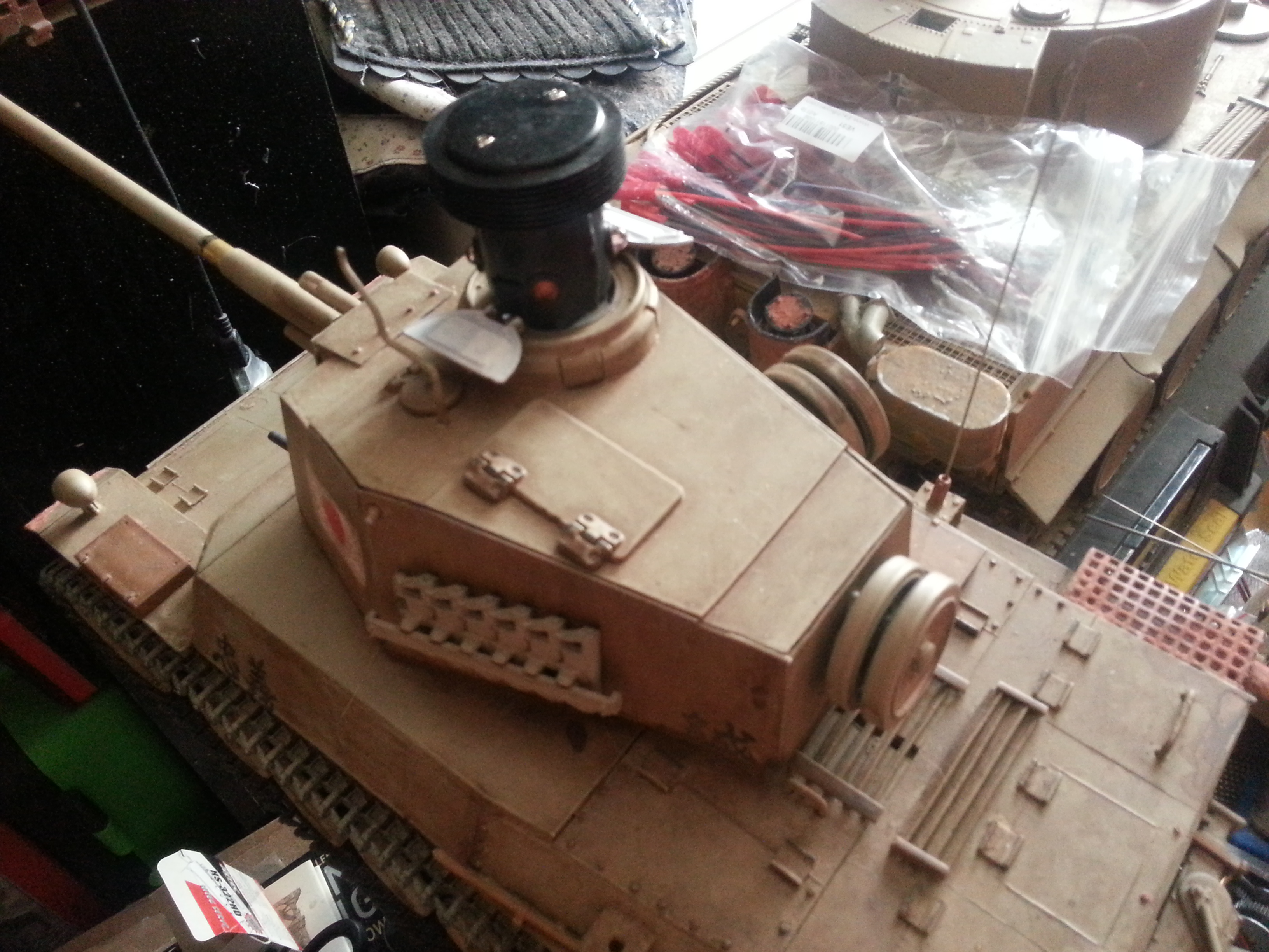

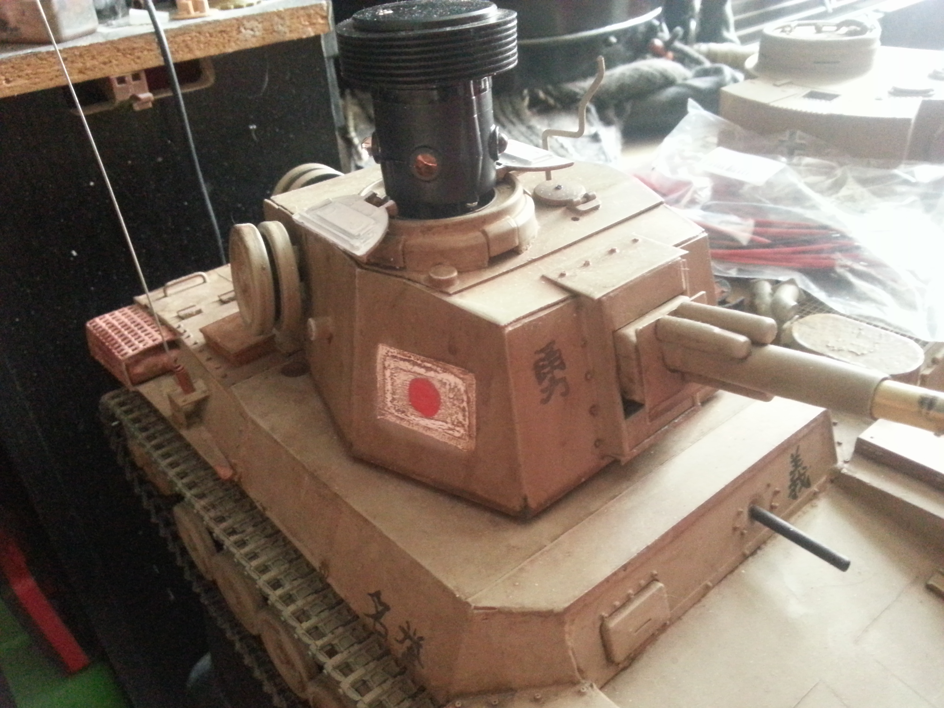

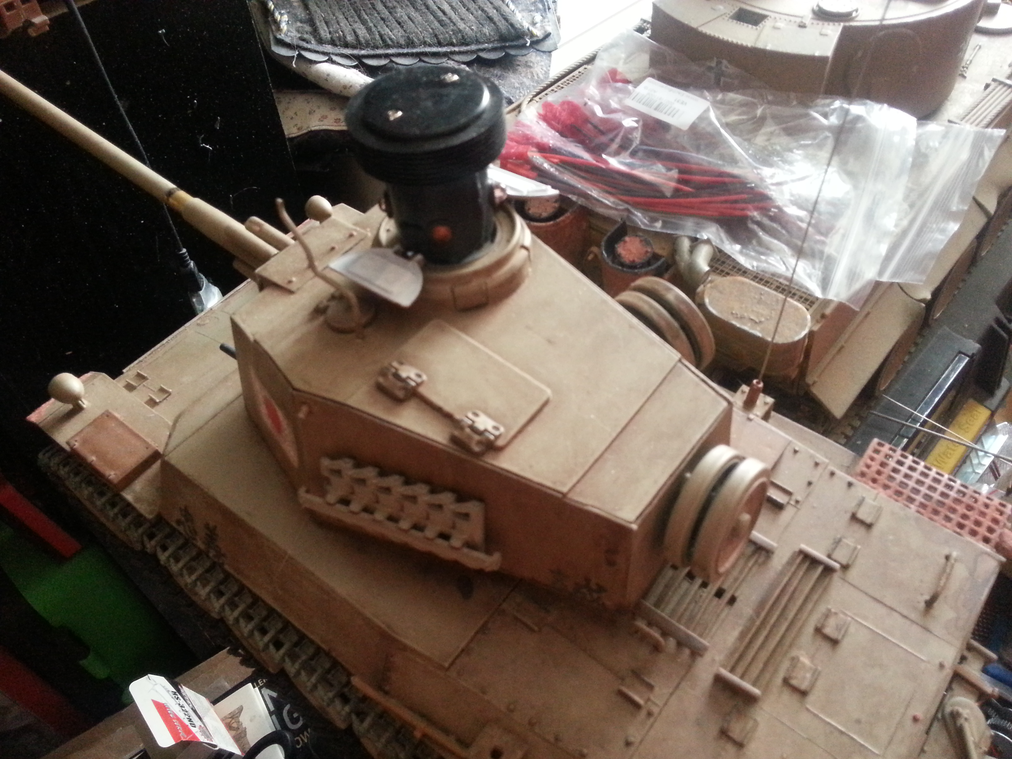

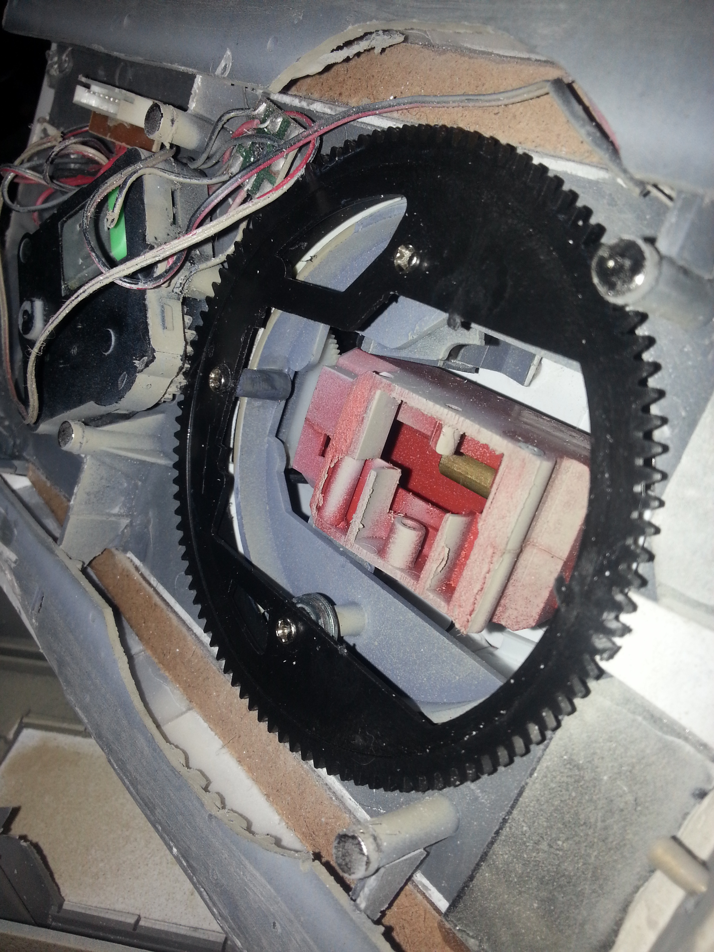

Dan, it's still being turned! Currently it lacks any electronics and while the elevation and recoil systems are present they have yet to be made functional & wired up. When I get a Clark board in this hull, then things really start to move.
I did some turret rotation work. As a result of raising the roof height I was having some binding and misalignment in the turret ring. As you can see I ended up using 3 washers to lower the ring gear so that it meshes properly. I also added a third turret ring mount at the rear... the stock Panzer III does not use this mount point but it was in the gear, so it wasn't very difficult to install.
It's not pictured in the photo but I also installed 5 sections of styene "c" channel around the inside of the hull turret opening. They both took care of the side-to-side motion of the turret and make the turret rotate MUCH more smoothly. I smeared on some white grease and the turret spins like a dream. I'll get pics up asap

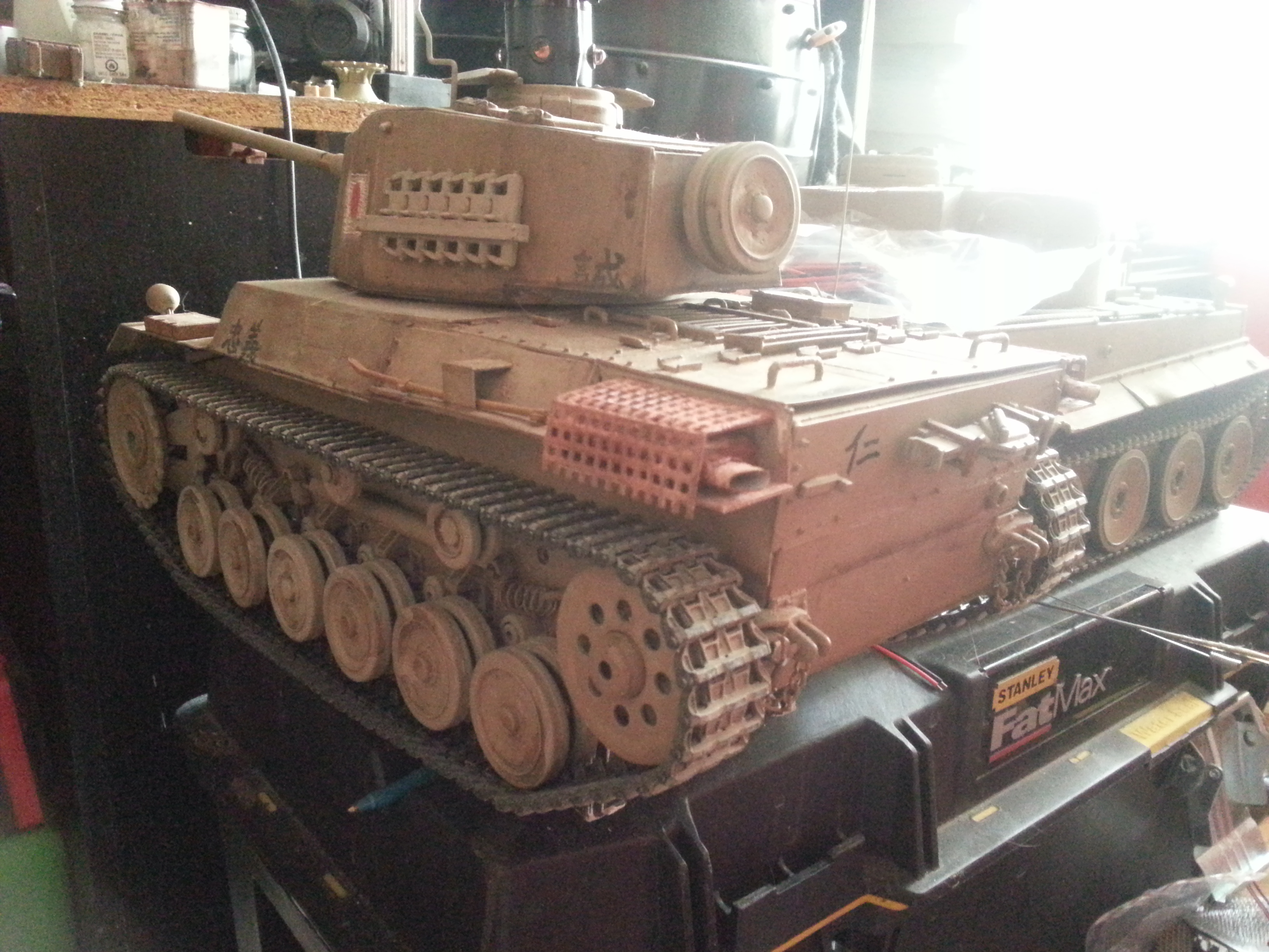

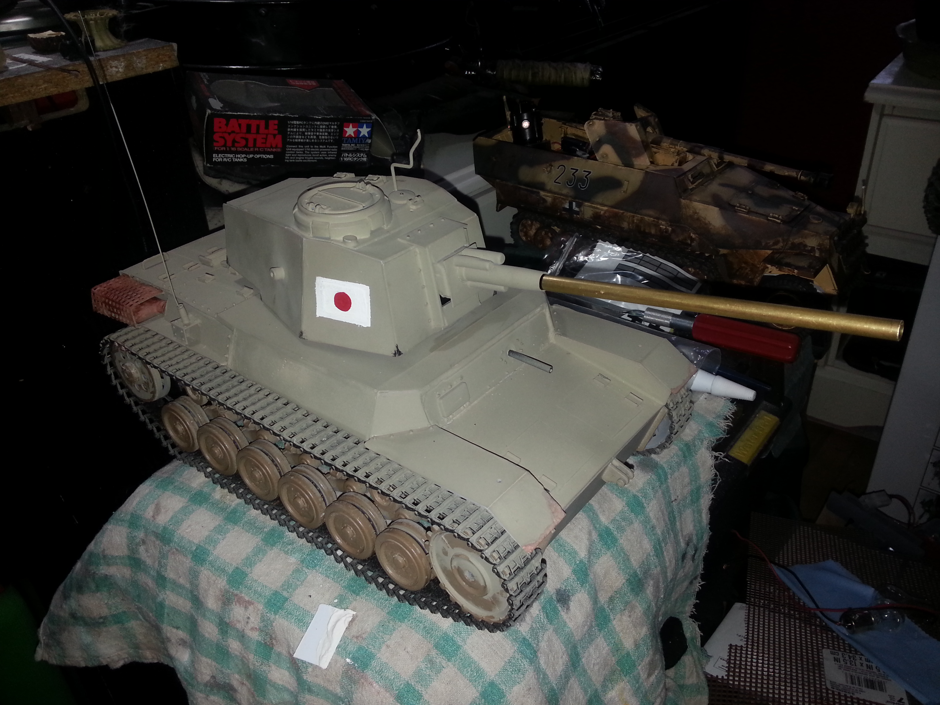

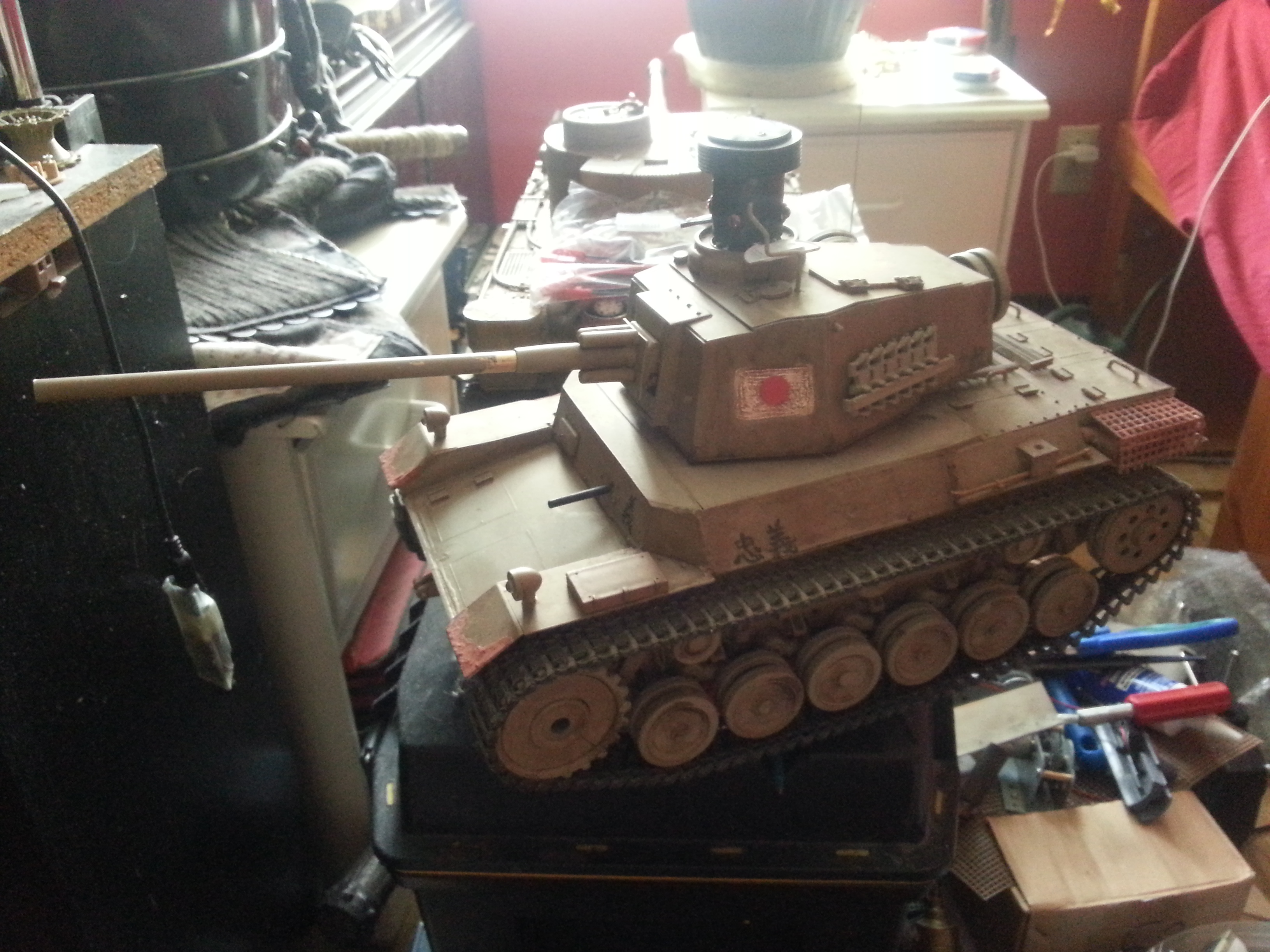

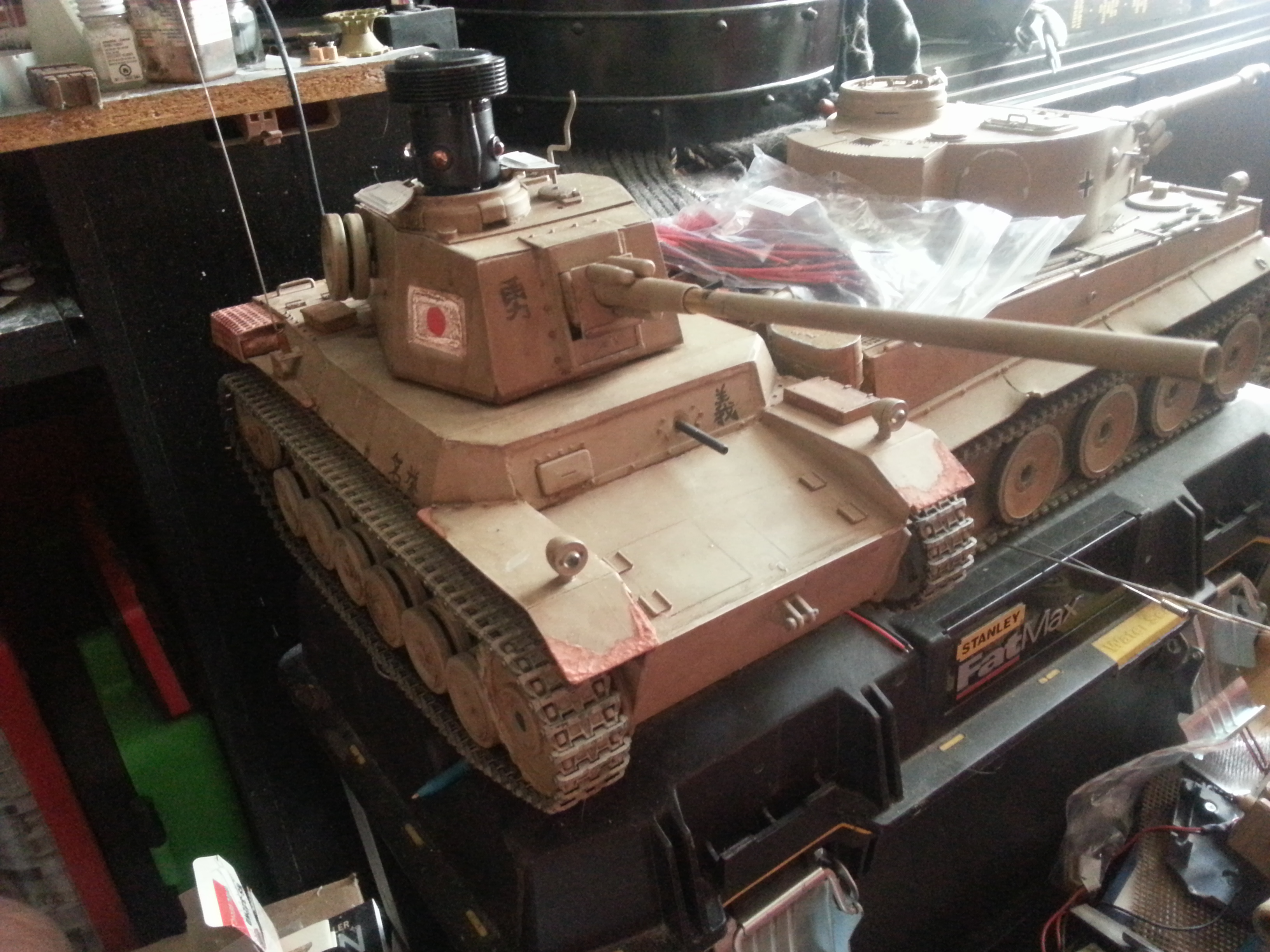

Well, it's done!! Im proud to say I've completed this build and my Chi Nu is 100% combat ready.
Latest updates include some rough weathering, installing the Clark battle systems for a Tamiya apple, some 'top secret' new IR emitters that I think could hit the space station, and full servo barrel recoil.
Full combat weight is 4.5 pounds. This tank runs like greased lightning and I have a hard time controlling it due to the speed...
Specs:
  • Clark Stug TK-22
  • Taigen 'standard' HL ratio steel gearboxes with ball bearings
  • Stock HL speaker
  • 5200 mAh NiMh battery
The only hiccup was a minor programming glitch on my original Panzer III TK-22 that was quickly taken care of my Curtis @ immortal hobbies. The Stug TK-22 installed now has a meaner sounding gun anyway and I rather like it.
