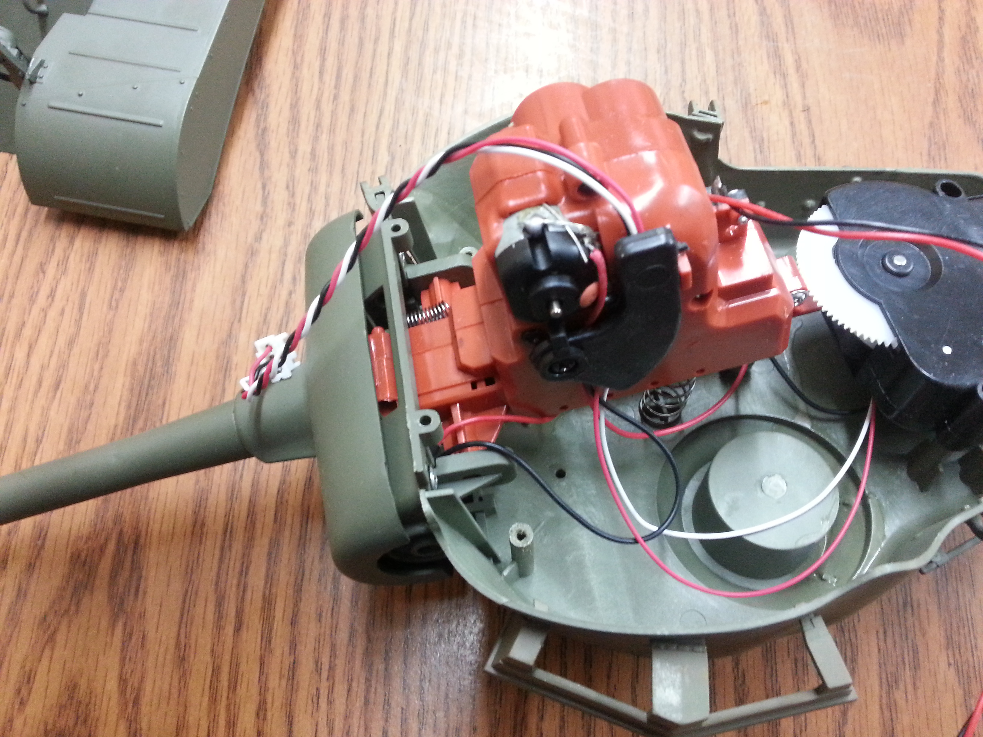

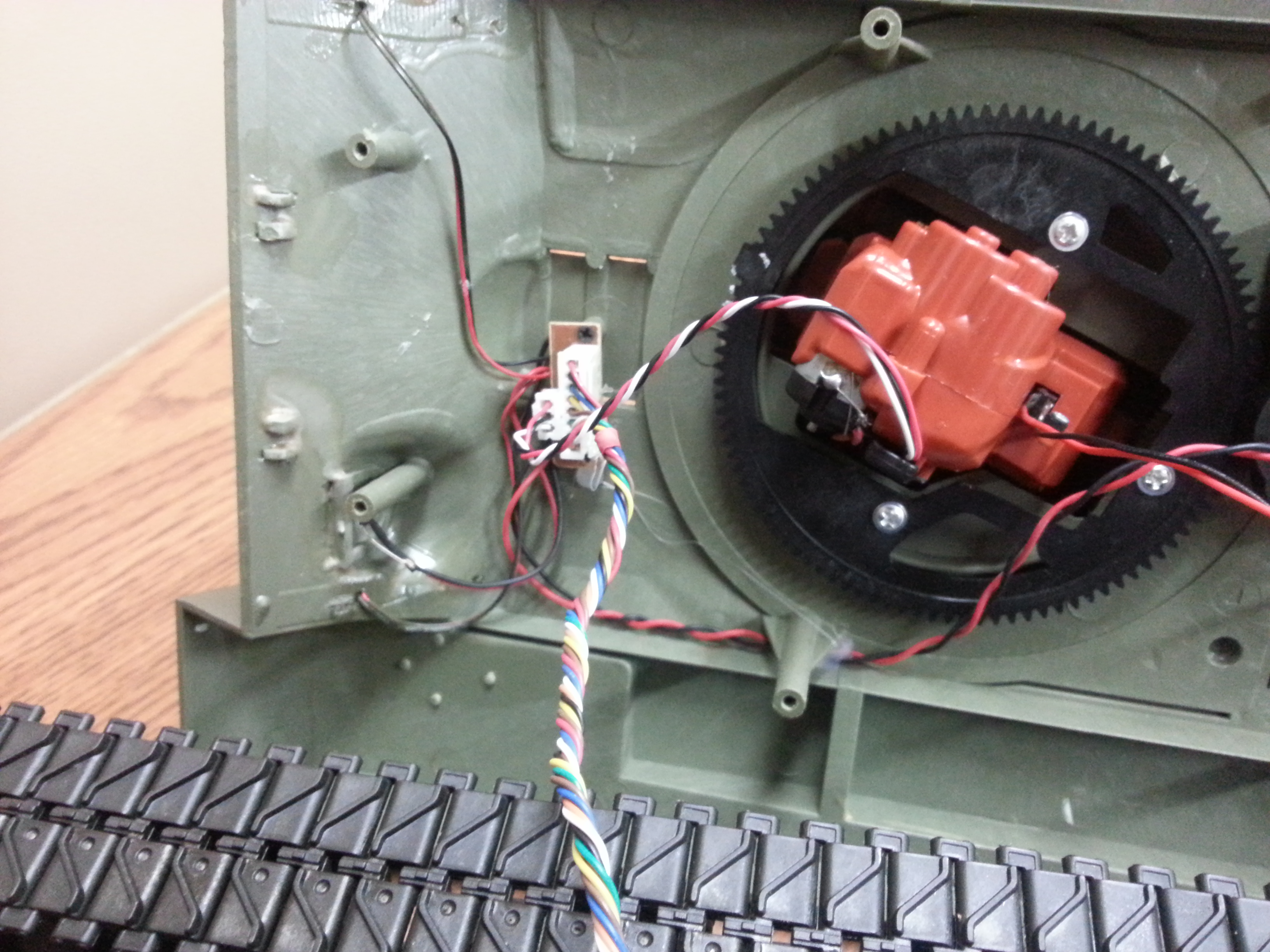

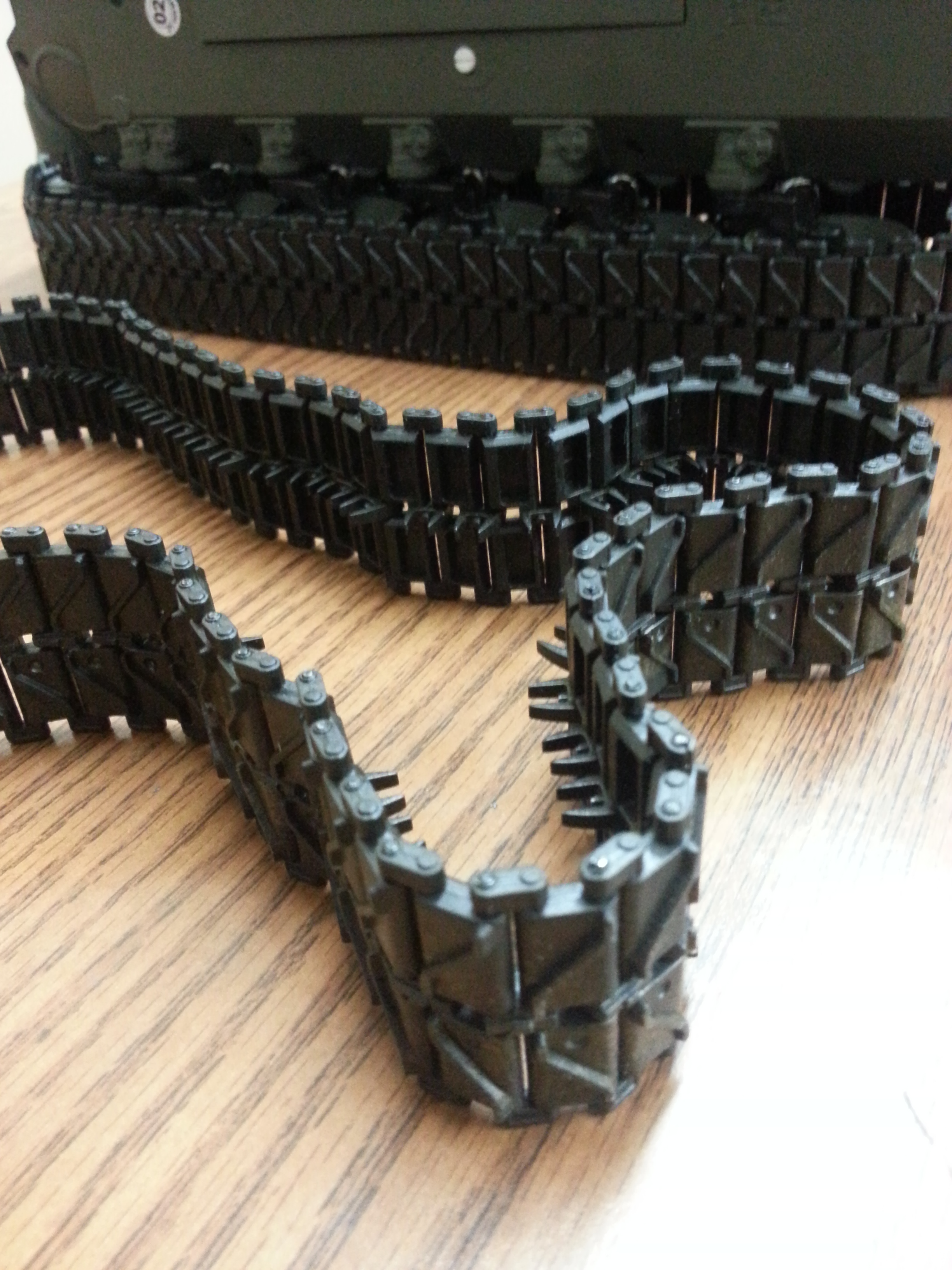

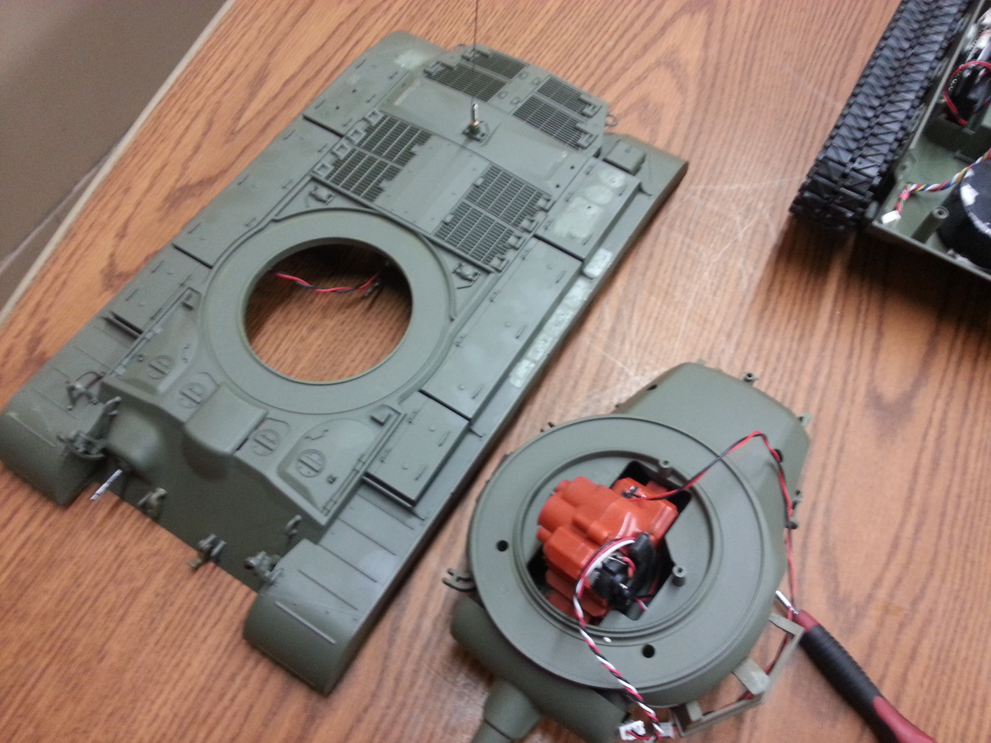

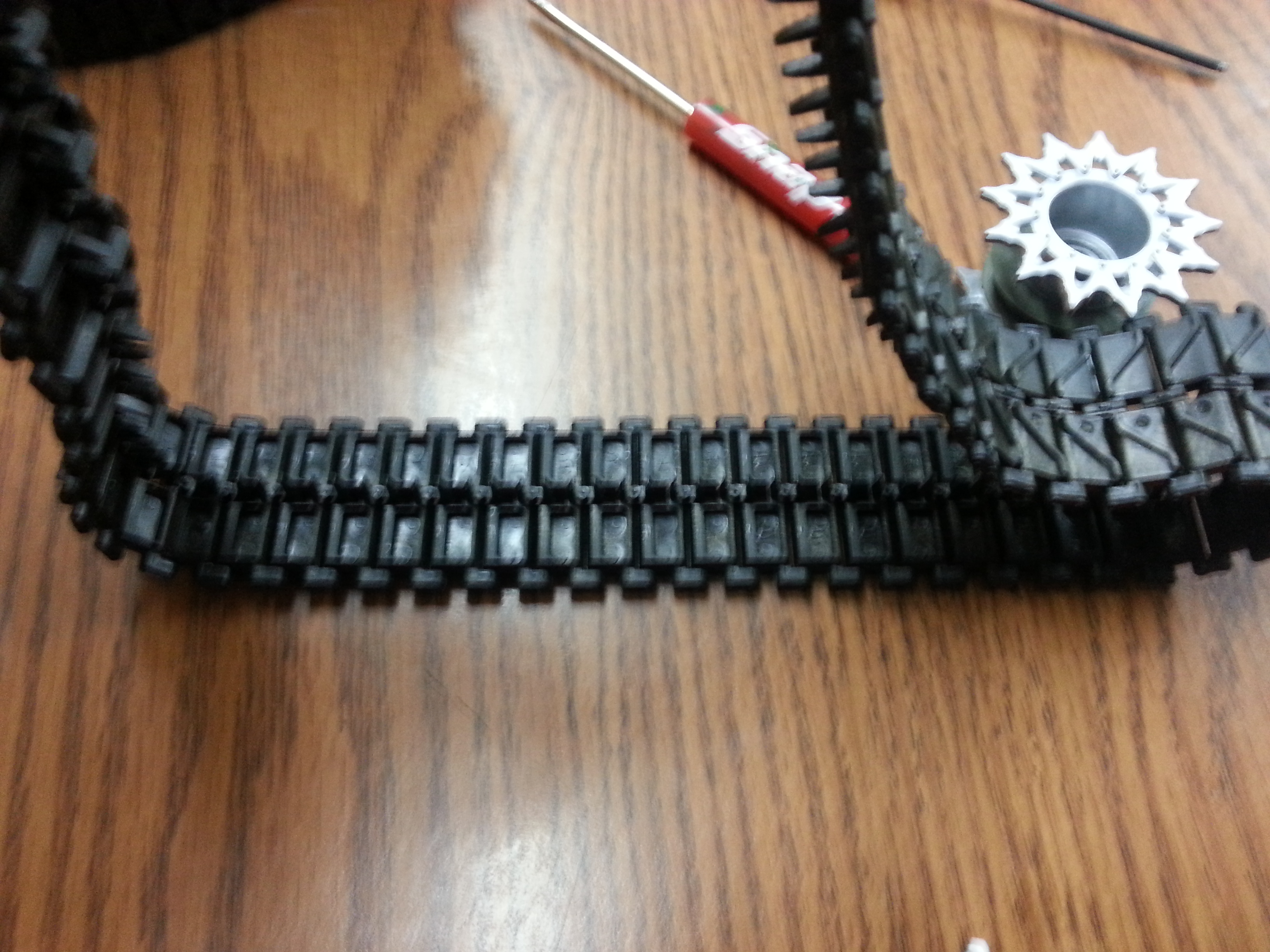

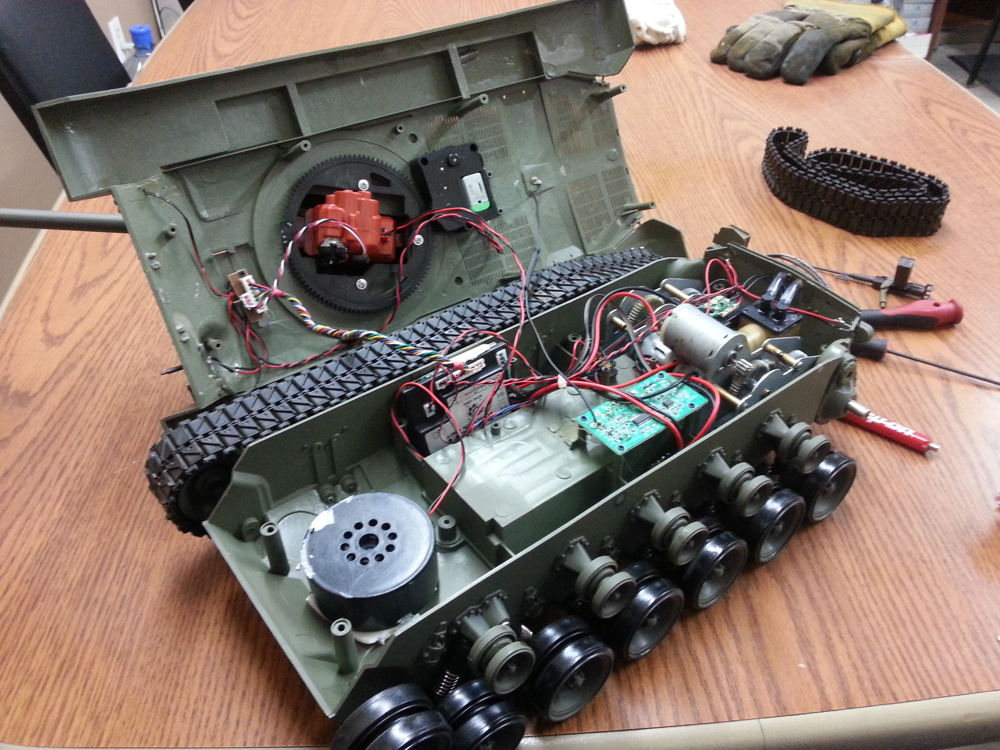

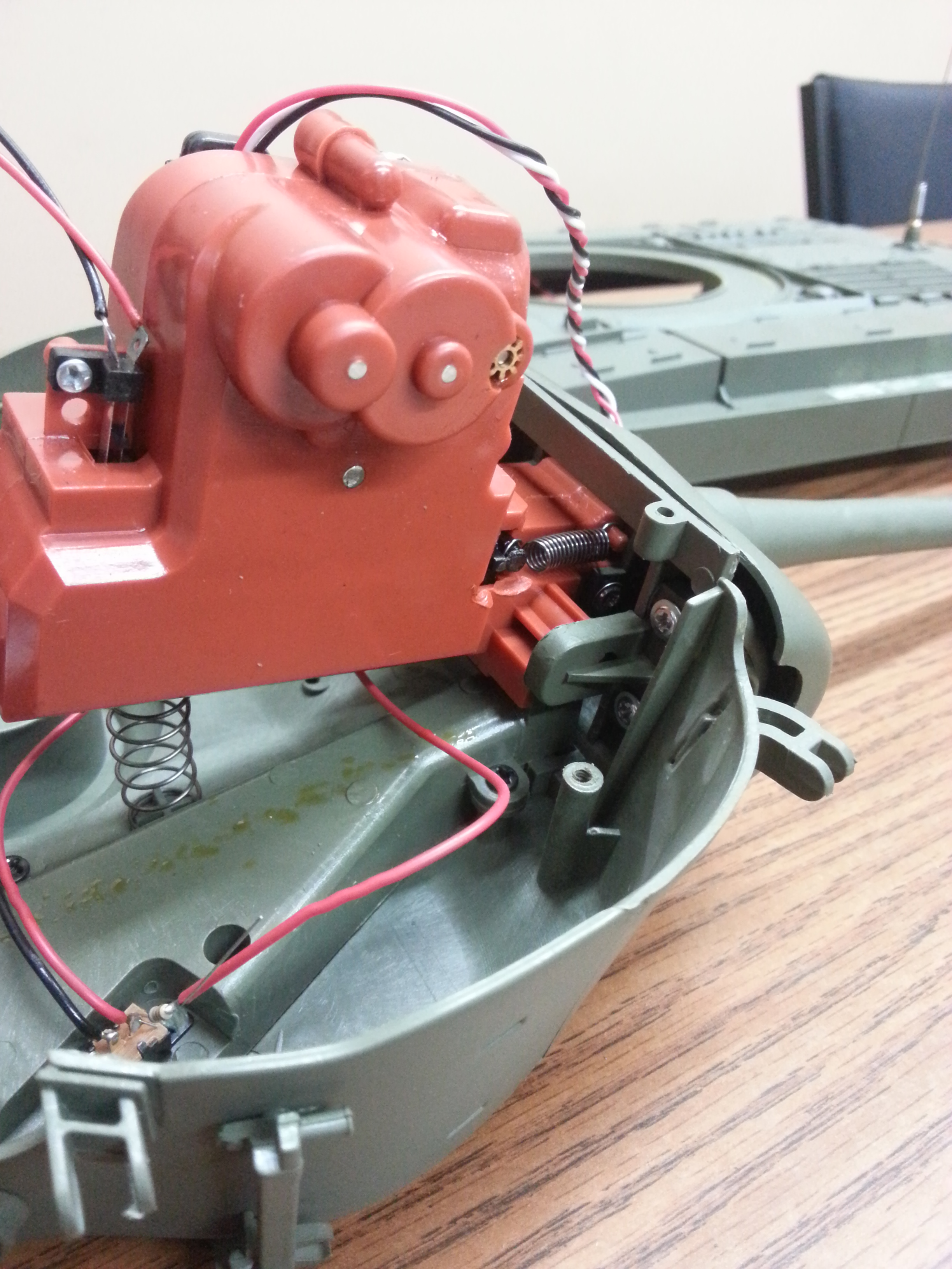

Wow so RCU deleted everything I typed but posted the pictures... anyhow...
My Pershing arrived after being in the mail for one day. Intnova is a good eBay retailer for us in Canada and especially Ontario.
So it seems I have a mix of new version Pershing parts and originals. The tracks, electronics and the MANY parts sprues I got are all new. Seems I have the old solid-hub wheels, lame. They included a bunch of the new plastic removable hubs and I have nowhere to put them.
Can anyone tell me whether the turret internals are the newer or order types? Can't really tell without much to compare it too.
Cheers

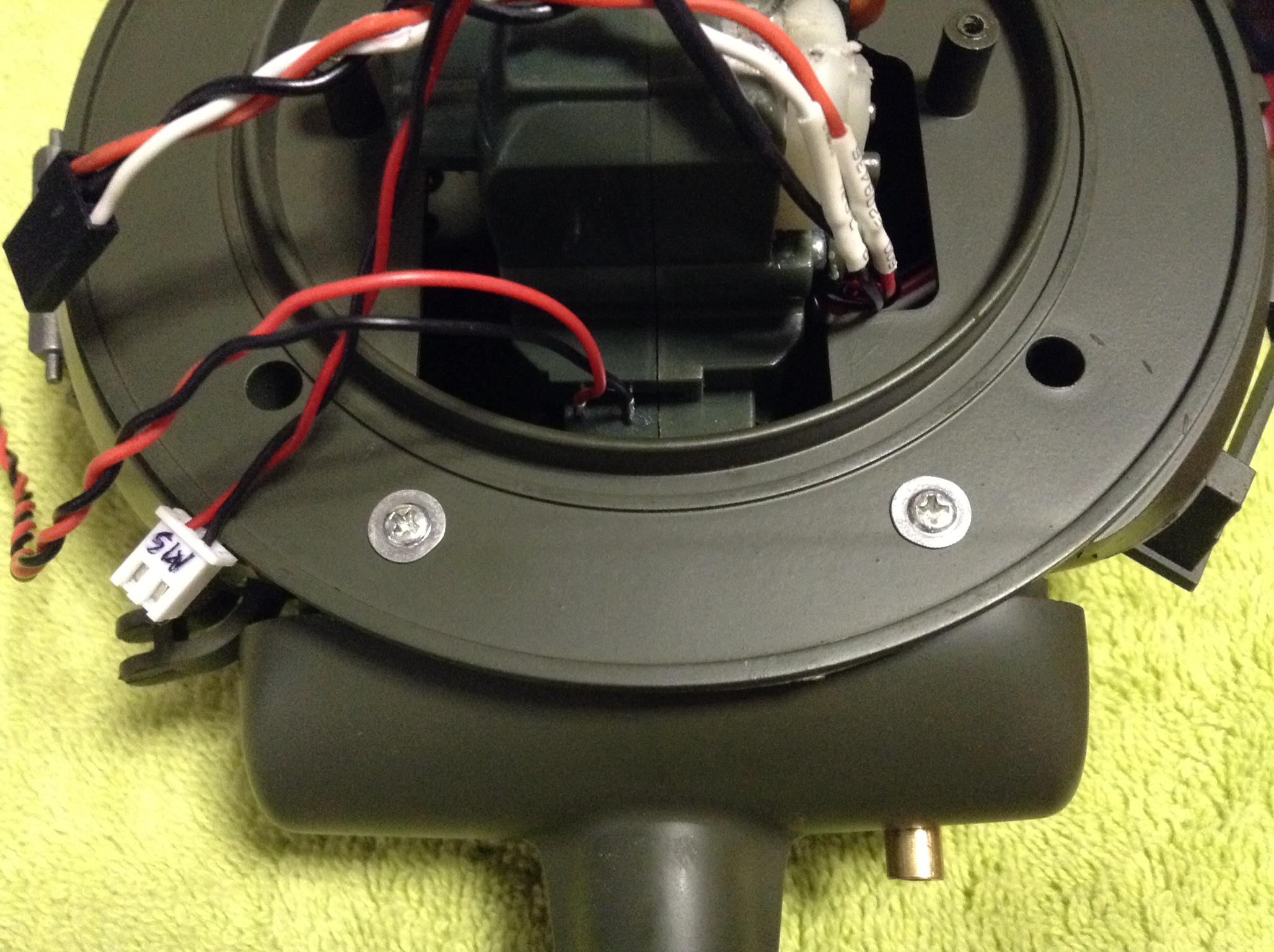

Looks to be the newer as there aren't two screws holding the mantel through the lower turret shell, yours uses the moulded dowels ...but now I'm having second thought's about what the 2014 really covered in the revision. Minimal I'd think 2.4 system. These will be interesting 100's of years from now when someone is trying to restore one to original or get one appraised ...I could see the expert on the "Antique Road Show" try explaining the history and just hit it with a hammer and say "whoops, it's worth nothing".

I think your pershing is the old version because I saw a 2p cable on the bb unit. This does not exist on the new version. The new version only has a 8p cable connecting the turret/upper hull with RX-18. The traditional 2p cable for bb unit is removed. The new version's road wheels should not have caps on them when you take it out of box and you need to put on the caps by yourself. So I think you received a old version tank but with some small parts for the new version. I have both the old and new version pershing tanks. The new version is easier to work with.

Haha, yes this is interesting to say the least Haw-Haw :P I think everyone is correct here.. I have a mix of old and new parts for this tank. I'm glad I have what seems to be the new turret, as mine does not what is pictured in your photo at all, and that seems to be one of the major weaknesses.
A little miffed that I didn't get new roadwheels but it won't matter, ordered a set of the new metal wheels w/ bearings from TankArmy and they hopefully will be nice.
