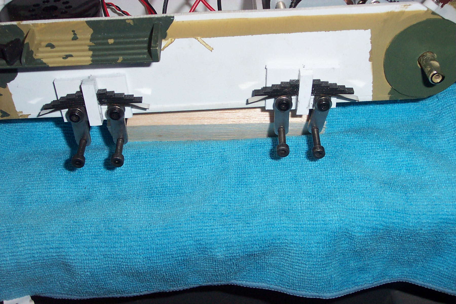

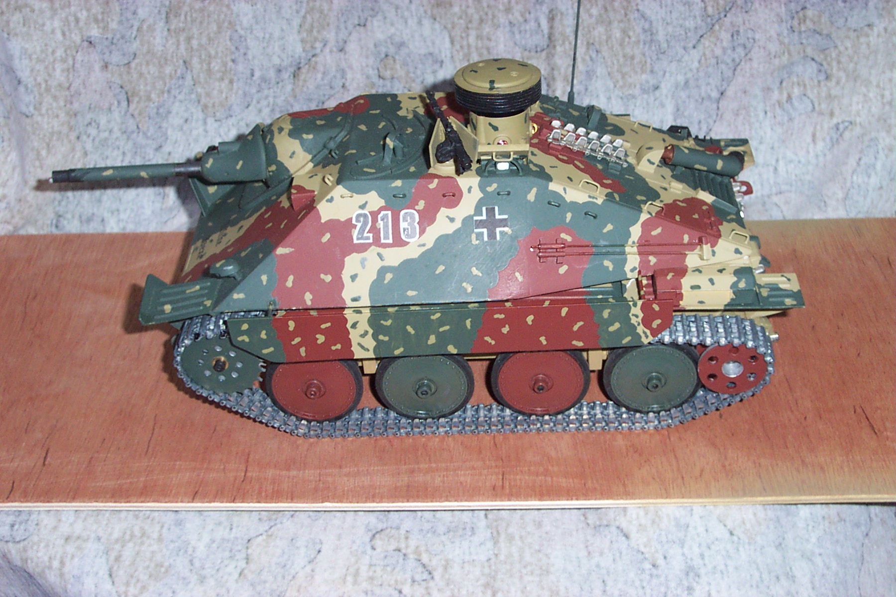

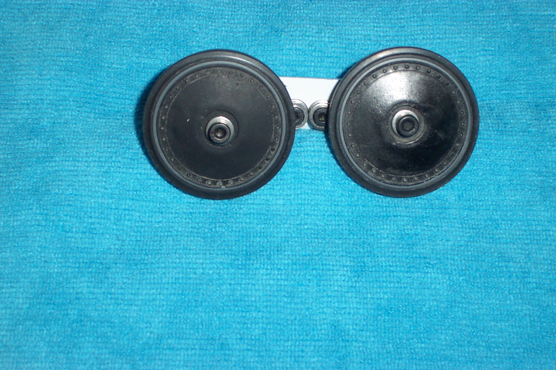

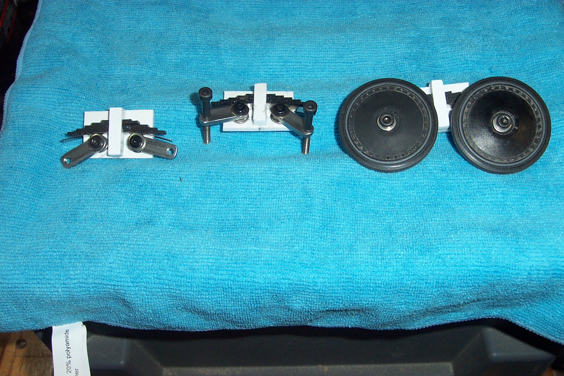

I have not heard from the machinist yet, and probably wont until next week sometime. For some reason all of the machine shops in this area are extremely busy right now, or is it just me? Well anyway, I have been keeping busy with the suspension and road wheels. I have all of the spring hangers and springs put together using the ones from 35RCTank. They work great for this application. I have put bearings in all of the Tiger 1 wheels, made hubcaps so that they look like the Hetzer wheels, and I am in the process of making the attachment points for the pairs. I have run into one snag however. I am short on four (4) screws. I thought I had them, but I can't find them and they were not with the others. They must have gone UA! So, I am in need of purchasing some of the axle screws from a StuG III or PZ III. If anyone has some they are willing to sell, PM me please. These are the Allen head screws with a shoulder that attach the axles to the tank hull in the first picture.
Thanks, Herman

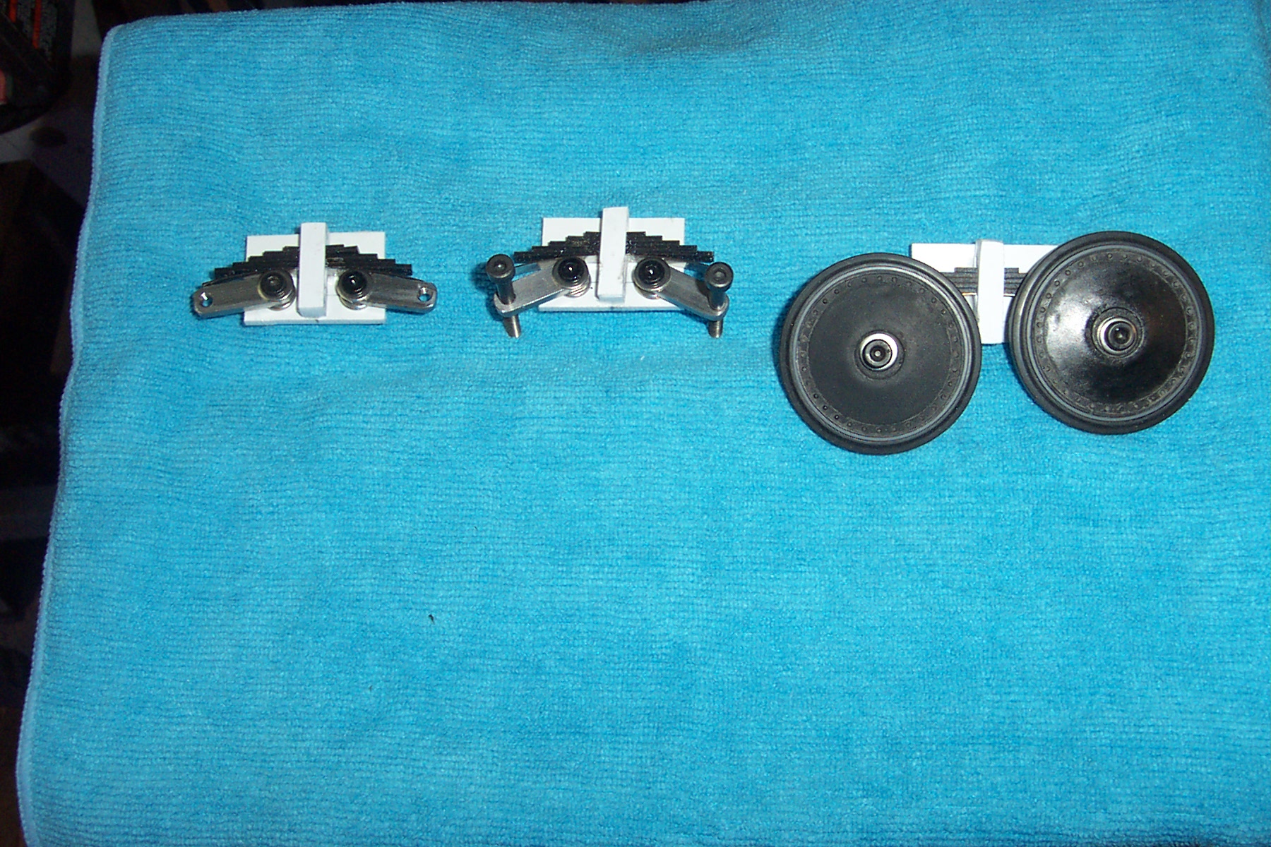

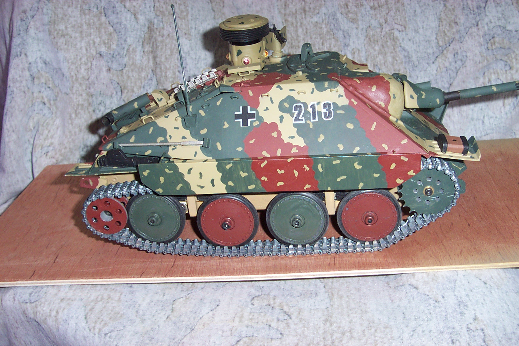

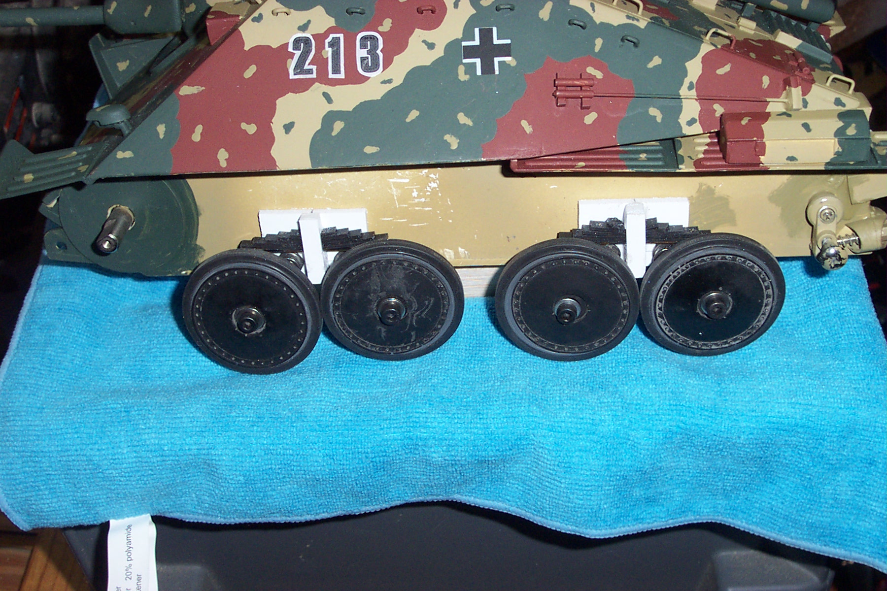

We have a rolling chassis now! Still no sprockets or idlers, but we have road wheels and springs that work.
I have not mounted them permanently yet since I am still a little unsure of the spacing out from the hull. I can still adjust for that once I get some workable sprockets.

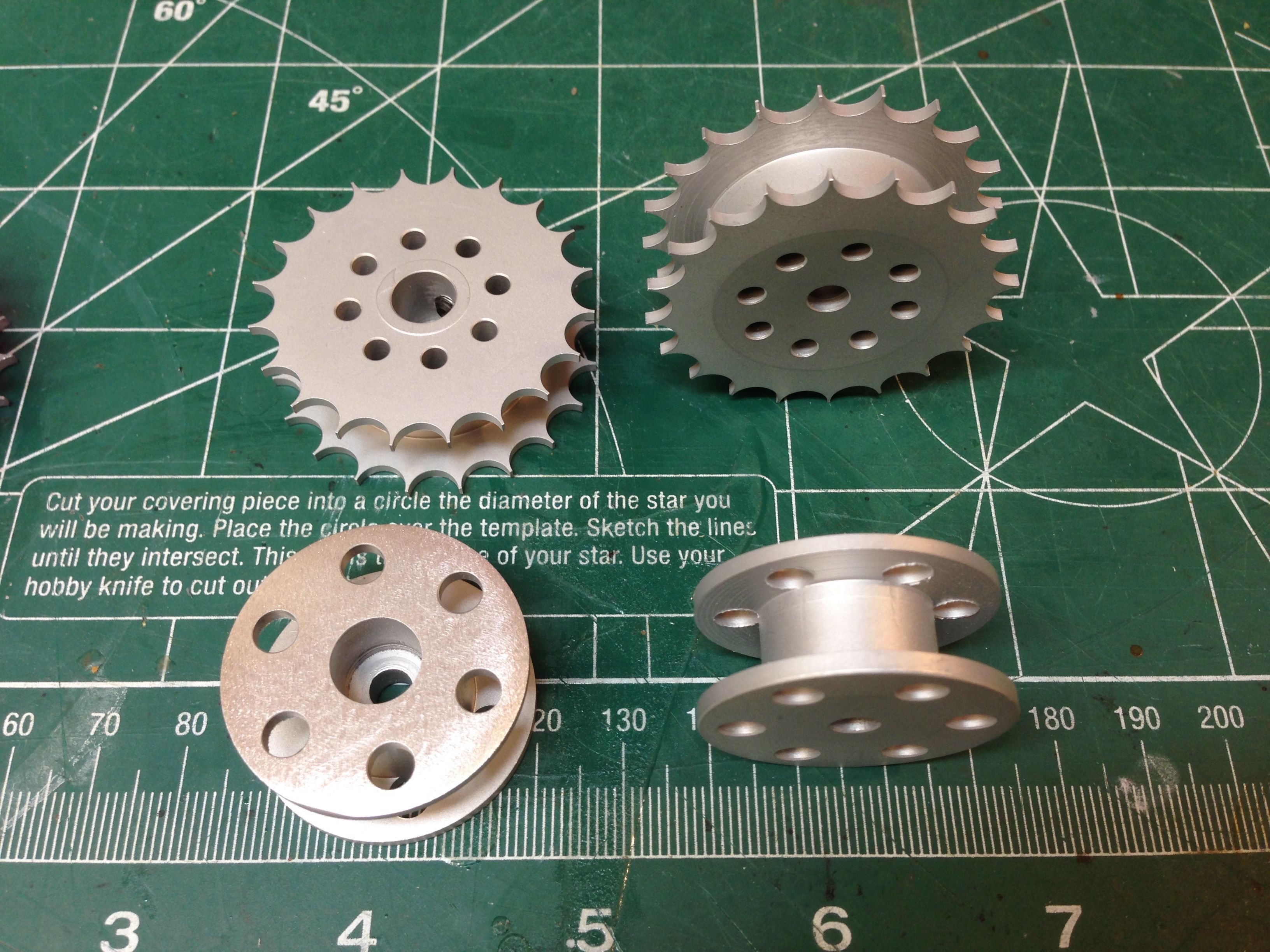

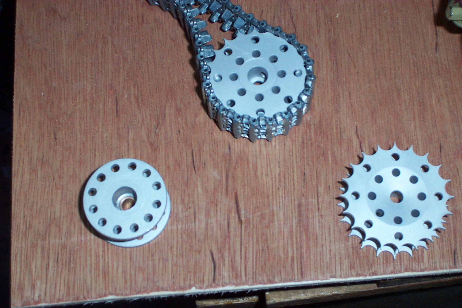

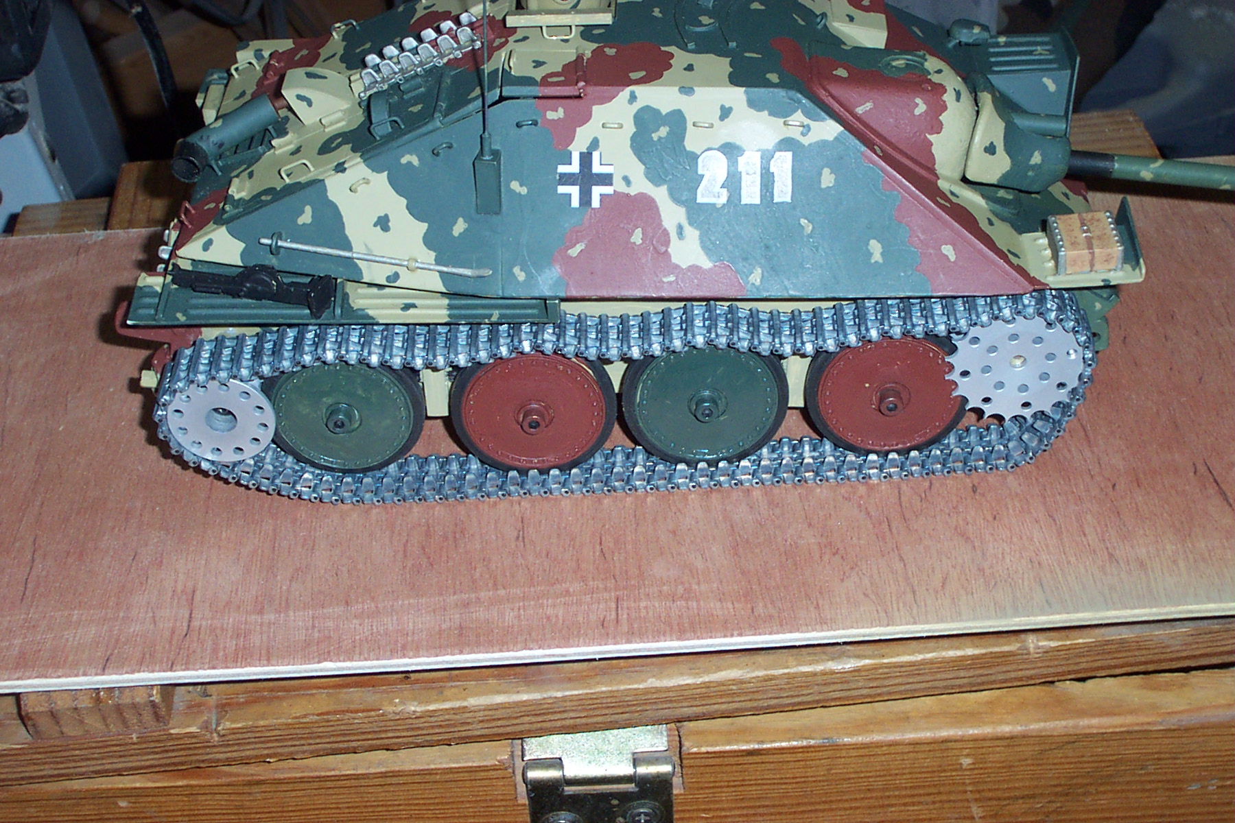

Well I am finally home after two weeks of biting my nails wanting to get back to work on these with the new sprockets and idlers. They are all of what the first set should have been and more. The tracks fit on them great and run without hang ups. Cost is a bit more, $60.00 for a pair of sprockets and $40.00 for the idlers, but the workmanship is worth it. I still have to adjust the track length, wheel alignment, and install the return rollers. With all of that said, what do you think of them?

Looks like a good mesh. The teeth on the sprocket seem deadly sharp, very nice.
Are the sprockets held on with a set screw, or will they bolt on like most other sprockets?

The set screw is to fit them on the flat of the axle to keep them from rotating. They are held on with a screw into the end of the axle as normally done. I am really liking these.

They look way better then the other shops try!!! Are they steel or aluminum?
Old 09-16-2014 | 12:35 PM
  #63
Green Amphibian's Avatar
Joined: Jan 2009
Posts: 1,567
From: King, NC
They are aluminum.

Good news everyone. I have ordered enough sprockets and idlers to have overcome the set up costs. This means a reduction in price for the sprockets and idlers and a new late war pattern to go along with the early war one. Sprockets are now available for $35.00 a pair and idlers at $30.00 a pair. Here is a comparison picture of both types. Early is on the top, late war on the bottom.

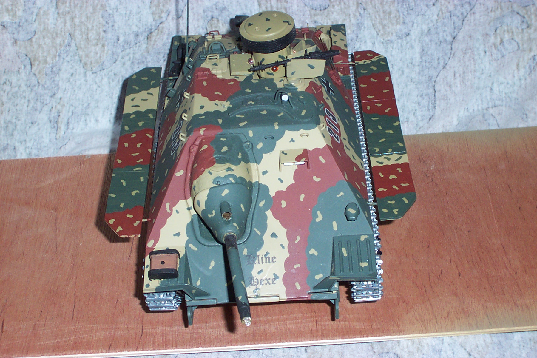

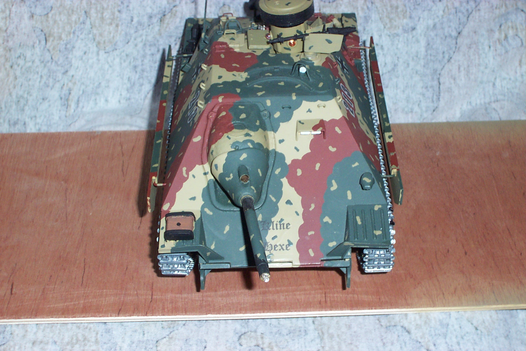

I have done a little more to one of the Hetzers. I added the shurzen to it. I did not do the three separate panels on each side because this is a battle tank. I did one panel with scribe lines to show the three. It is attached in two places and folds up to service the tracks and to take the upper hull off.
