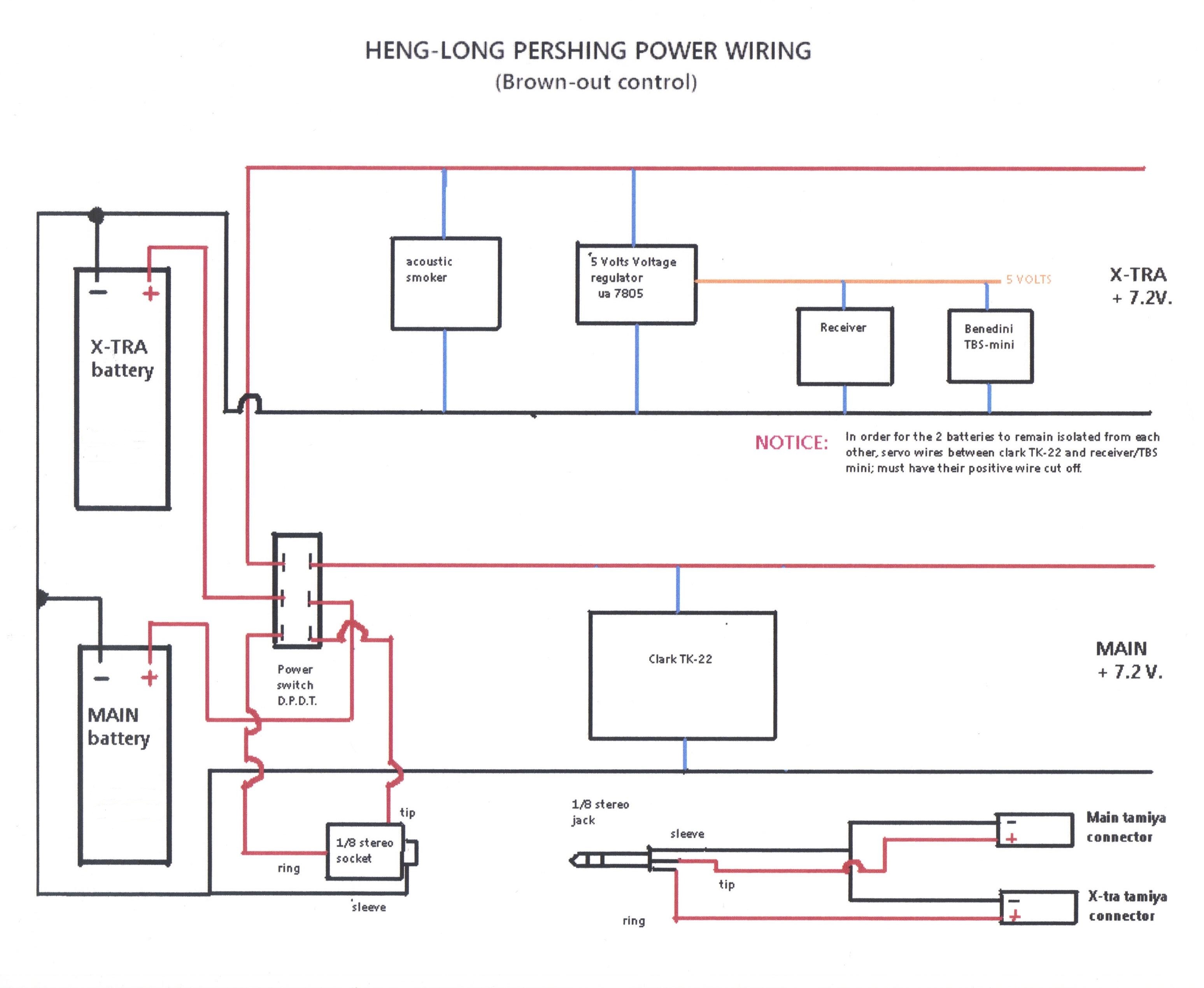

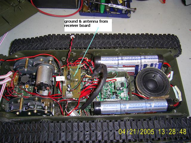

If you have room in your tank, I would suggest to add weight by using an extra battery instead of using "dead" weight...
Old 07-10-2014 | 05:22 AM
Imex-Erik's Avatar
Joined: Mar 2013
Posts: 3,216
Received 37 Likes on 33 Posts
From: Brooksville , FL
10000mAh lol that is funny. Planning on driving to work with that? I bet it drives for at least 4 hours.
Old 07-10-2014 | 06:03 AM
Joined: Sep 2009
Posts: 520
From: Elliot Lake ON, CANADA
Actually, the batteries are not connected in parallel; but they do power different loads...I do get a solid 2 hours drive from my tank anyhow...
Here's the wiring diagram I'm using...

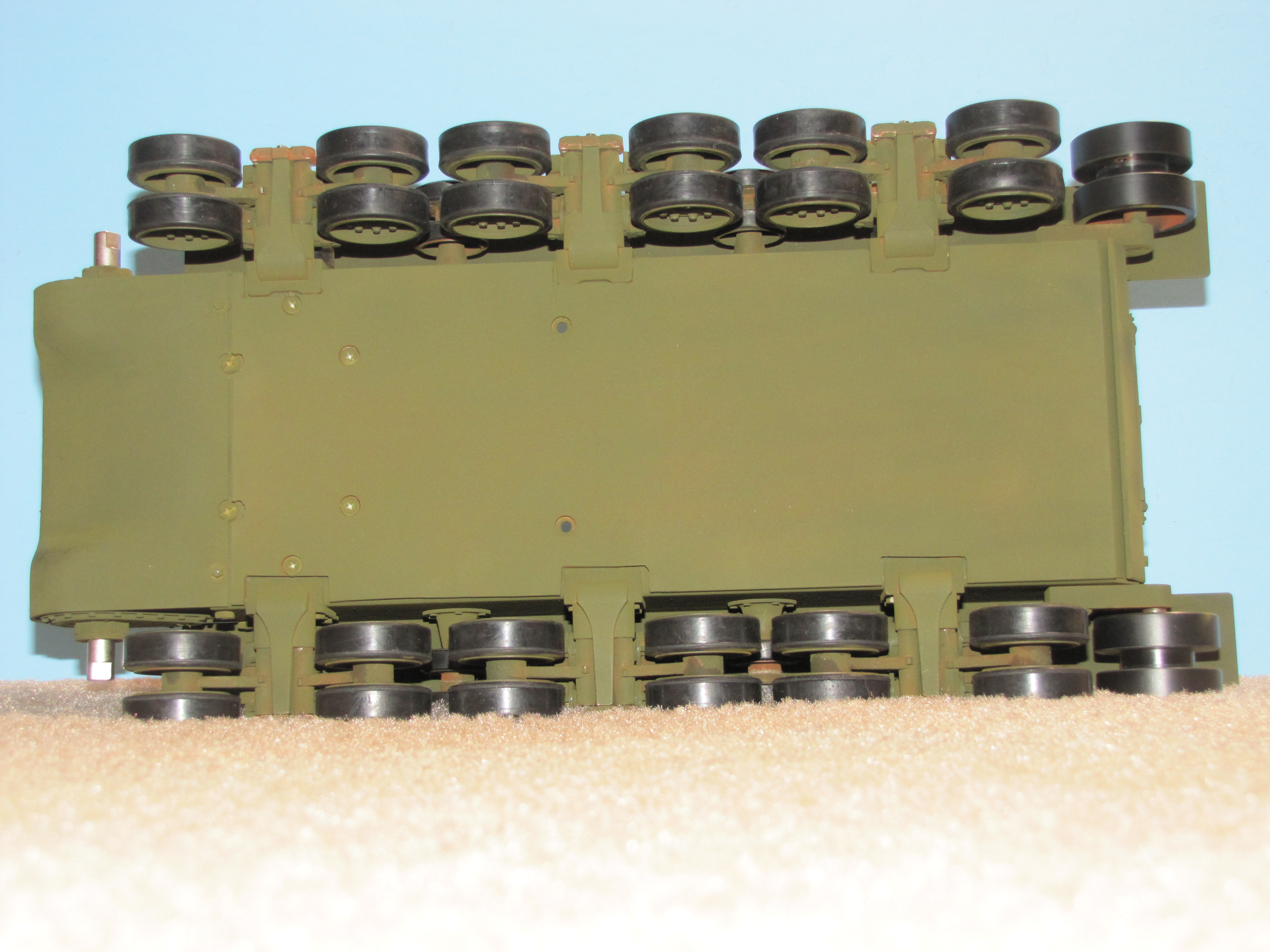

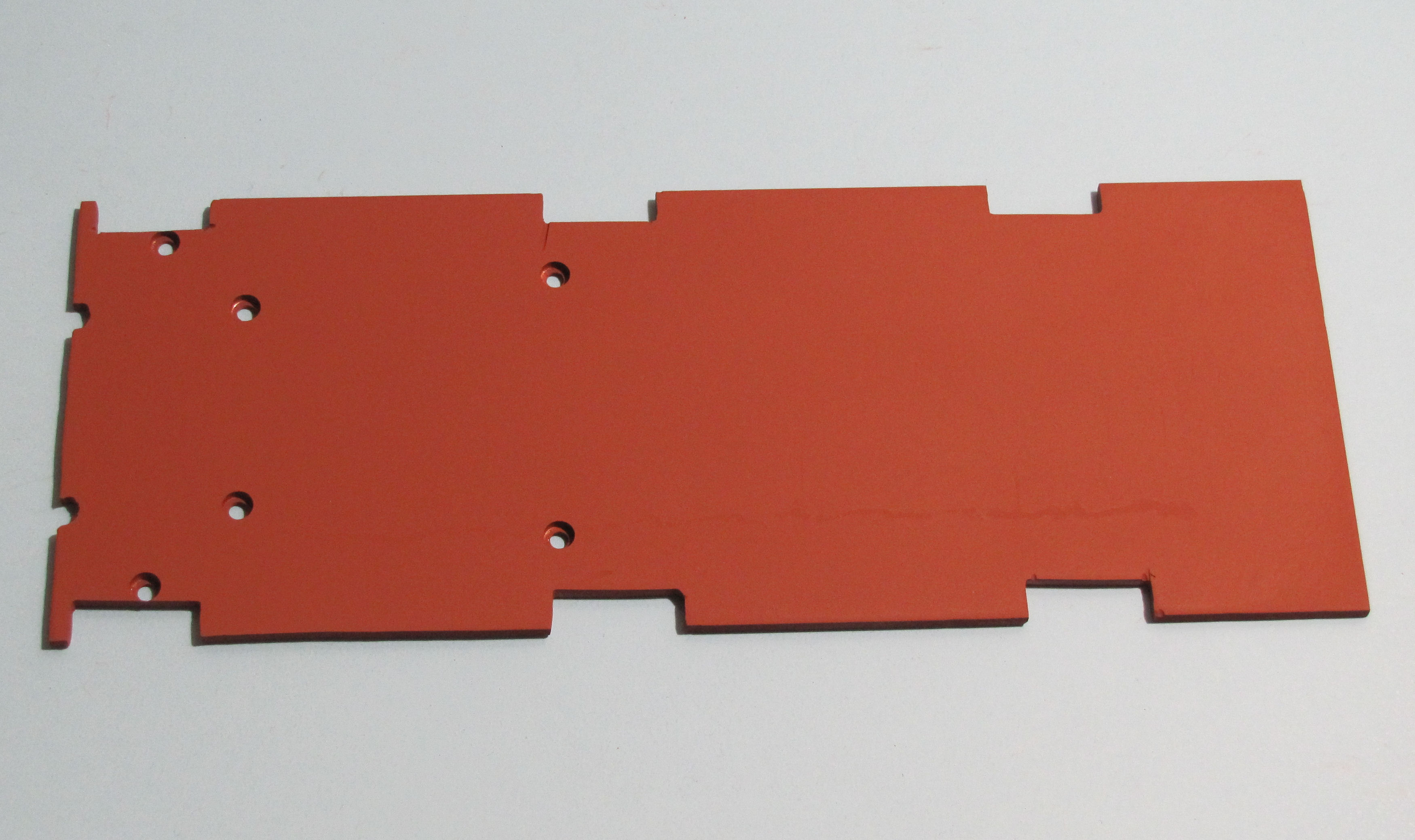

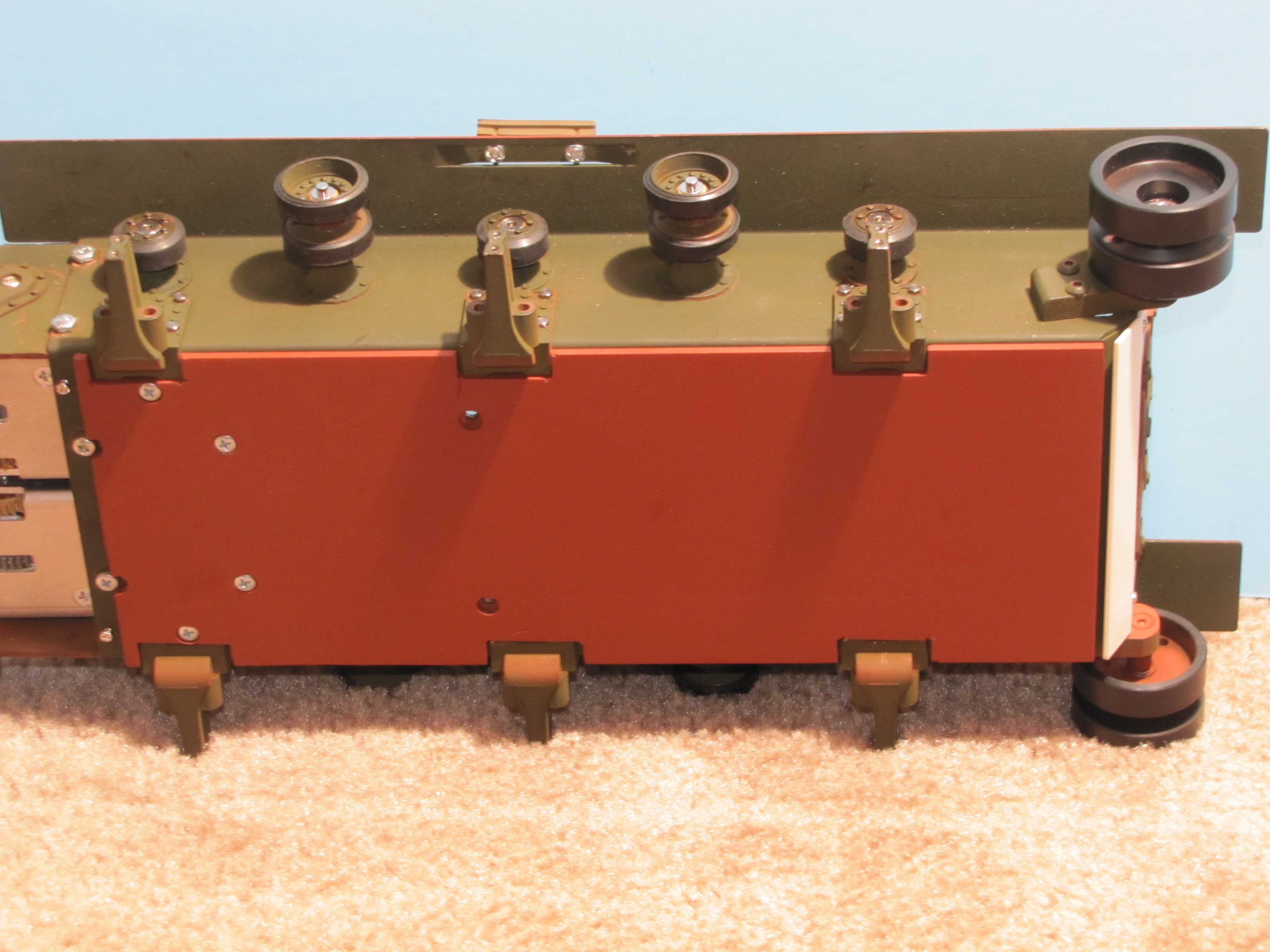

Old 07-10-2014 | 06:44 PM
Shark27's Avatar
Joined: Jul 2009
Posts: 537
Received 24 Likes on 17 Posts
From: St. Petersburg, FL
Los Tx
Here is what I did.
Steve
Name:	Hull Plate.JPG
ID:	2013297   Click image for larger version
ID:	2013298   Click image for larger version

Neat idea, but the problem with just adding a sheet of metal to the bottom is you still haven't addressed the Center of Balance issue! Personally I use stick on car weights and that solves everything..
