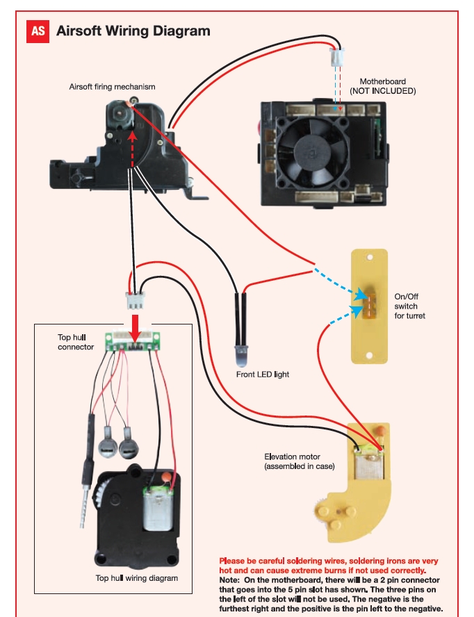

I think this is the picture you are looking for
Just solder them to the same leads on the upper hull connector. If you really want to you could tap into pins 6 and 7 on the lower 8p connector coming out of the motherboard so you dont have to have a disconnect for the upper hull when you remove it. Tapping it from the lower hull is probably the better idea.

Yea the quickest way to trace the HL is just to unscrew the top hull connector and look at the back of the small pcb board and follow the traces to see which wires have the LED power going to it. Then tap them near the plug at the bottom. I might actually be able to make something up for you. We will talk soon.

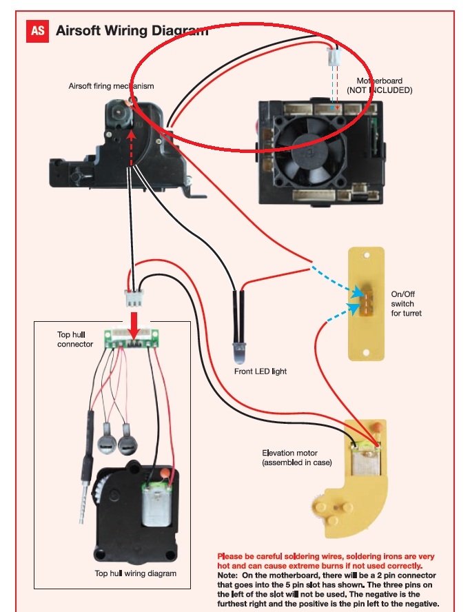

thanks for the diagram. But, what does the two-pin lead between the airsoft gun and the control board do?
That is the contact switch that signals the airsoft unit has been fired and that the motherboard needs to perform track recoil and output cannon sound. If you disconnect it you will not get a track recoil when you fire, nor will you get sound.
Thanks for the explanation. I can live without the cannon sound if it means skipping the track recoil.
