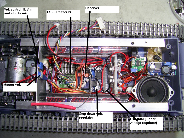

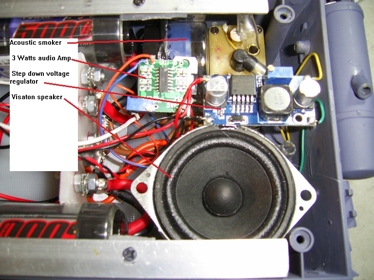

That looks so good. I have yet to hookup power to the smoke unit you sent me. After seeing that I am inspired to get off my butt and give that a try. It looks very convincing.
Thanks Dan! This new design is more power efficient than the unit I sent you...
Your unit is equipped with a step-up voltage regulator powering a 24 Ohms 2 Watts resistor at around 12.5 Volts
For the latest design, I went opposite by using a step down voltage regulator powering a 5.49 Ohms resistor at 4.8 Volts...
I also turn the speaker around a 180 degrees to get more pumping and eliminate the tubing, meaning that the speaker can operate at lower volume; thus the possibility to use a 3 Watts 5 Volts mini audio amp.
Due to the use of voltage regulators; both designs will supply a constant smoke output from 8.4 Volts to 7.0 Volts...

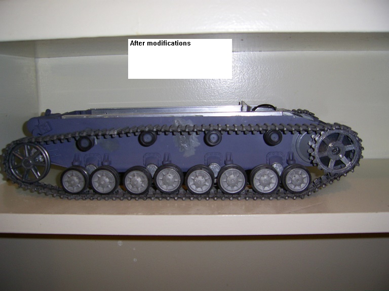

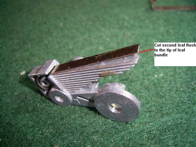

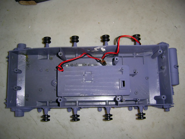

Old 10-15-2014 | 08:09 AM
Joined: Sep 2009
Posts: 520
From: Elliot Lake ON, CANADA

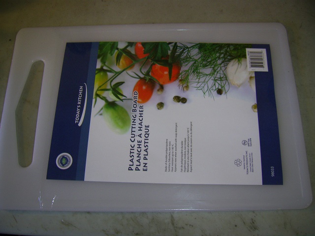

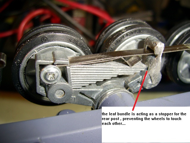

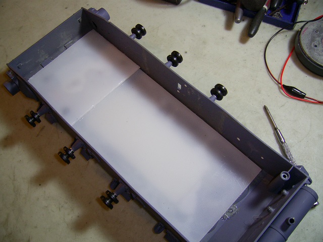

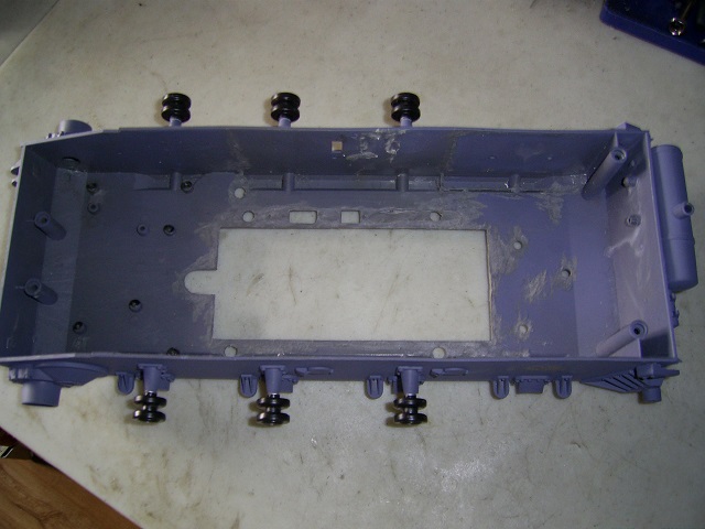

Project update:
- stripping the lower hull:

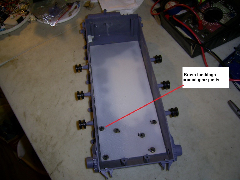

-Re-enforcing the lower hull:

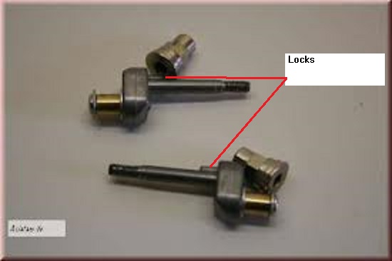

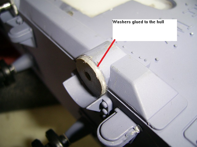

-Installing the Asiatam metal suspension: I had to make some plastic washers using left-overs from the battery box; so the road wheels would align with the return rollers...

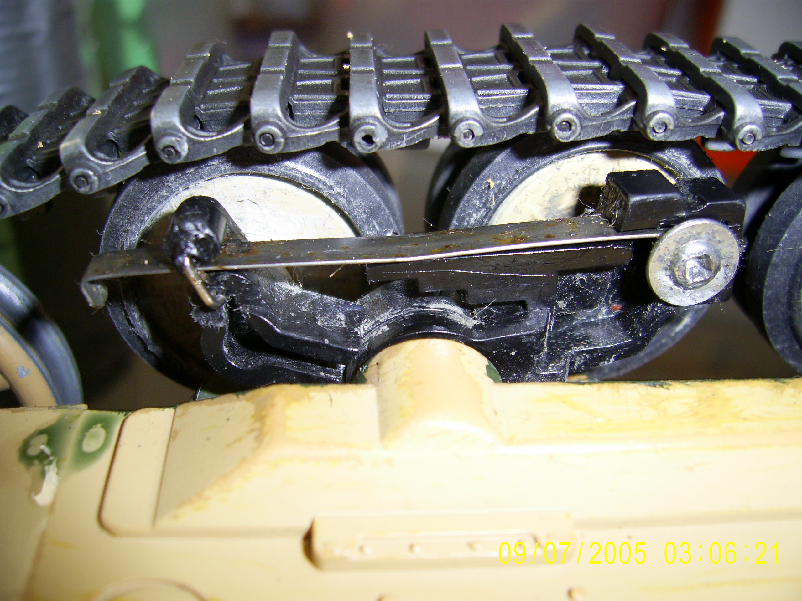

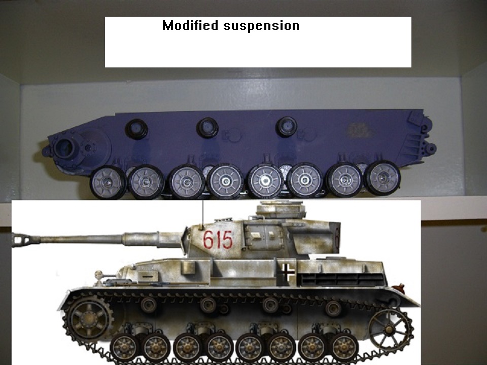

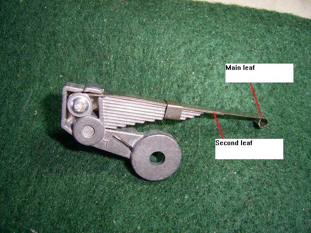

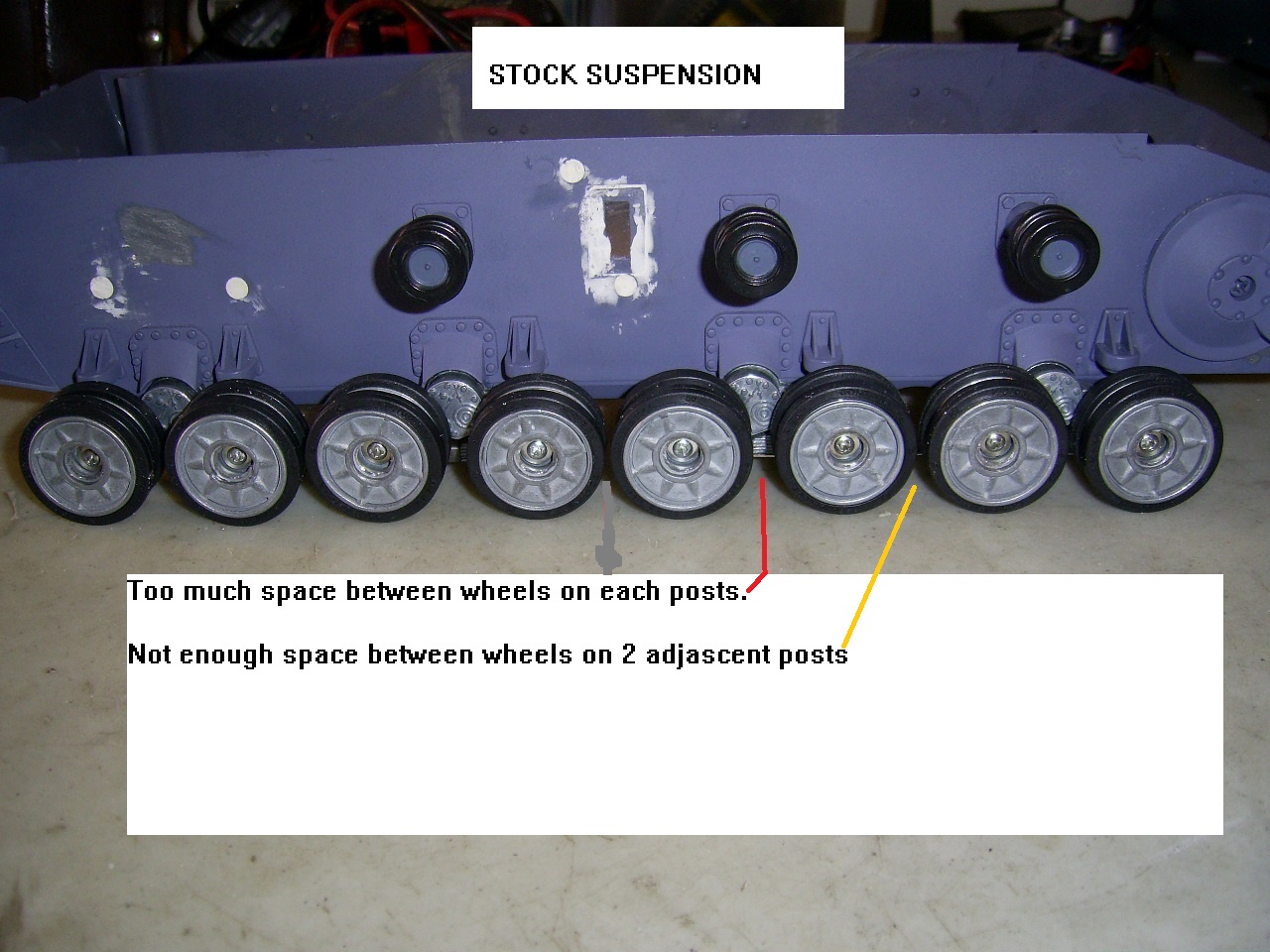

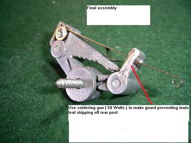

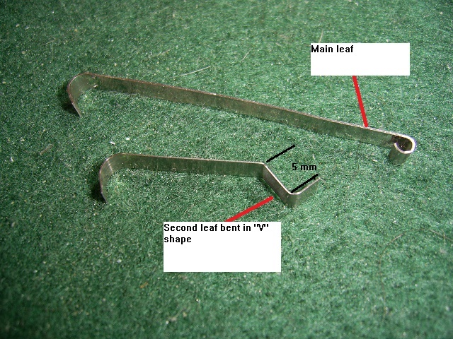

-MODIFYING THE ASIATAM SUSPENSION
I believe this mod. can also apply to the Taigen suspension since they look the same and probably share the same flaws...
-THE SUSPENSION IS TOO RIGID AND SITS TOO LOW: There's too much space between the wheels of each posts, leaving not enough between the wheels of the next post; for flexing...
-So I decided to fix the problem: Here's some pictures with comments...
Here's a short video to show how the modified suspension is flexing: https://www.youtube.com/watch?v=2x3AKPkdBa0&list=UUoWjHTJi7Z1uGnVnrbH3GxQ

Interesting suspension mod...I like it. A few questions...
- Do you have the length for each leg of the V on the second leaf?
- The longer leaf looks like it extends a long way out of the suspension. Any concerns with it snagging on the ground as the carriage rotates when going over uneven terrain?
- Why did you need the plastic washer in the carriage assembly? Is the Asiatam carriage narrower than the HL?
Old 10-17-2014 | 07:14 AM
Joined: Sep 2009
Posts: 520
- The first leg of the "V" is about 5 mm and the angle is around 45 degrees:
- The main leaf is the same length than the H.L. one...I never had any snagging problems with my old panzer IV; except for a leaf falling off the post of the rear wheel and snagging on the track when I went backward...I modified the H.L. plastic suspension to remedy the problem:
- I used the return rollers as a reference when I installed the Asiatam suspension and noticed that the wheels were sitting too close from the hull...
Shimming the posts with plastic washers solved the problem for me...
I'm not the first one who had problems with the alignment of the Panzer IV suspension:http://www.rcuniverse.com/forum/rc-t...uspension.html

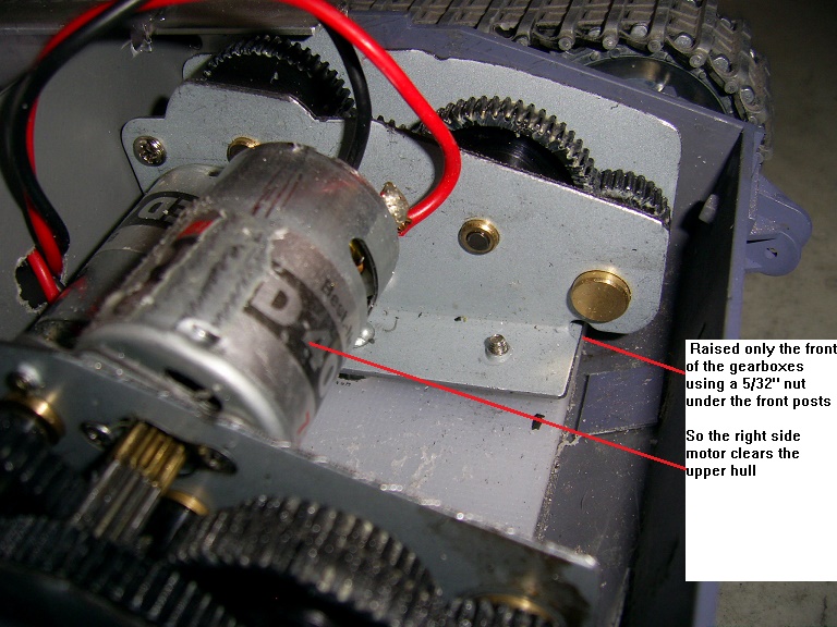

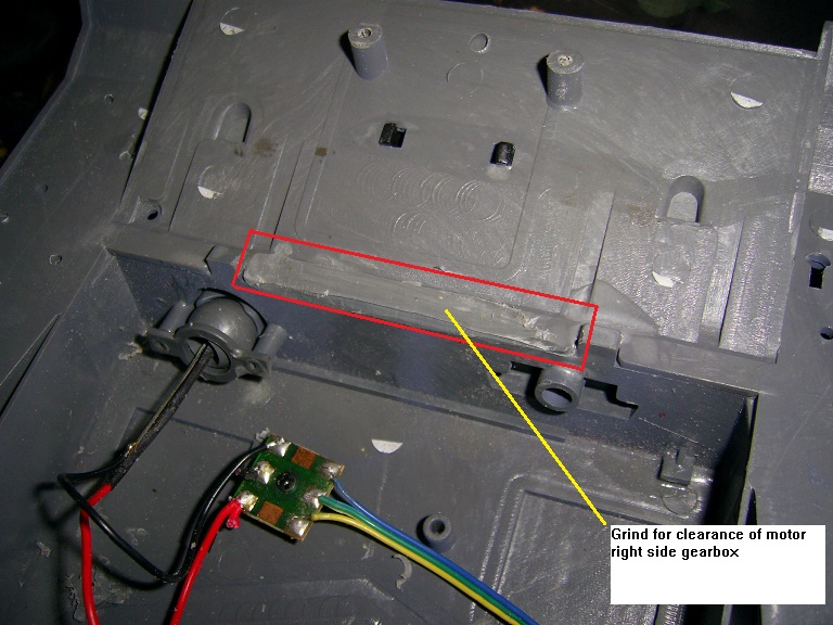

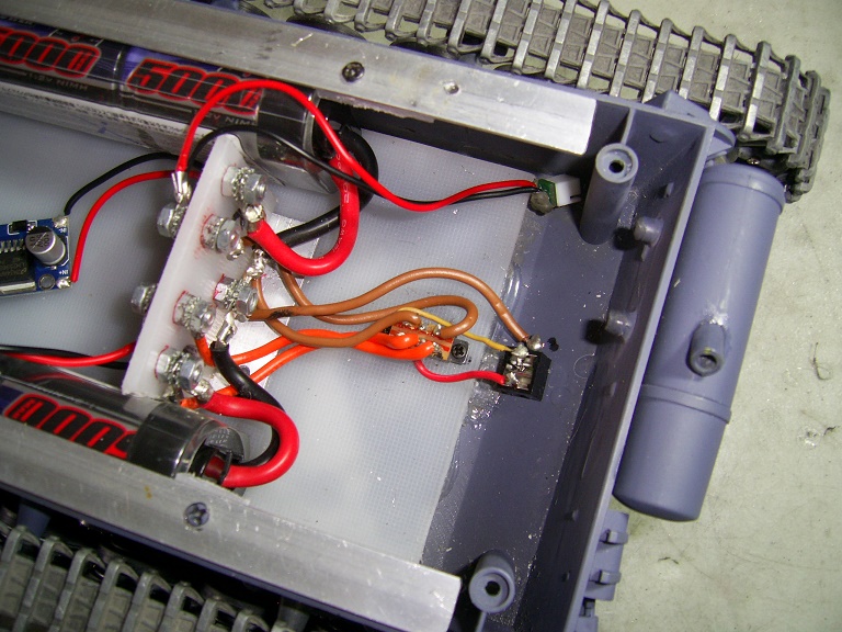

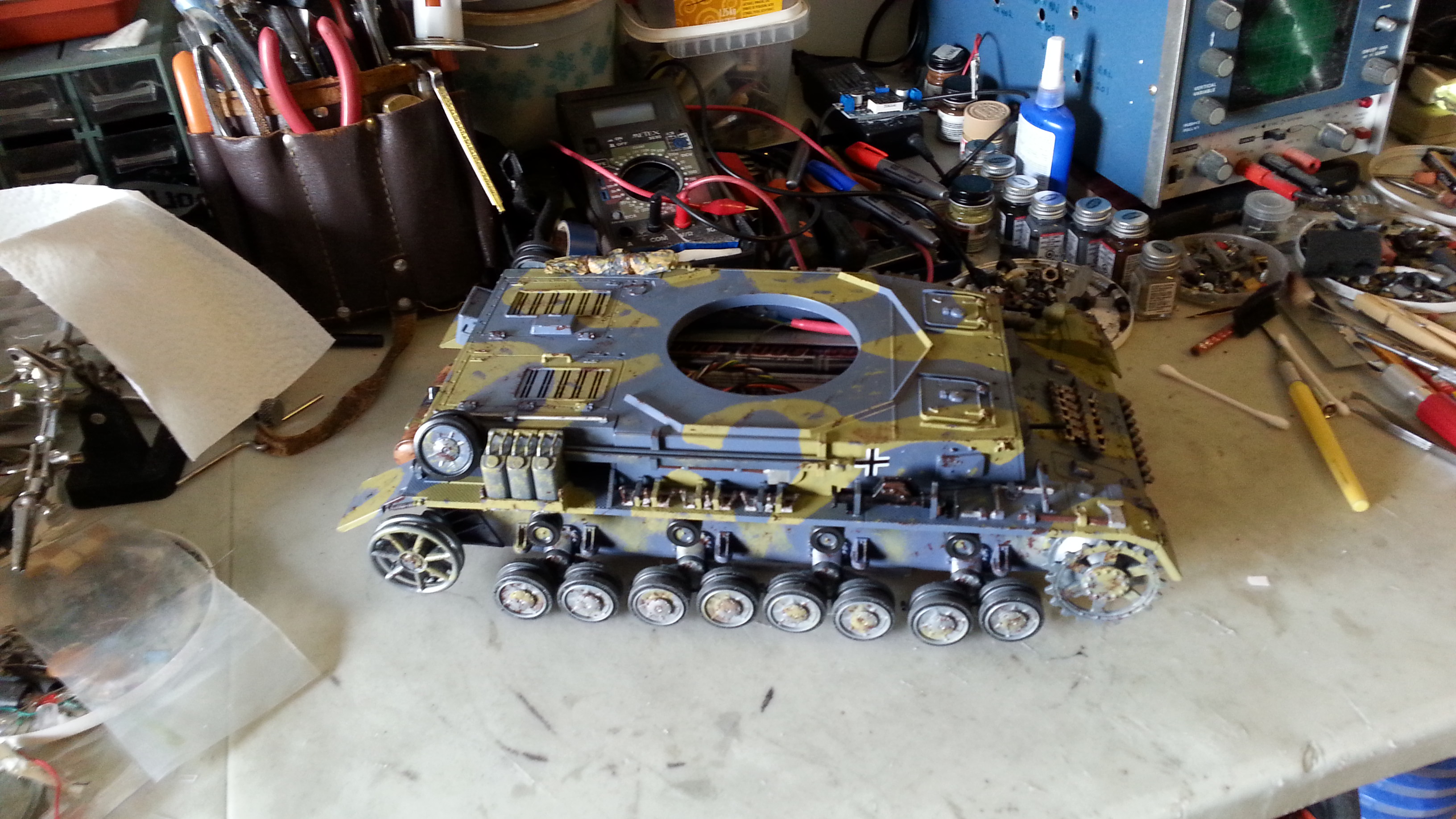

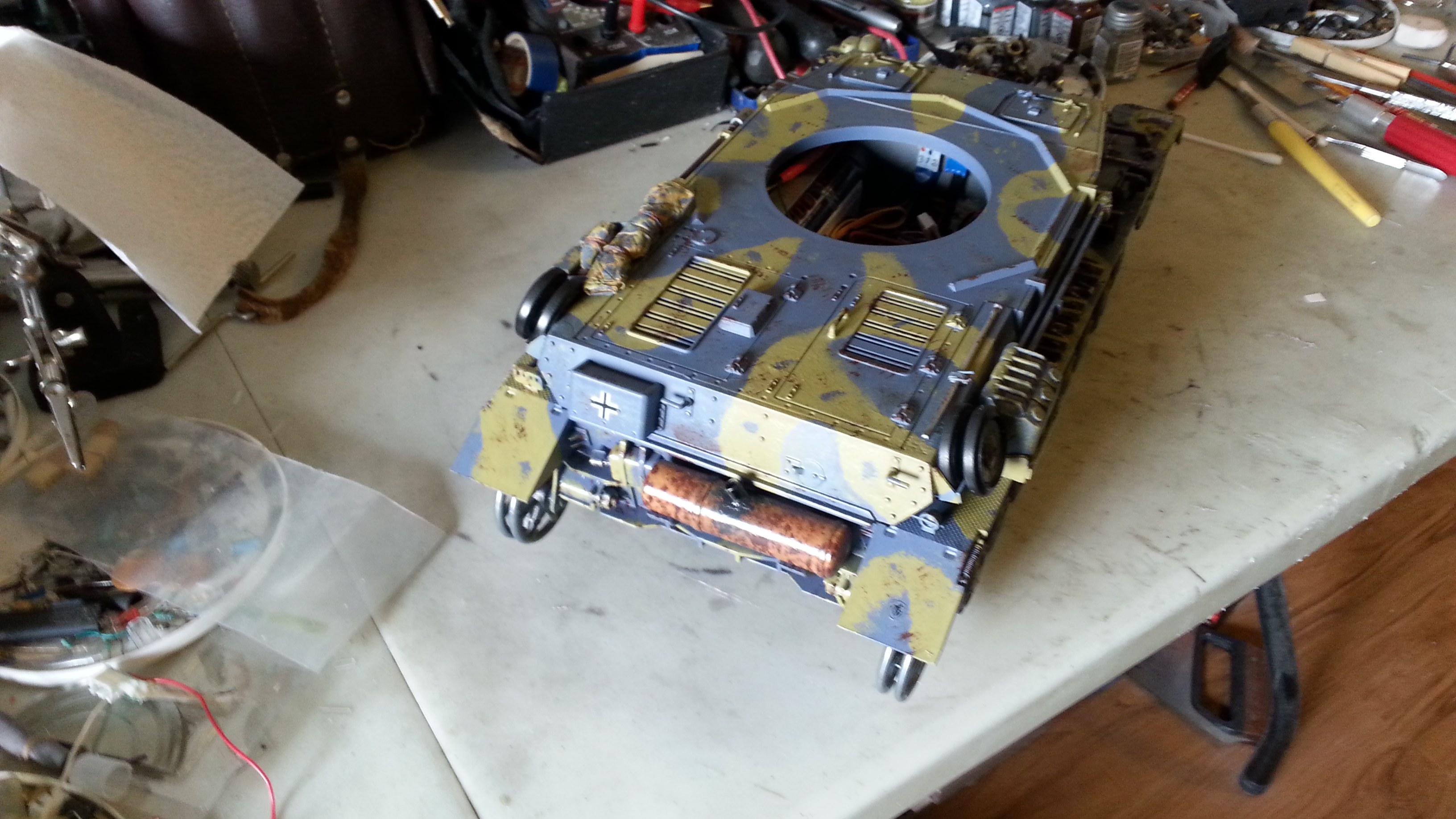

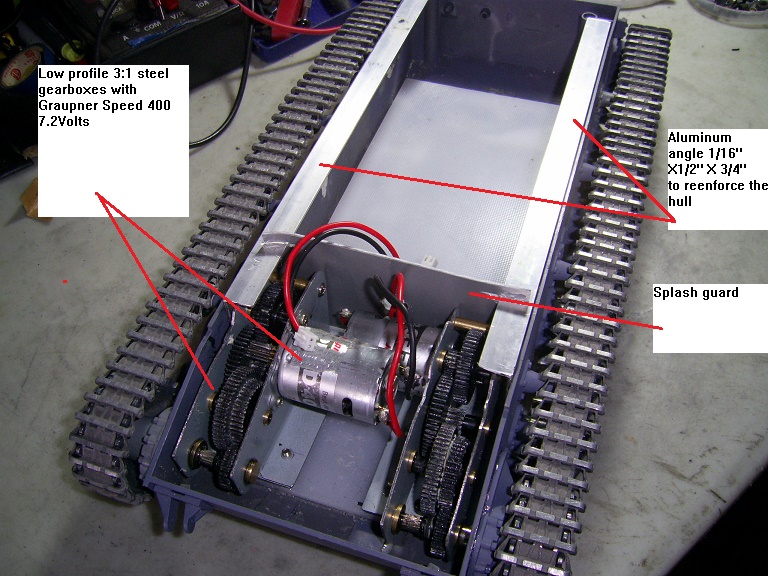

Here's an update on my panzer IV F2:
I got the lower hull up and running...
- I had a period of indecision as to the kind of gearboxes to use...
I first tried a set of Mato brass gearboxes that I bought on sale a couple years ago...But even after they had been broken down and lubricated, they were still too noisy for my taste...
So I switch to a set of 3:1 low profile steel gearboxes, equipped with a pair of Graupner speed 400 7,2 Volts motors,,,The motors themselves were worth the switch...
I also had problems with the Asiatam tracks adjusters; but It was all my fault...They didn't come with instructions and I didn't know what to do with those little notches on the side of the shafts; so I " dremmel" them out... When I tried to use lock washers and tightening the nut to lock the adjusters; I ended up breaking them...
The bright side of my mistake is that I made my own track adjusters; and I kind of like them better...http://www.rcuniverse.com/forum/rc-t...panzer-iv.html
The rest of the build took a while but was incident free...Here's some pics with commentaries...
And a short test video: http://youtu.be/et8iG8SJf6A?list=UUoWjHTJi7Z1uGnVnrbH3GxQ

Looks really good. A few questions that will help on my build, if I may...
- Looks like you raised the sprockets by about 4-mm. How much did you lower the rear return rollers?

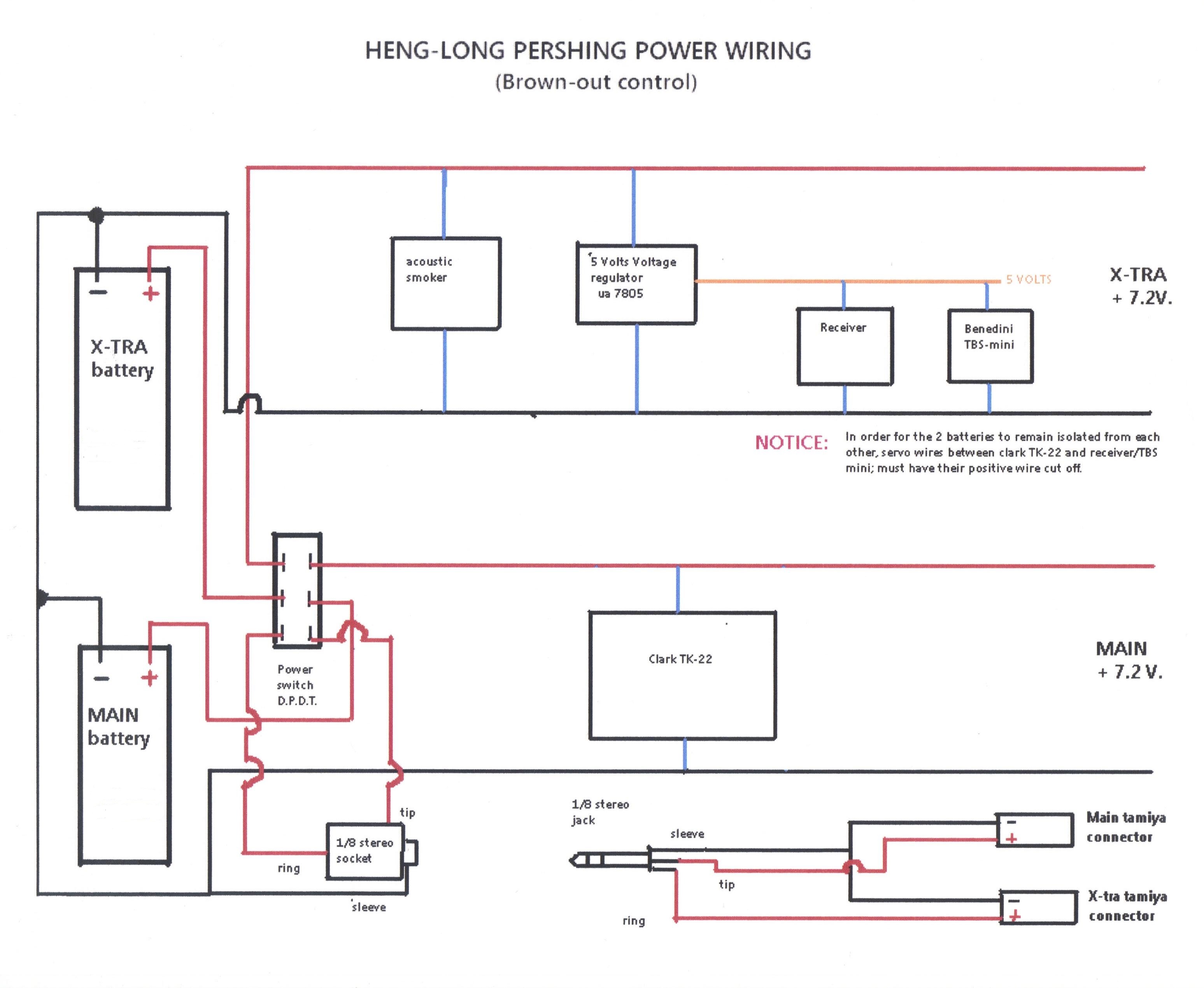

- How did you wire the charging port? I've looked at the stereo option, but I'm not sure how to wire it (in the tank and on the charger) and then include the on/off switch. Any concerns with charging the two batteries together (I assume they're in parallel to the TK board)? Or, do you isolate them while charging them? Would love a circuit diagram or wiring diagram for this mod. There are transmitter charging leads that I've considered using for the charger side, but wouldn't know how to wire the tank side correctly (proper placement of positive and negative).
Old 12-16-2014 | 07:37 PM
Joined: Sep 2009
Posts: 520
The last return roller was lowered by 4 mm...
The 2 batteries are not connected in parallel, they each power a different load and share a common ground...
I'm using 2 chargers and each battery is charged individually....
Here's the wiring diagram for my H.L. Pershing ( witch is basically the same):

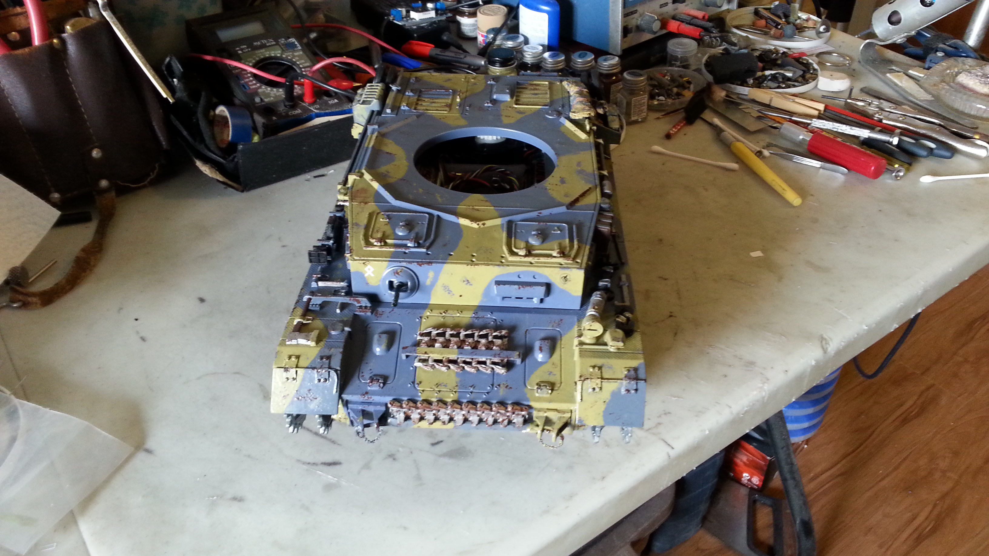

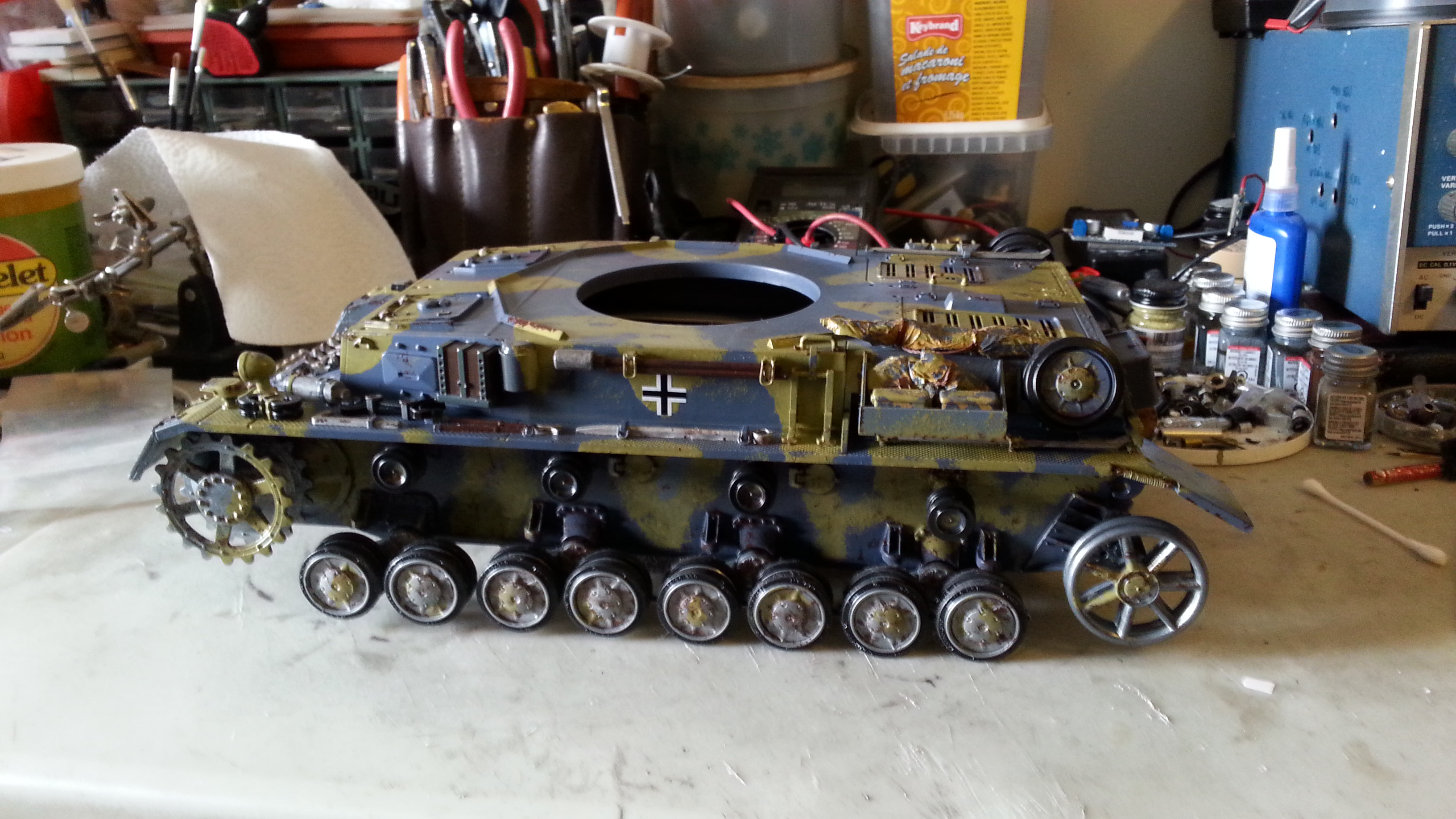

Old 02-17-2015 | 08:31 AM
Joined: Sep 2009
Posts: 520
Humm...Wonder how long those are gonna last when driving in the grass??

Well progress has been slow but steady, I'm almost ready to work on the turret...
My tank won't be anywhere close to yours as for the detailing; but that's good enough for me...

Looking good so far. I've been working on my suspension using your work as a guide. If the tracks are still off, do you have any photos of how the road wheels and return rollers line up relative to the sprockets? Something looking down the line of wheels at the sprocket? Or, so how much the bogie sticks out from the plastic cover (rounded portion over the bogie)? I'm thinking that I need to add the spacer like you did and want to compare what I'm seeing to what you've done.
Old 04-11-2015 | 07:02 AM
Joined: Sep 2009
Posts: 520
I started with the concept that the original plastic suspension and return rollers were lined up with the sprockets...Then I used washers to align the Asiatam suspension with the return rollers witch in turn gave the alignment with the front sprockets...
The last thing to align was the rear idlers....
Good to know...thanks. I replaced the plastic return rollers; so, I'll have to work it a little differently. But, always good to hear how someone else did it because it gives me ideas.
