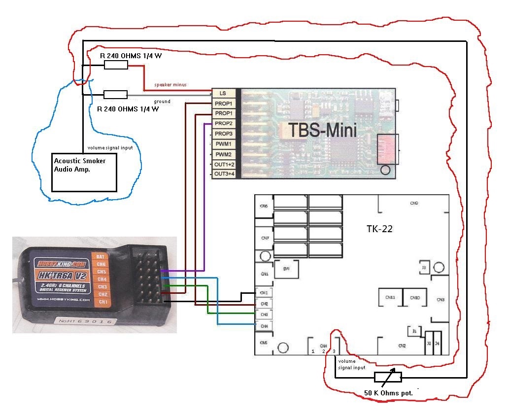

Since we are talking about the TBS mini here, I was wondering if Dan or somebody could clear up some connection questions I have regarding splitting the TBS sound output to the Clark and an audio amp, I know you use the Spkr + to connect to the TK22 CN4 pin 3 to combine the TBS with the Clark sound. But the Benedini manual says use the Spkr- and Ground to connect to an external amp. So does the TBS Spkr GND go to the amp's Input - and the TBS's Spkr- go to the amp's Input+? Thanks.

I follow more or less the manual by using 2 resistors of 240 Ohms and a 50 K Ohms potentiometer to adjust the mix with the Clark Amp.

Be very careful. Typically you only hook up the signal for the TBS to the amp. (Top LS output pin) Do not hook up speaker ground. I disable this connection on the amps I sell as I destroyed a TBS when I inadvertently hooked up what I thought was a common ground. The result was a fried on- board amp on the TBS.

Thanks for all the replies. That's what confuses me. I know that the TBS signal is the top LS pin which is what is connected to the Clark via a 25K resistor. Now I was going to split it to an amp to drive another speaker like what strmnd54 did to his acoustic smoker but was confused when the Benedini manual said use the LS- and ground to the amp. So which one is the right one LS- or LS+ to the amp? I am trying to avoid the exact thing that Dan mentions.

So are you only going to use the TBS to deliver sound to two speakers? The amps I sell have outputs for two speakers. So just one wire from the TBS to the AMP, and then you can have two speakers tied into the amp.
If you are paralleling the TBS LS out, you probably need to be concerned about over driving the on board amp. it might be safer to run it in series with your existing speaker.
