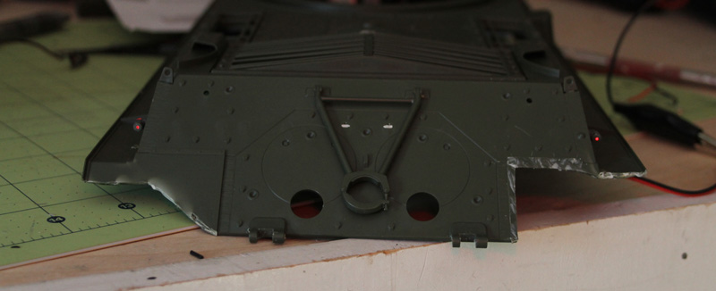

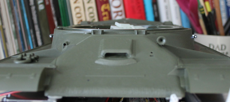

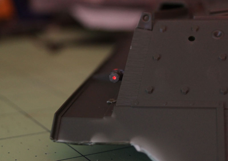

Keep in mind that red light is a working brake light.
I couldn't resist and installed them (and the navigationals).
