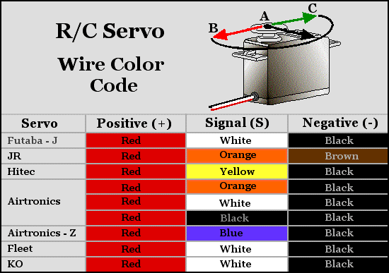

Also, this is a dumb question, but what color wire on the channel plugs are pos or neg?
The receiver does not have slots for the tabs on the channel plugs.

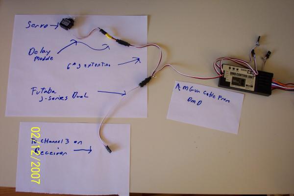

Here's a quick video to hopefully explain the hook up to a receiver that has more than 4 channels on it. If not let me know and I'll see what I can do.
https://www.youtube.com/watch?v=ZFc2VPyFC0s&feature=youtu.be Now i got lucky and that is just how mine happened to line up. Sometimes Ch2 and Ch4 have to be swapped around.

Wow, thanks for the video Bill.
One difference between our receivers is the slots on mine are not numbered, just labeled as I said above.
Another difference is the slots are vertical, so they plug in from the top.
There are just + and – and pulse symbols indicating polarity.
So I have to go by color of the wire.
Knowing the polarity of the hi-tec wire colors is helpful also.
The elevation servo uses those colors.
I'll give it a try and let you know.

OK lets see if this gives you a bit of help as far as channel goes
The receiver has 7 open slots
Bat= Not used
Thr = CH1
Aile = CH2
Ele = CH3
Rud = CH4
Ger = CH5
Aux = CH6
As far as the indicators of the servos go. the diagram should have the + in the middle with the - and signal on either end. White or Yellow depending on Hitec or Futaba will be your signal. I have a futaba set like that. In that case the signal is the closest to the center of the box.
hope that helps.
Bill

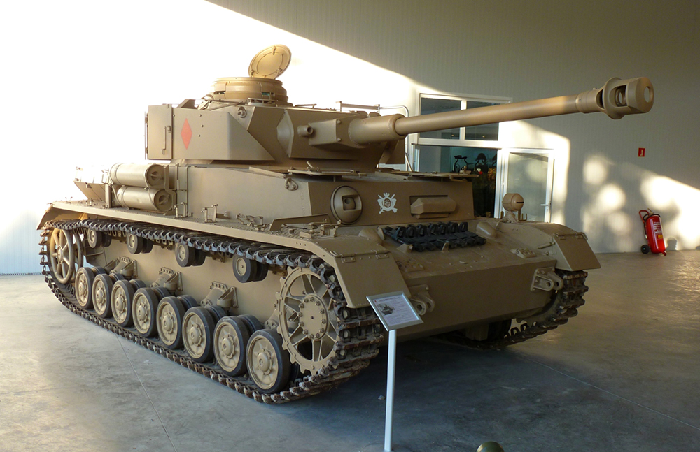

I know that the real PIV dropped the traverse motor between the H and the J.
Hence the disappearance of the exhaust looking thingy on the right side of this H below.

Turret traverse exhaust was on rear hull next to motor exhaust. Remember reading about those cylinders years back, something experimental (rapid refueling, compartment air scrubbers, piss distillers....can't remember.

Have you tried plugging in a servo to the unused channels and pressing the fire button to see if that makes the servo move?
This servo wiring diagram should be helpful:

Here is the diagram I was using when I was trying to install a servo on my pershing using a 4YF.
The only difference was I used the camera hold module instead of a delay.
Would it be the same setup?
This setup refused to work for me.
The most common result was that the servo would 'jump' when I fired, sending my IR beam a sunder.
One other variable here is the Spektrum has one of Randy's VBT chips installed.
But it can be turned off independently, so the fire button functions with out them.
I also have them on my 4YF's.
all on a self centering stick. Before the camera hold module was out, I still used just a delay module to slow the servo, but had to essentially do an elevation sweep shot to fire. I'd bring the barrel above/below to where I wanted to shoot, then let go of the stick while firing to hopefully have my IR "fall/raise" onto my target.

So, in my last post I wrote these exact words above the photo...

Last time when you told me about the photo delay module, I bought it, and I tried it.
I think I tried it with a self centering stick and without.
I think when I tried it without the self-centering, the elevation noise ran continuously.
I think when I tried it with a self centering, the servo/barrel jumped when I fired, like it was getting a jolt of juice.
I think I also tried it with one delay, and even maybe two delay modules in sequence with the photo delay.
I think.
I think.
I think I really don't know what I was doing wrong, or maybe I was over-thinking/over-analyzing it.
