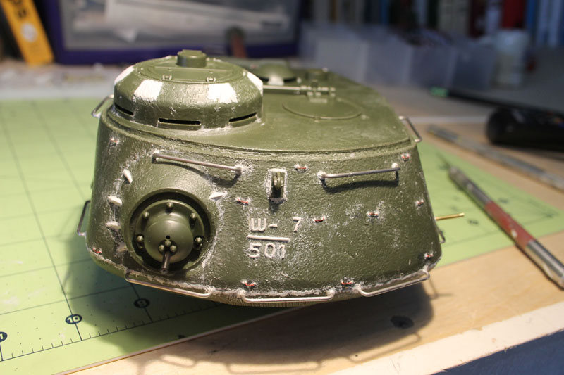

A wee bit more progress, have done the turret basics. Fitting a tbu so have hidden the emitter in the HUGE muzzle break. Hulls had all the detail I don't need to pre paint added. Next week the lower hull goes off to guido Henn for an improved idler system that should help the front end rigidity
Some more progress, trying to smooth the turret seams, about 5 layers of Mr surfacer so far, to ably a couple more required. Also added magnetic hub caps for the sprockets

Been a long time since I made progress on this but got my ammo modulation set through so time to get cracking.
First was a coat of Tamiya fine surface primer to all the photo etch and metal parts. Then a base coat of gunship grey to serve as the metal coat.
Next after it had cured a coat of hairspray ready for the 4bo base.
The mig set has four colours, dark base, base, light base and highlights.
Dark base:
Base:
Light base and highlights
After this I added some of the dark base as streaks and post shading.
Final result with chipping
That's all for now
