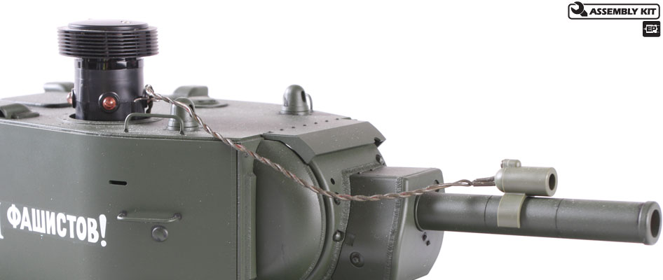

Hi all... I am currently looking for IR conversion as well... one thing that everyone is talking about here is the control system, but missing is the actual hardware.
I have a euro Taigen Jagdpanther in IR with an IBU2 Pro. It was pretty straightforward to plug in (only small modification necessary). But I don't have any other IR tanks or targets so I have no idea if it even works right.
I have an Airsoft KV2, and I would like to convert it. I already have another IBU2 on the way.
Erik tells me Imex doesn't have any KV1 or KV2 turrets or upper halves in IR. But he said I could buy the parts and convert myself.
So what are the parts exactly? Can someone illuminate what the hardware is that is needed for IR conversion, apart from a board like the Clark, IBU, etc?
I am also considering maybe getting a cheap heng long sherman or pershing and converting that. I guess Heng Long's don't come in IR anymore? I've been watching ebay for a couple weeks and it looks like they only sell airsoft now?
Heng Long is getting out of IR, but I didn't know they were already that far.
You need an emitter and a battle unit (receiver/apple/mushroom) to convert to IR. Also a flash unit. Most guys do barrel recoil but it's not strictly necessary to be IR ready. I'm about to put an impact unit in my Tiger One but it was an IR tank to start with, so I have a head start. One nice thing about the IBU is that the Impact and Tamiya (TBU) plug right in. You'll have to mount the base for the battle unit, and install the emitter (usually in the mantlet, maybe where the airsoft warning LED is now) and also the flash unit in the barrel. I've heard of guys using the old airsoft unit and hollowing it out to pass the wires through and still keeping elevation intact, but you may be able to do something with one of the existing IR units. Someone more familiar with the KVs should know what fits best.
I think that's everything, but I'm sure my fellow forum members will speak up if I missed something.

You can easily add IR to a BB tank but its the BB to IR that is a bit more challenging. Clark or similar lets you choose the BB or IR setting. Add the IR emitter and its ready whenever you change the settings. An easy flash solution is just run a temp led to the muzzel if thats what you want for IR.
Simple.
Better is get an old BB unit and gut it. Put the HL high intensity unit into it and all you gotta do is remove the turret. The remove the two screw holding the airsoft unit in. Swap it with your gutted one including the flash unit.
