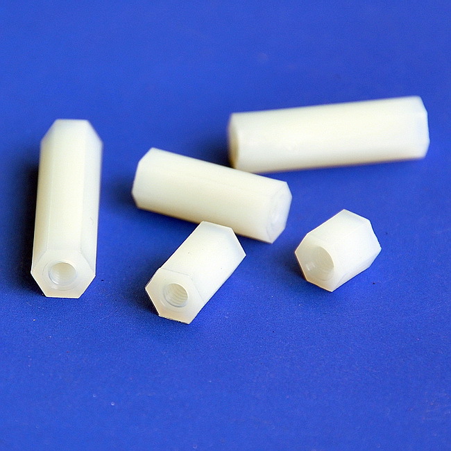

I've also ordered a buttload *a buttload is about 475 litres, look it up* of M3 nylon standoffs.. Ive recently found them incredibly useful for mounting just about everything else.
