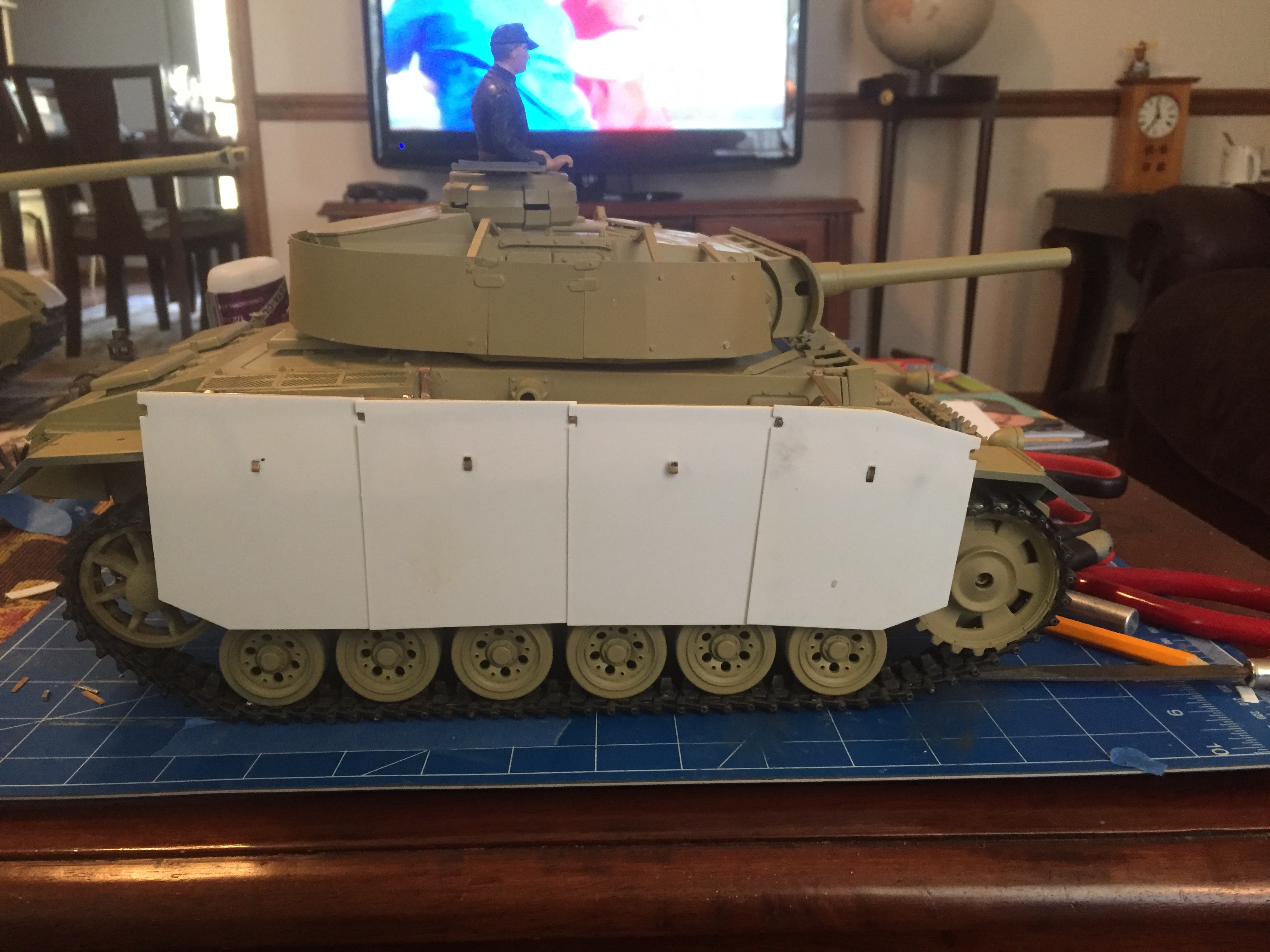

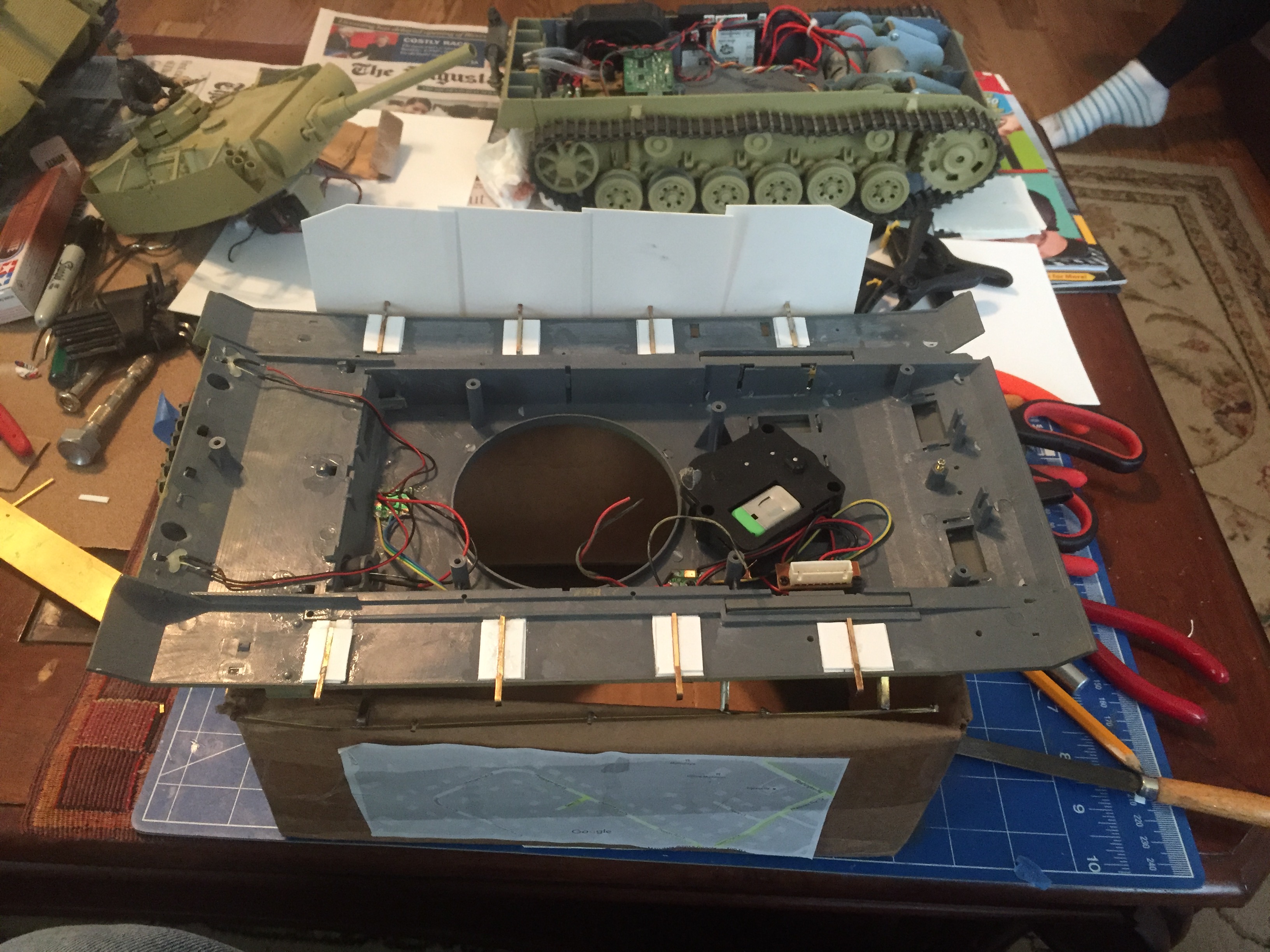

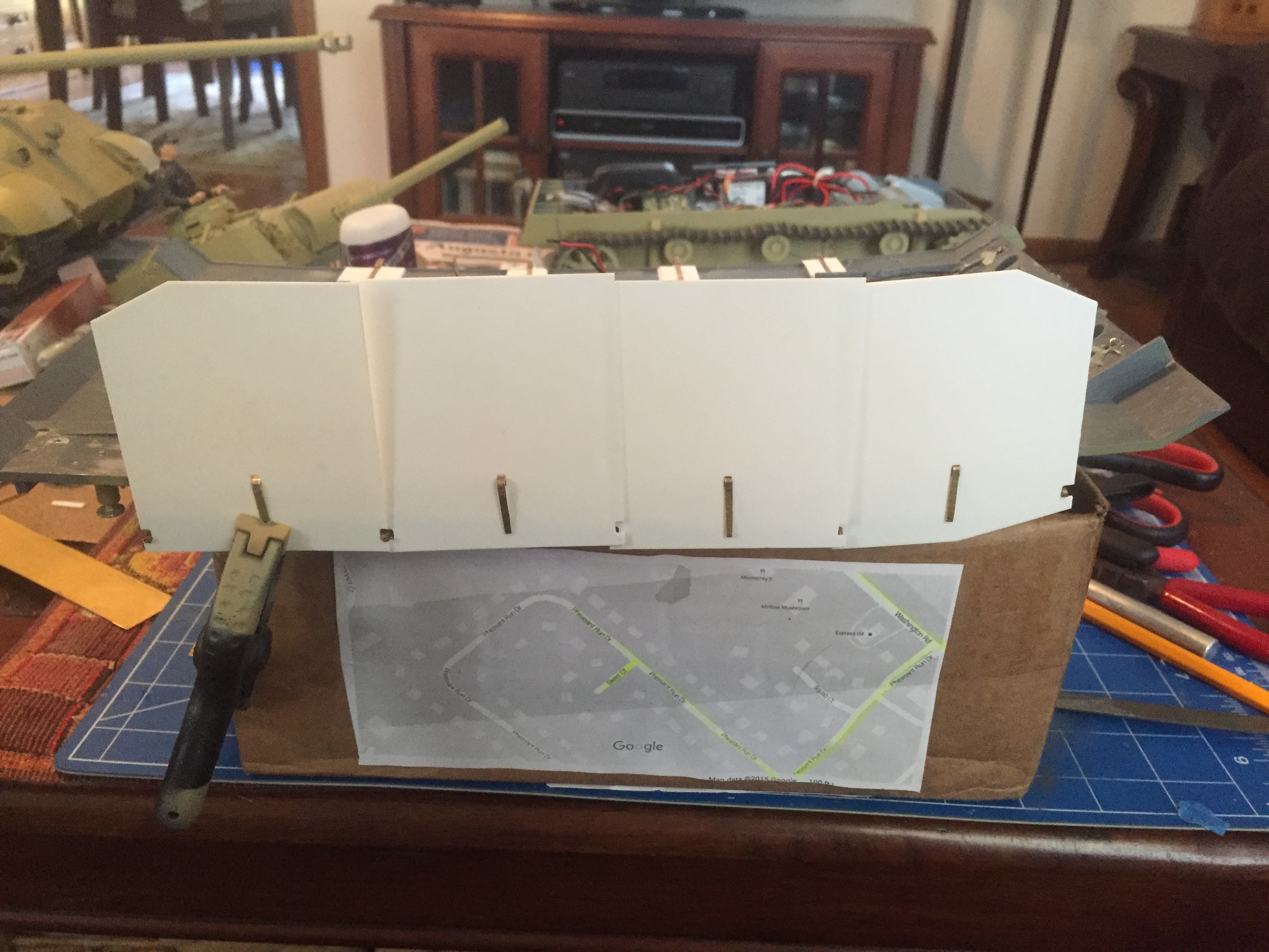

  #63
Joined: May 2009
Posts: 1,506
From: Evans, GA

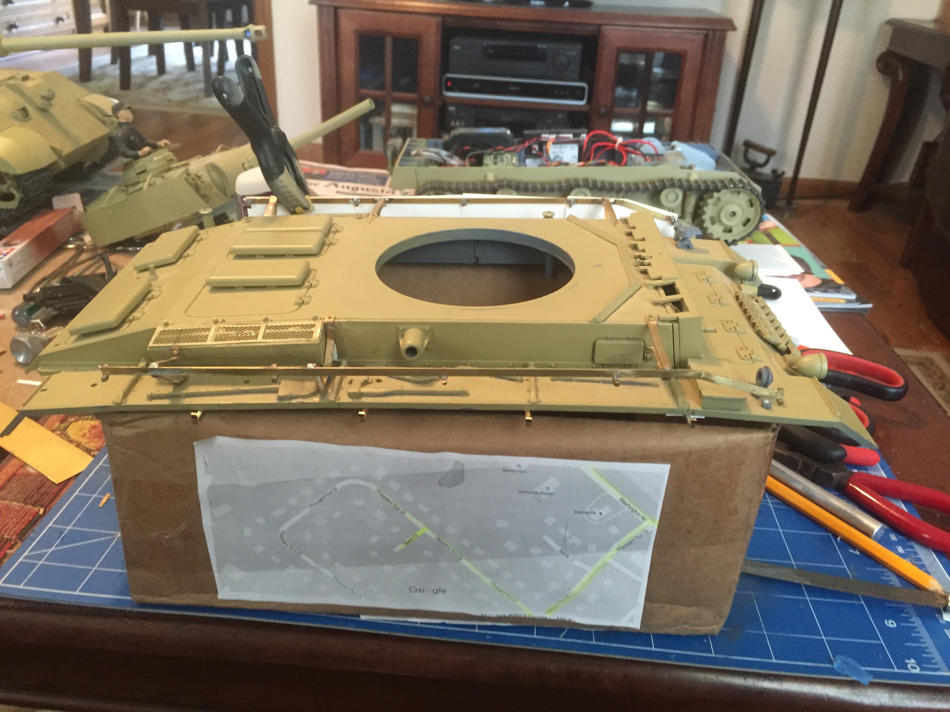

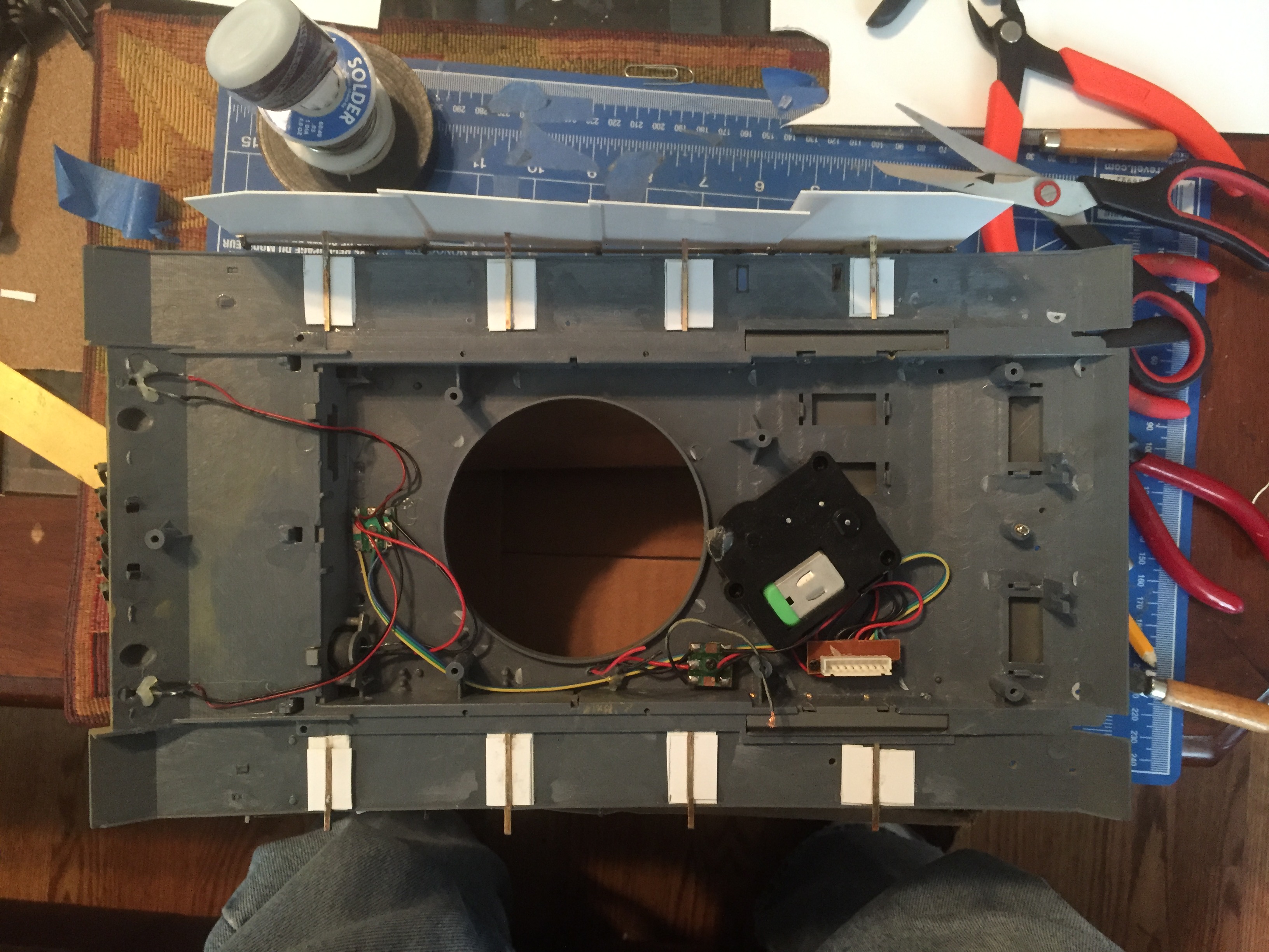

My Mods for my PZ III Side Skirts. Pic 1 and 2 shows the side support brackets mounted to the underside of the fenders. Pics 3 and 4 ( double upload, sorry ) shows the end of the brackets ( upside down ) prior to trimming. Pic 4 shows the trimmed brackets and upper rail. Pic 5 shows the completed skirts ( needing painting of course ). Pic 6 my hoped for final outcome.
I would appreciate any comments and hope you enjoy.

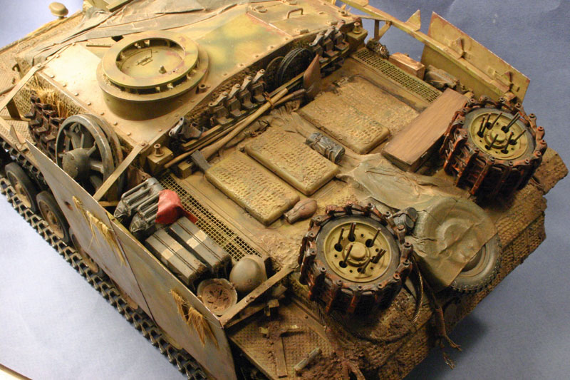

Old 02-07-2016 | 11:47 AM
  #64
ausf's Avatar
Joined: Apr 2005
Posts: 3,084
From: , NY

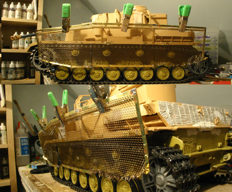

Very nice.
One thing I might add, you may want to make them out of brass sheet instead and whatever you do, make the removable since they will get bumped.
I've done the brass on the StuG and screened Thoma on the PzIV and they get knocked around more than you'd think:

Old 02-07-2016 | 12:49 PM
  #65
Joined: May 2009
Posts: 1,506
From: Evans, GA
Ausf,
Thanks. I have already made them in brass, but figuring how to make the cutouts for the fender supports. I suppose I could drill a hole and file it out, but that seems like it would take for ever. Anyway, used the plastic sheet from the kit so I could place the fender supports. All the sheets are removable.
Thanks again.
Old 02-07-2016 | 01:40 PM
  #66
ausf's Avatar
Joined: Apr 2005
Posts: 3,084
From: , NY
Brass is pretty soft, drilling and filing is the way to go, shouldn't take long. I just filed down the cut edges 1/8" round rod for some drive shafts in less than a minute.

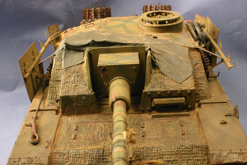

Nice work on the schurzen Jim. Brass is easy to file. I am still working on a set of Schurzen for my Stug III G. Here are the part I have completed so far.

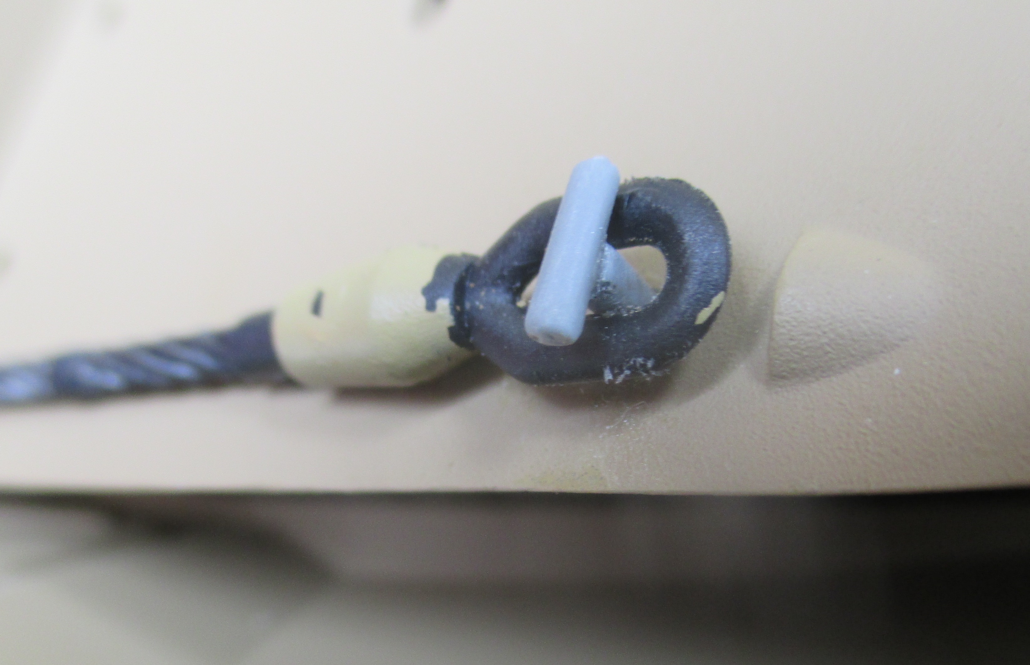

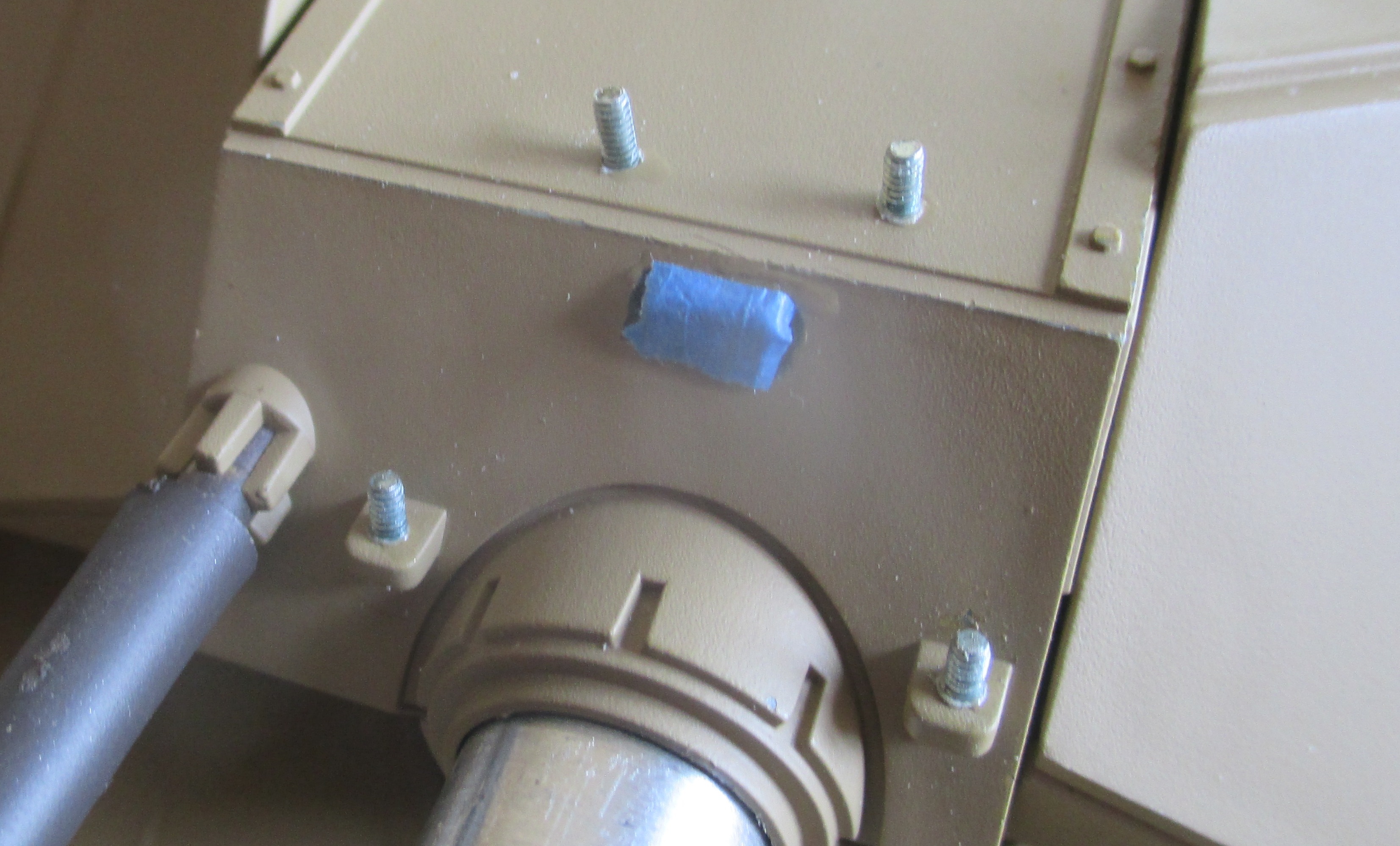

Old 03-17-2016 | 05:16 AM
  #69
Pah co chu puk's Avatar
Joined: Apr 2010
Posts: 3,259
Received 152 Likes on 98 Posts
From: Ridgway, CO

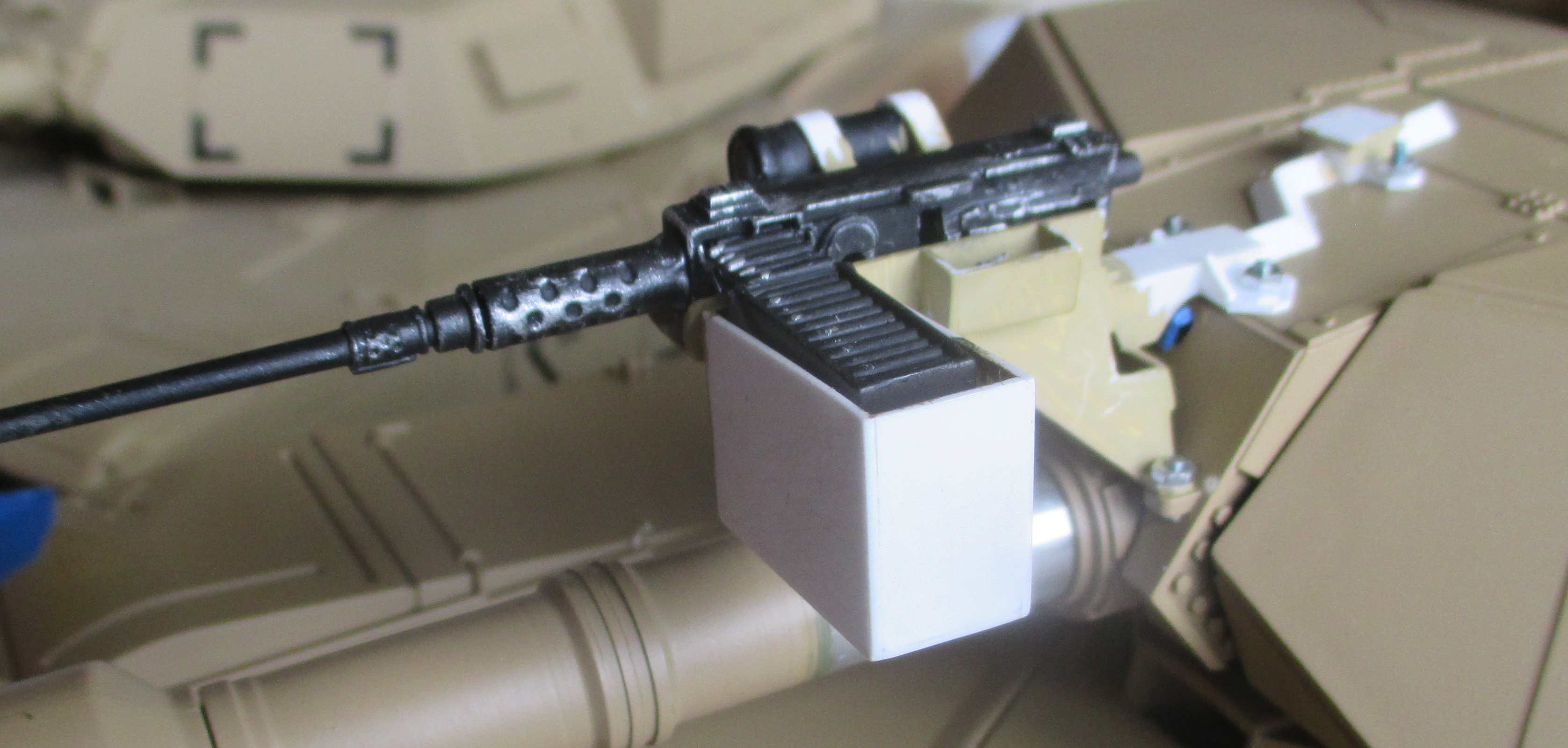

I did a bit more work on the Abrams.
I made proper tow cable mounts...
and I set threaded studs in the turret to hold the .50 cal mount. It can now be removed anytime I want. I also added a plug to the machine gun mount, it's actually the IR LED holder, so I can change out the IR LED during a battle in seconds without tools if needed.
It's almost ready for paint.
