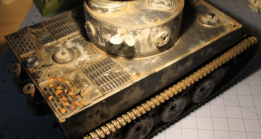

After the current conversation and in light of the newer guys and questions regarding building and mods, I decided to snap some photos of mods I have done or are doing now. Mostly Tamiya, except the Eduard and Trumpeter conversions.
I hope this give you guys some ideas or at least starts a conversation.
Ask any questions or add photos of mods you have done, this thread can go anywhere it wants.

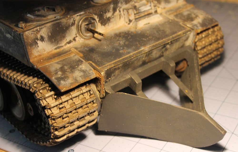

First up, the Initial Tiger. The earliest few Tigers had no fenders, tow cable mounts or air cleaners, limited tool stowage, steps sights for the driver and no escape hatch. I added the pistol port and couldn't resist the snow plow. The plow is fully functional, pivots in the tow attachment holes just like the real one, Ijust haven't weathered it.

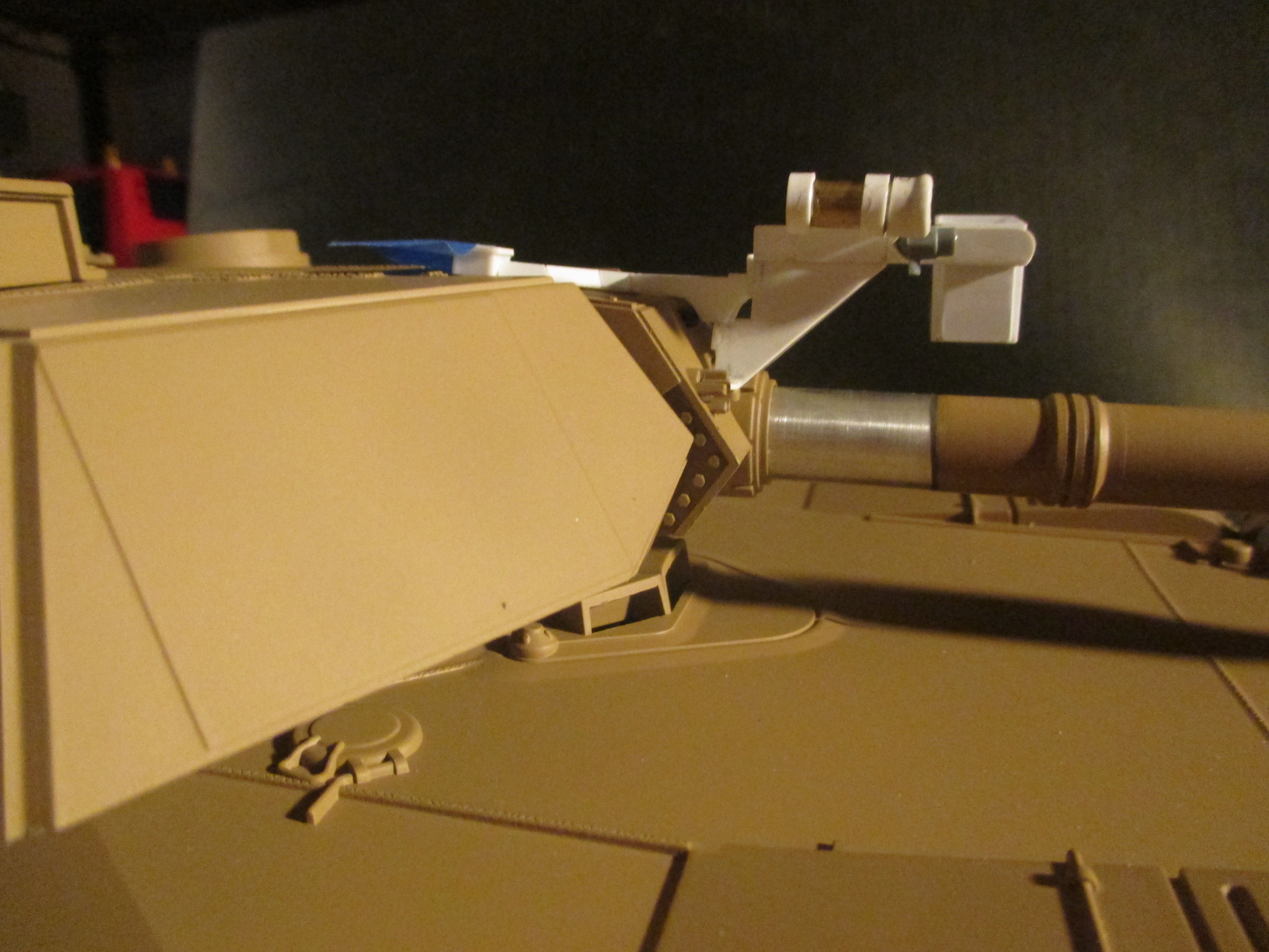

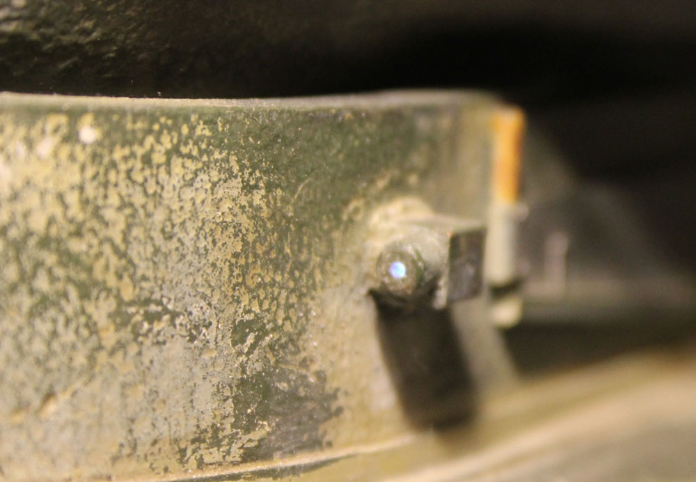

Second, JS-2 lighting, texture and details.
I couldn't let the brake light function on the MFU, so I added LEDs to the nav markers. I'm not sure if the rear ones were red, but what the heck...Also added the turret seams, footholds, tarps clips, etc. I made the decals of the Pravda School from Girls Und Panzer to fight along side my son with the T-34.

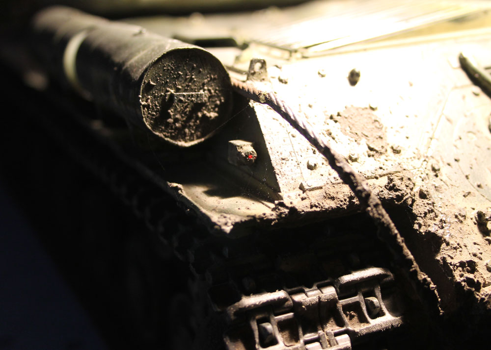

Third is the Pz IV.
Convoy light, zimmerit and Thoma Schurzen:

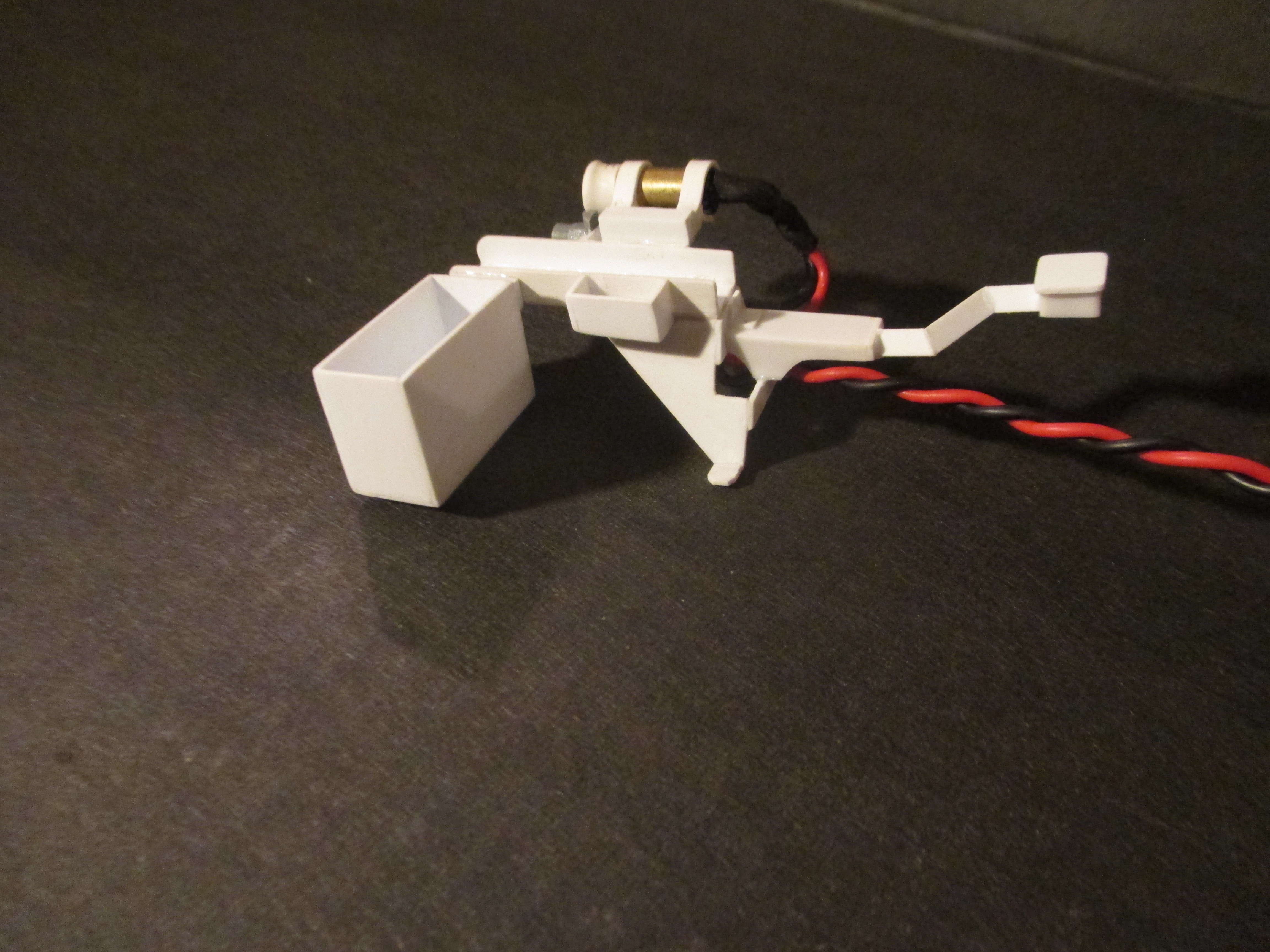

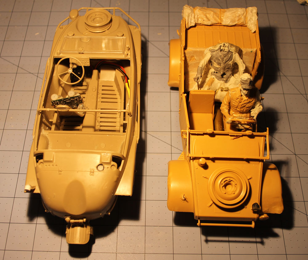

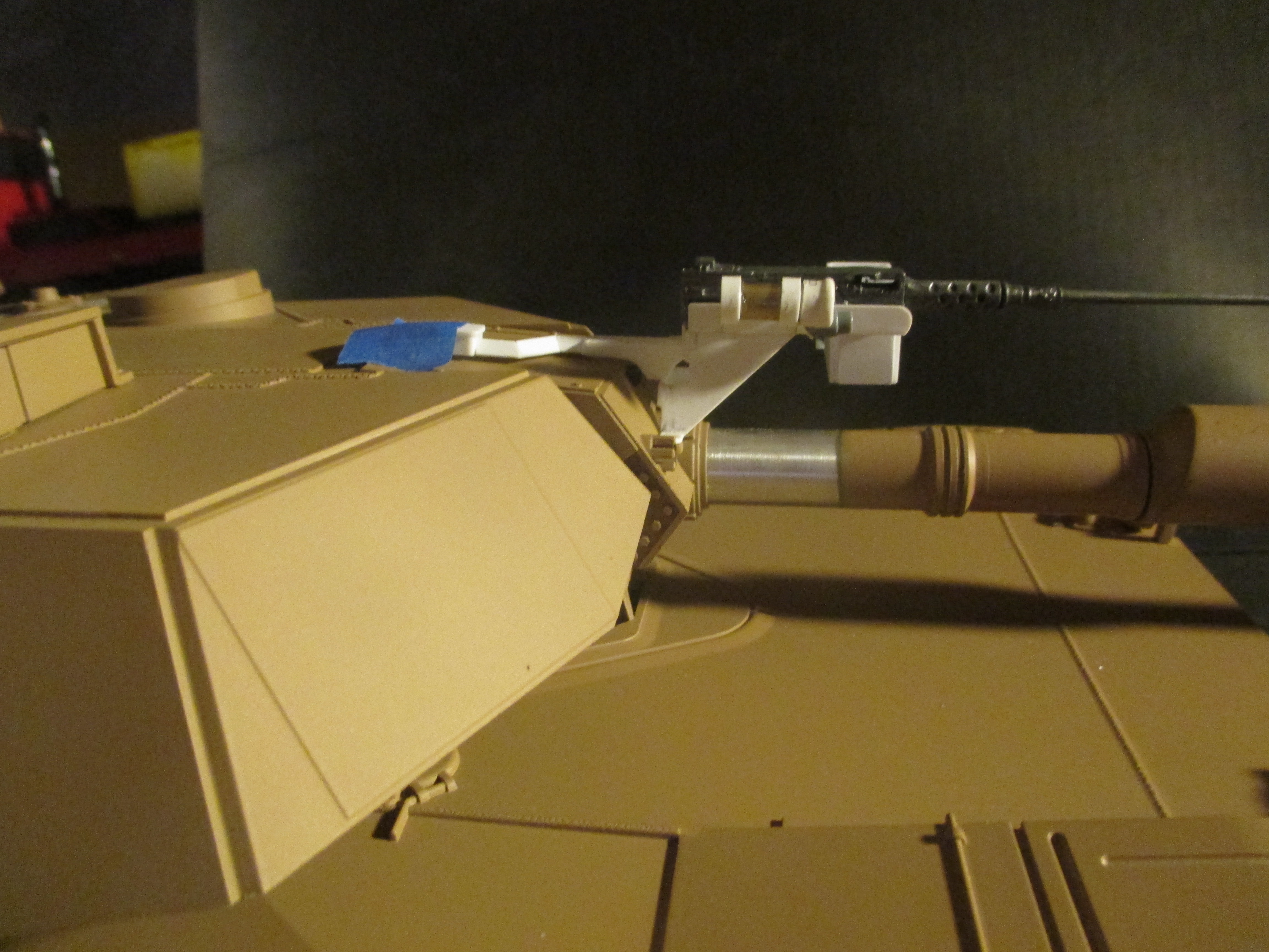

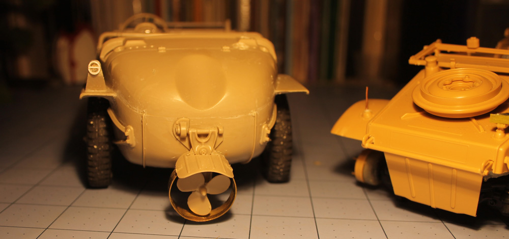

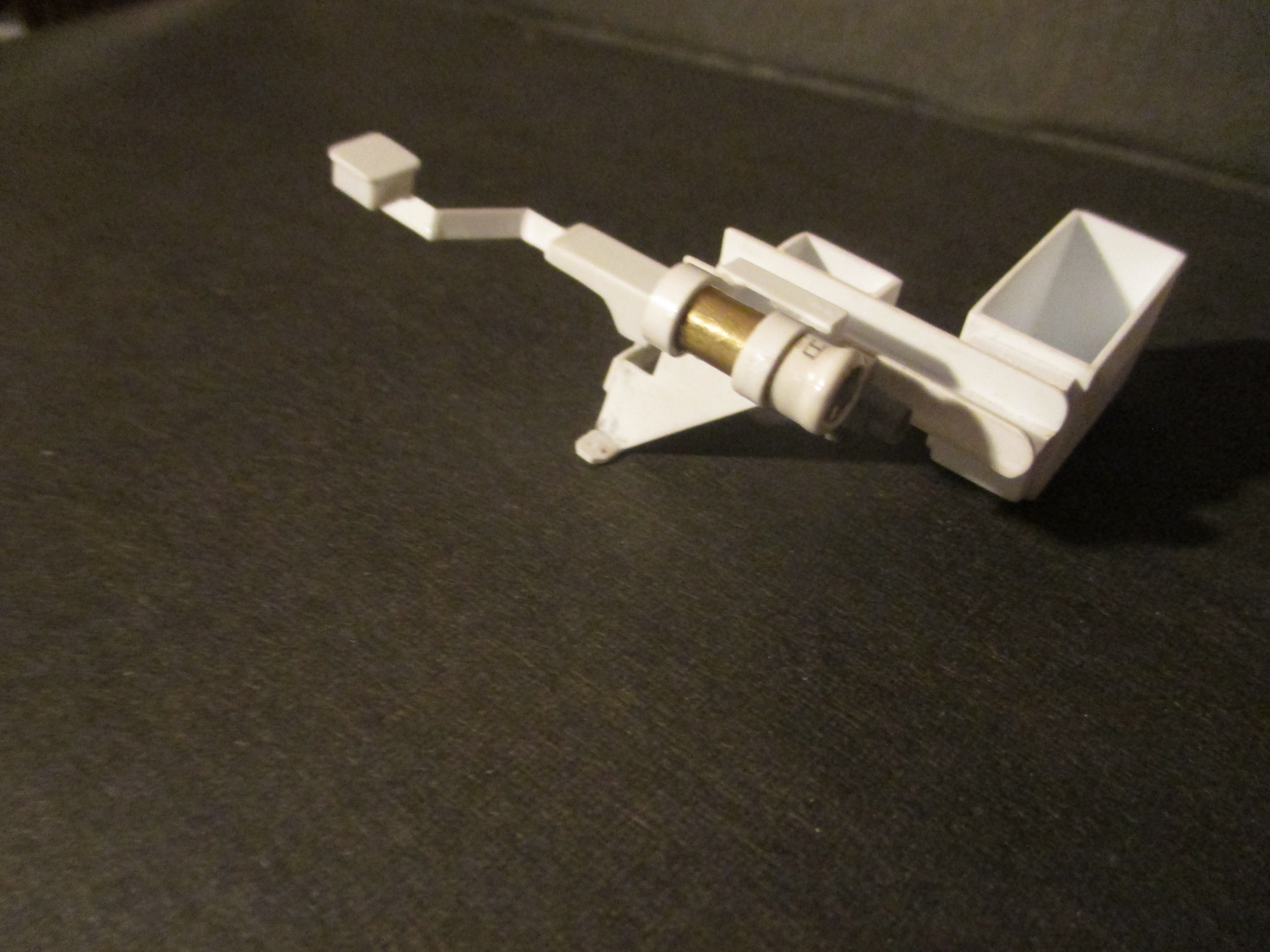

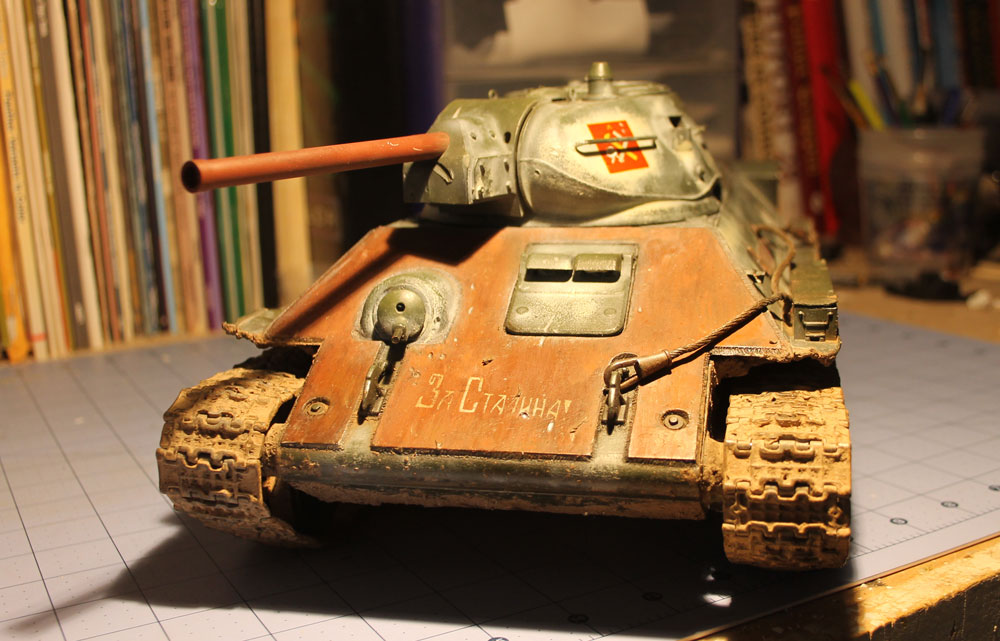

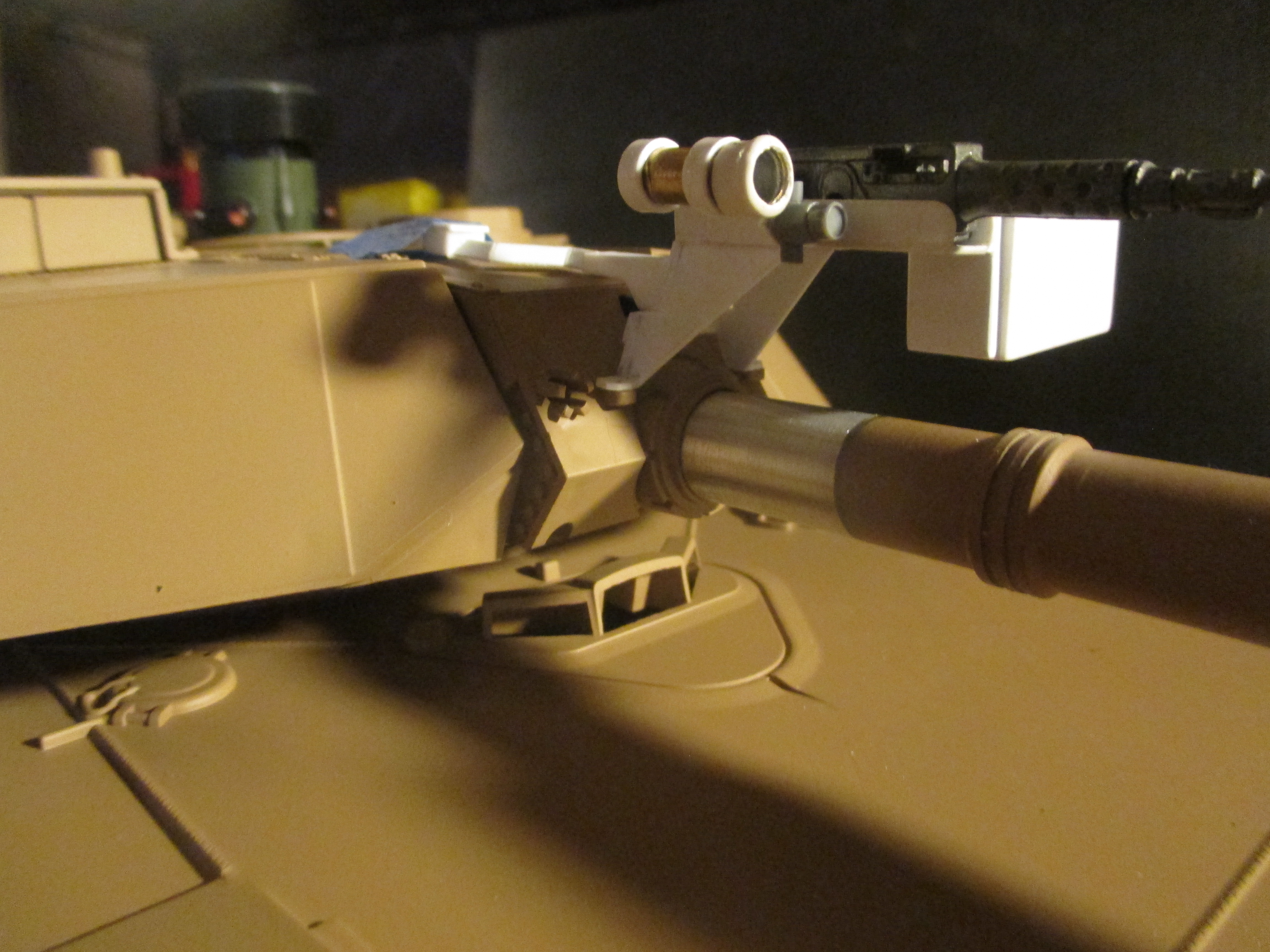

Last is full conversion from static kits.
Trumpeter T-34 with Tamiya electronics, servo recoil and a aking MG gun with Turnigy delay. Hands down my best battler.
Eduard Schwimmwagen and Tamiya Kubelwagen, both 4WD and working Notek and convoy lights, the Schwim, swims using a small helicopter motor built into the prop housing. Moves pretty fast, I just need to time test since the prop runs on a 1c, I don't won't to get LVC 100 yards off shore...Both will have animated crew, the Schwim's steering wheel pivots with the wheels, so the driver's arms will be articulated like the Kettenkrad.

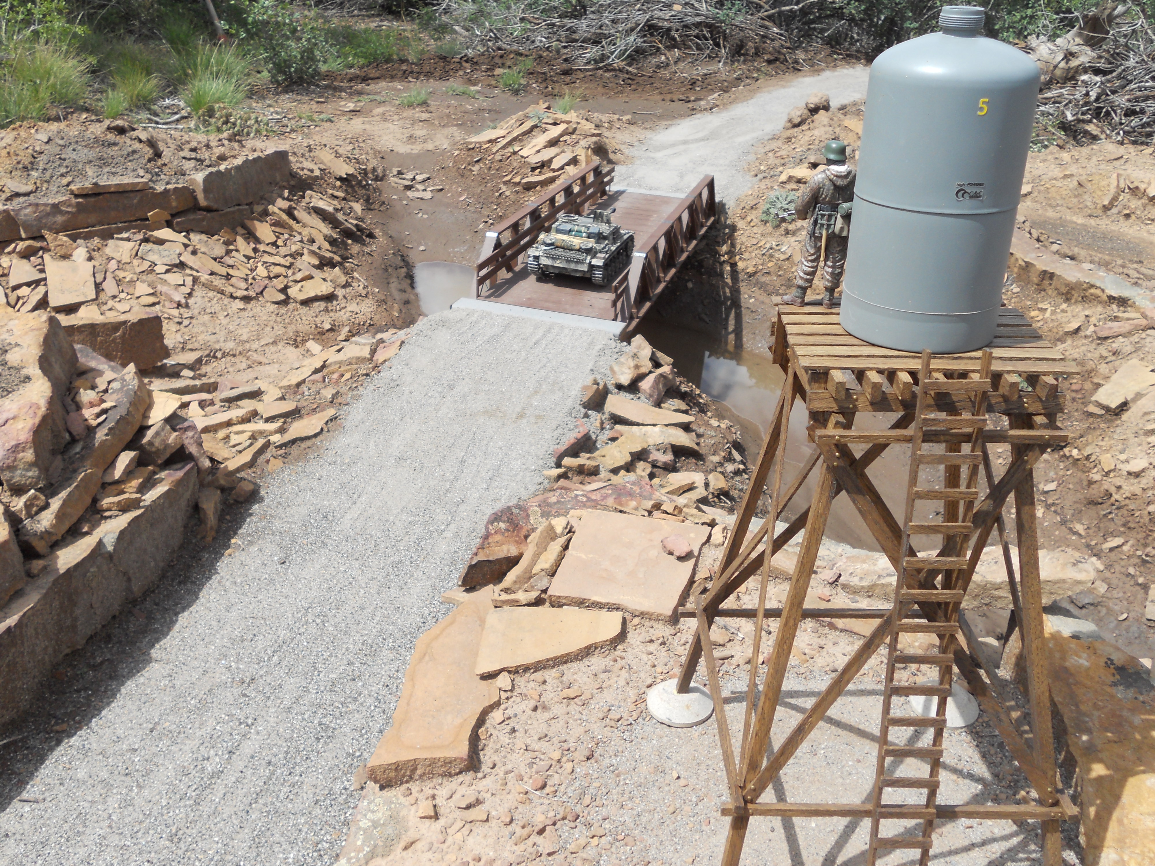

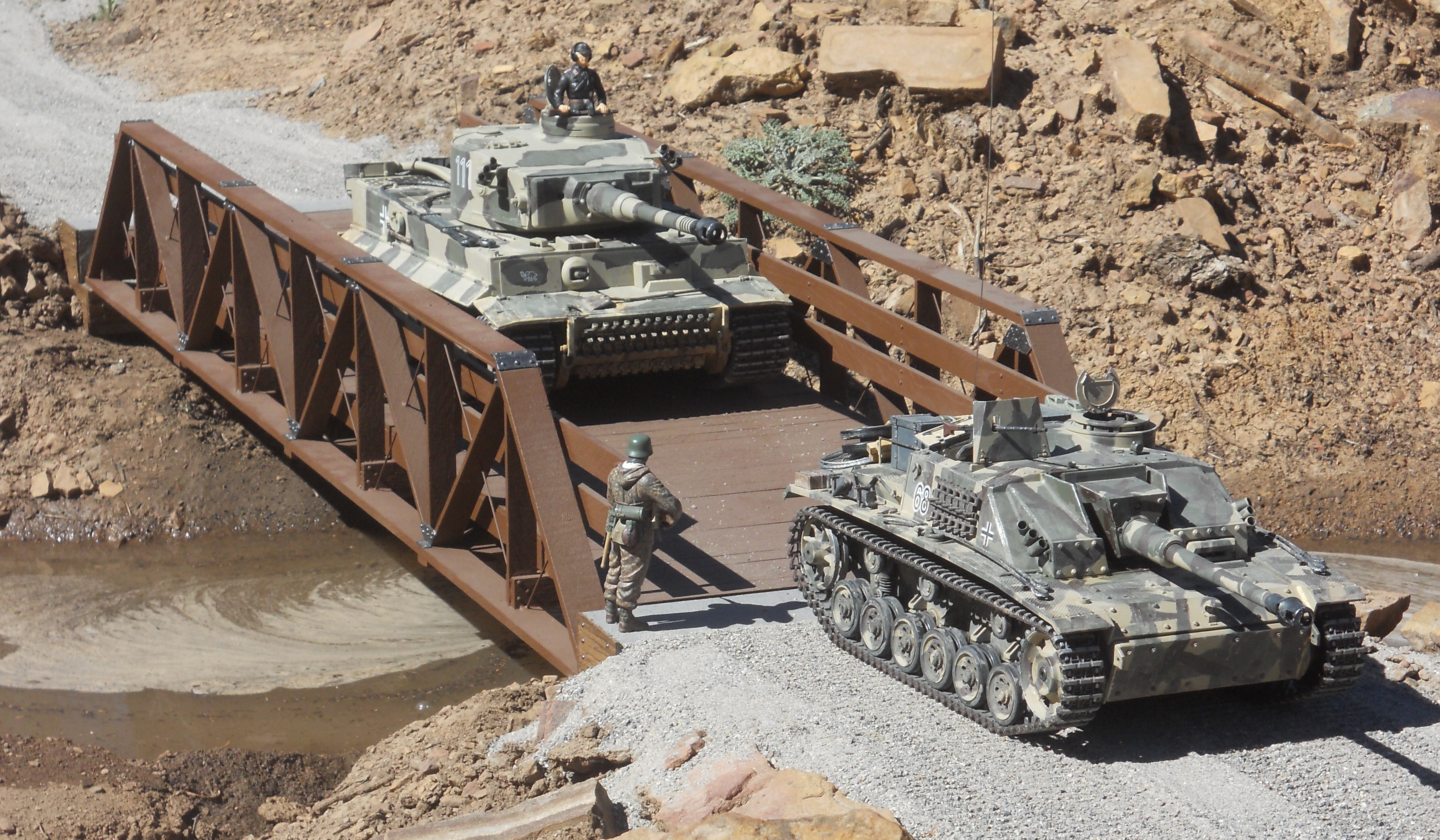

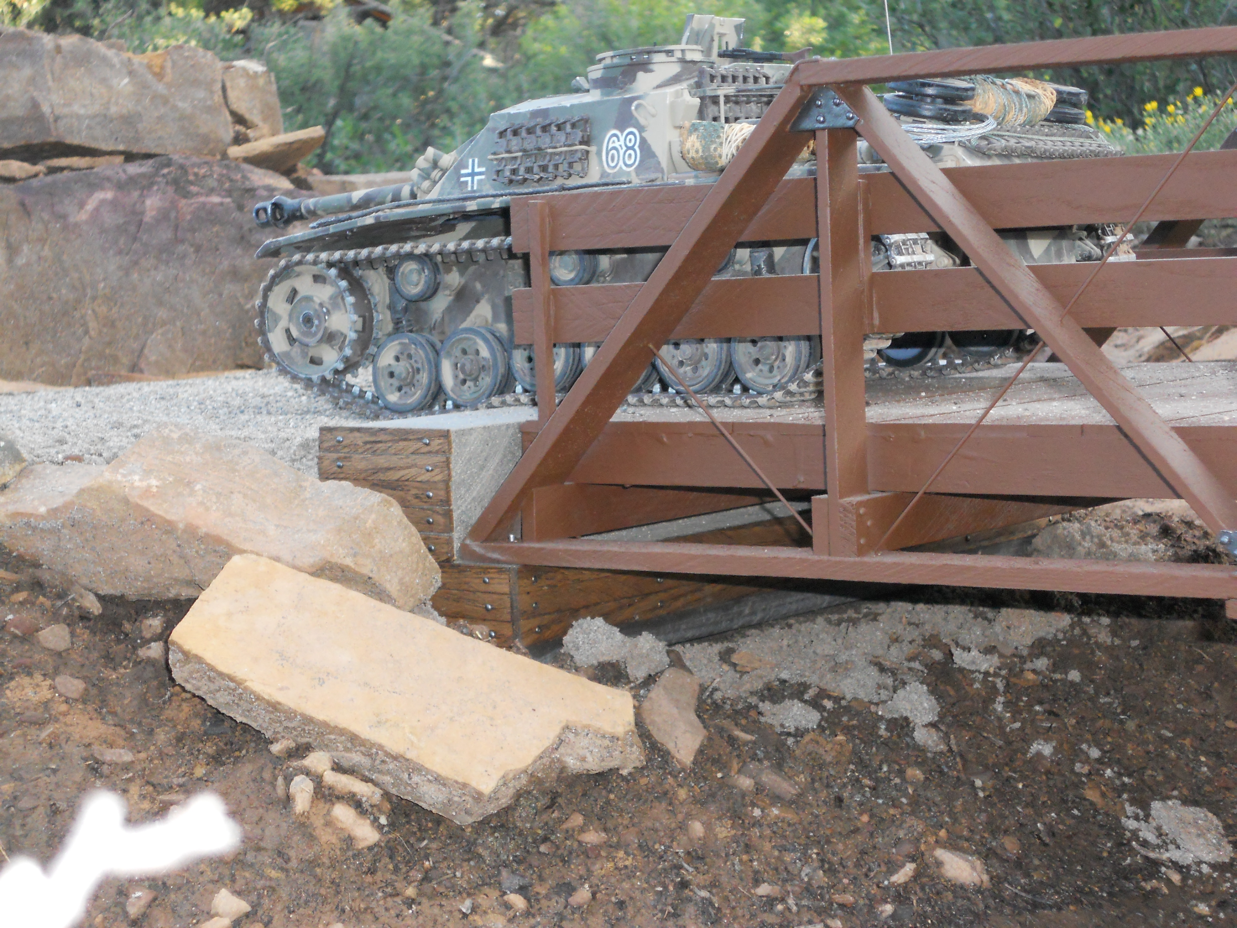

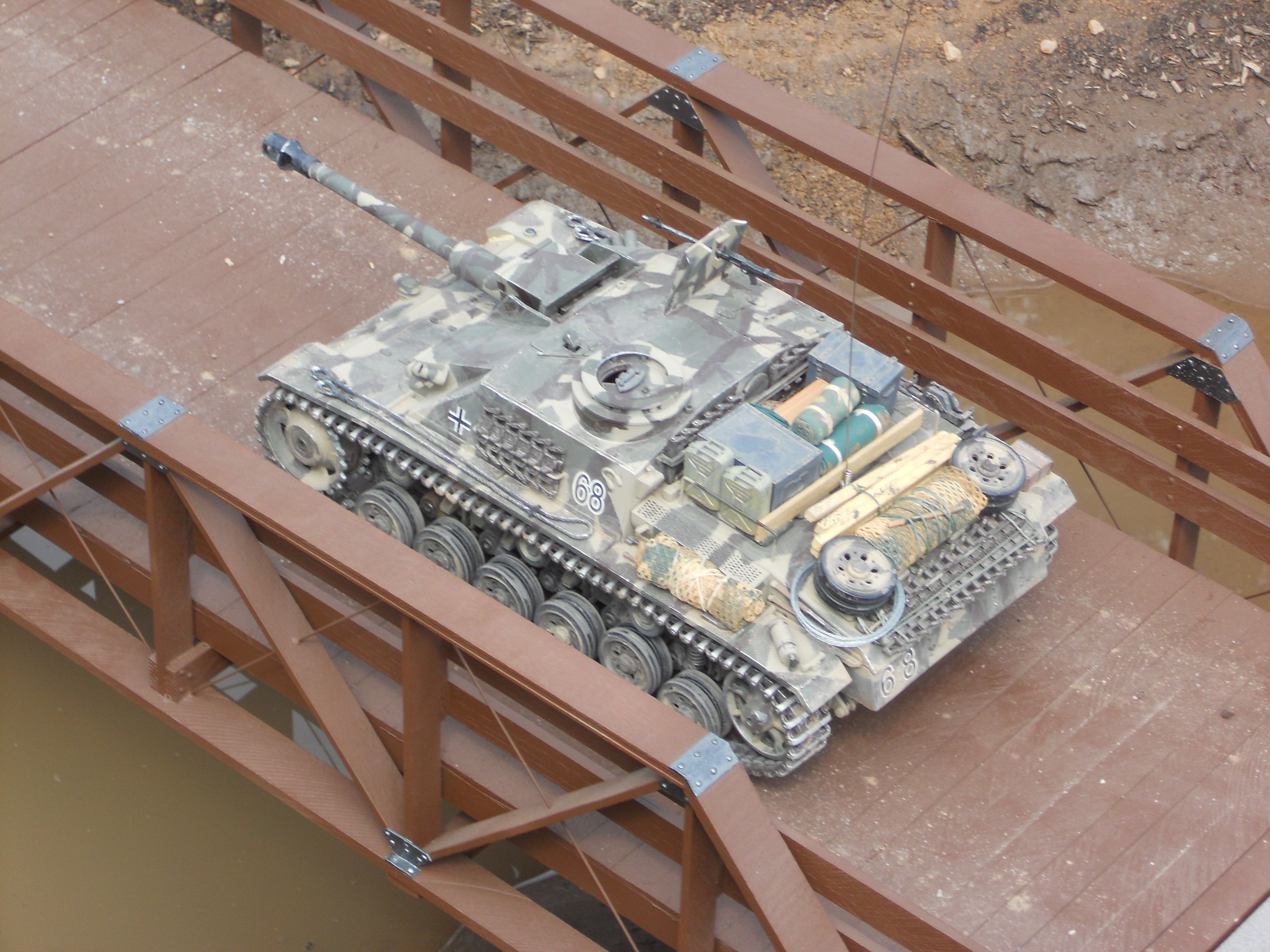

Well the bridge seems to have generated some interest.
Here are a few details:
I scratch built it several years ago.
It is all wood except the steel wire tension rods, the brass tacks used as rivets, and the cardboard used for the “steel” gussets.
All the lumber is to scale in width and thickness.
I only used 8 pieces of wood that run the full length.
It is 4 feet long, a 64 foot span in 1/16 scale.
It is a Howe truss design, a pony truss without top bracing.
Only wood glue “Elmers”, was used to hold the bridge together, the 360 rivets are decorative.
I have load tested it to 70 lbs in the center with no measurable deflection.
It weighs less than a single 2x4 the same length.
The design is intended to look like a bridge from 1900 to now.
I built it as a prize to capture or hold in tank battles.
It was a very fun build.

This weekend I put this together. It's a 50. cal mount for the extra .50 that some Abrams have mounted on the mantle. I just got an Abrams fixed up by Dan at Battle Armor and the IR emitter is mounted in the mantel just above the gun tube. I wanted something a bit more cool looking than that so I scratch built this machine gun mount to cover the LED plug and show a bit more pzazz. I cut all the parts to eye just looking at photographs of real ones. I put the IR LED in the place where the spotlight is on the real tanks. Just like the real ones, the .50 cal can ride in the mount, or not, but the IR LED is always ready to shoot. It was a fun build.
This is not ready to install yet, I have other mods to do before I glue on all the add-on's and paint the tank.
