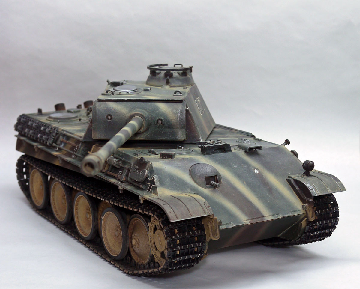

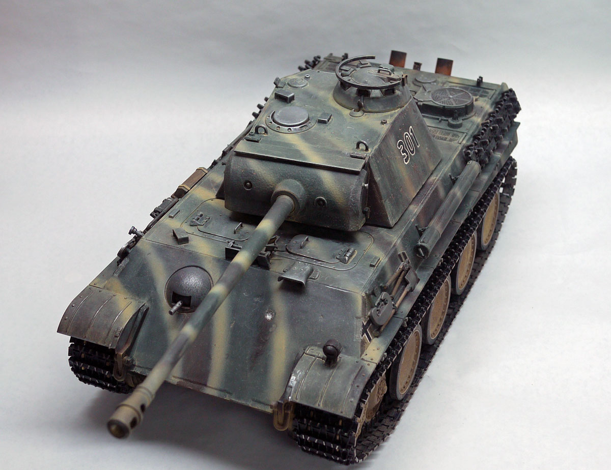

I just finished up a Taigen Panther for a customer. This one came from Germany with the metal torsion bar suspension, bearings in the metal wheels and metal turret. Also had the 4 shaft gear boxes in it.
It turned out to be a nice base tank, which is the point of the post. These Taigens cost more, but you get more as well. Also I liked the roller bearings they put in the turret. As you know I used to use the 6mm airsoft rounds to add this to my tanks, so by Taigen doing this it saves me the trouble.

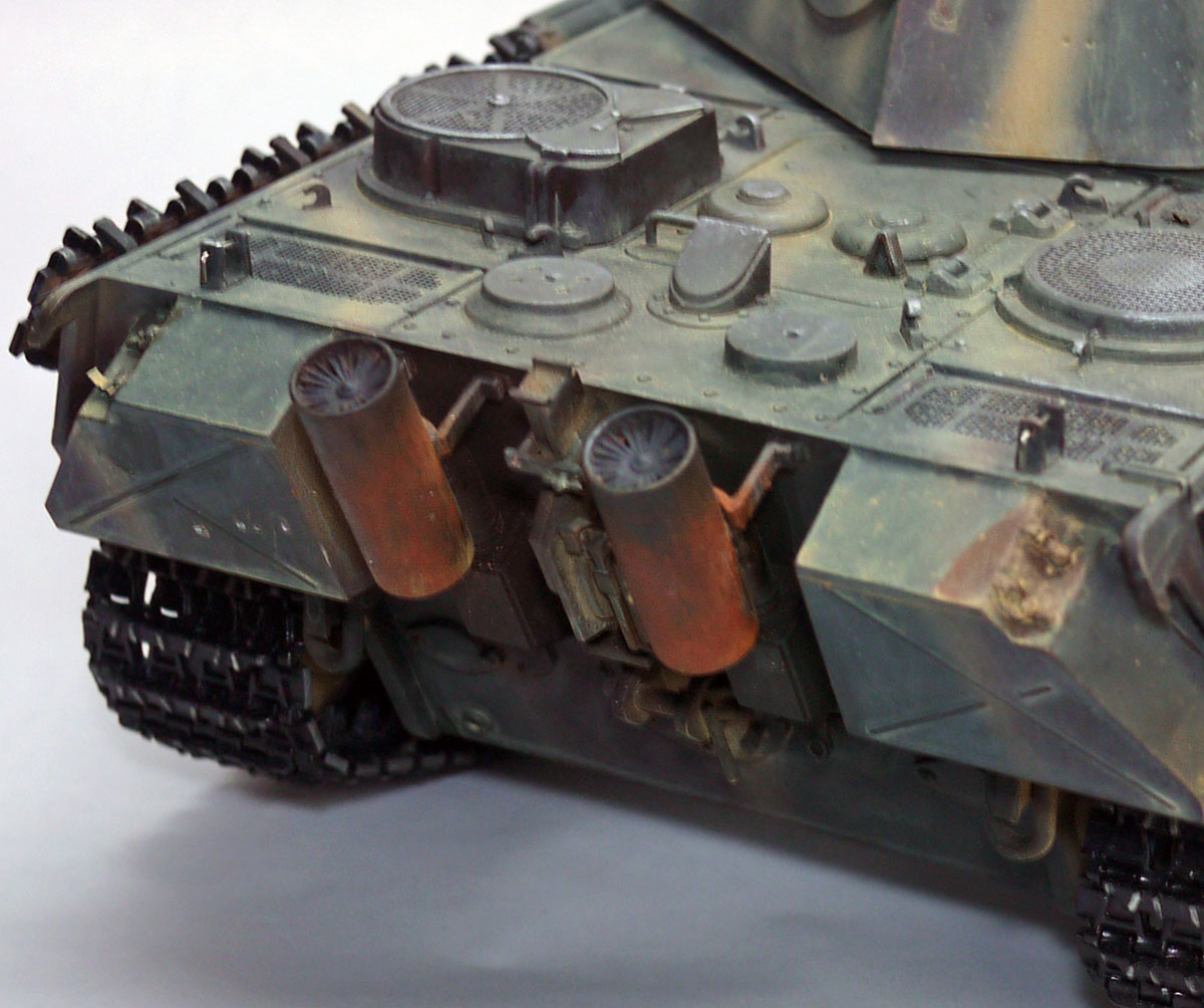

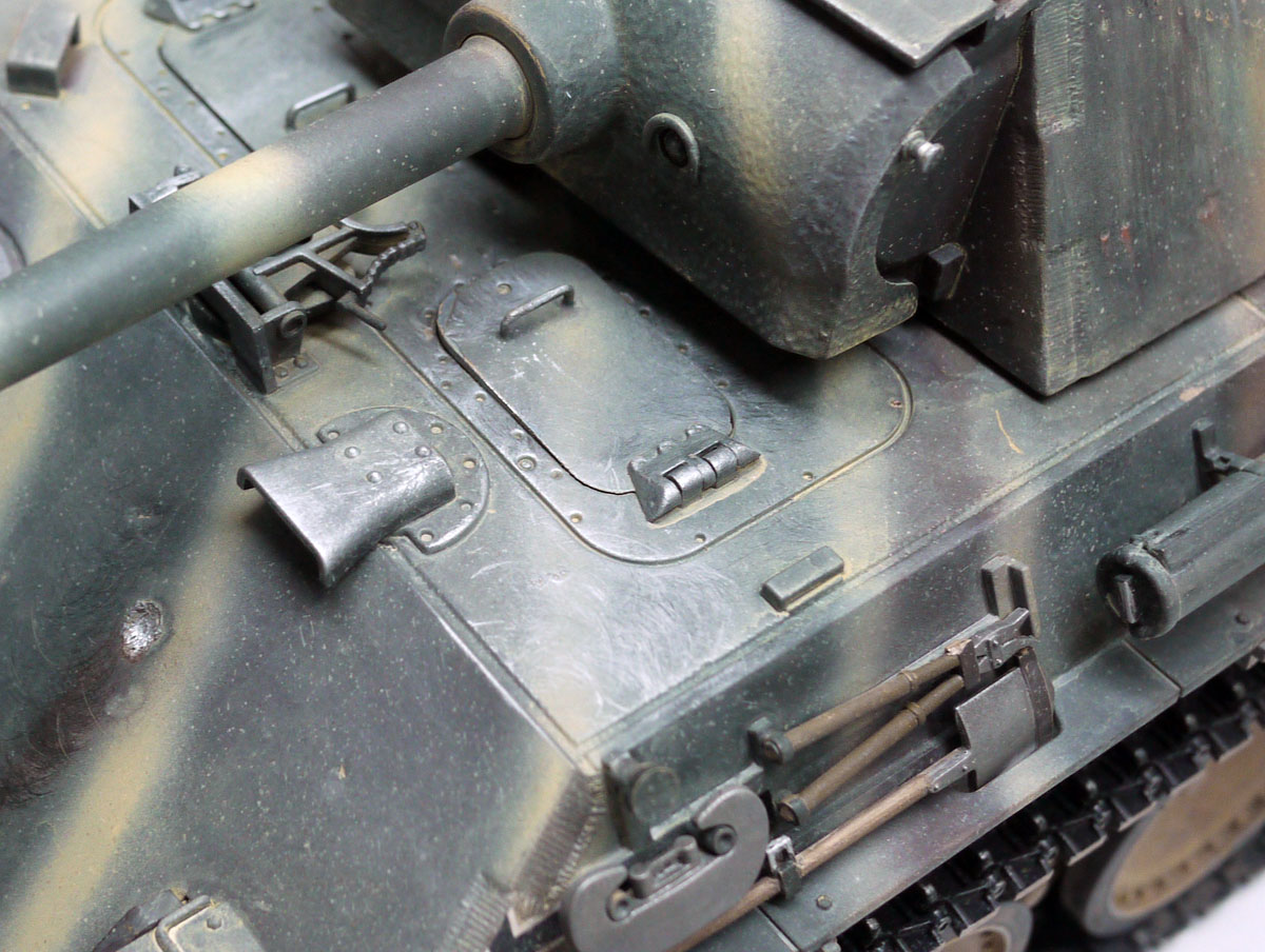

Paint was OK, but I resprayed parts of it as the Taigen painter got a little carried away and almost obliterated the base yellow. Customer wanted a heavily weathered tank. So I gave him a battle hardened tank, but not derelict as my thought is these things were built, rushed to the front and destroyed in less then a couple of years. They hardly had time to rust. The exhaust shrouds being the exception with the heat and thinner metal. Wear areas have seen the paint wear off.
This tank got a paint job, and basic weathering. I added the rear clasps on the back toolboxes for the customer, but the rest is pretty much stock.
Electronics are BARC4/TBS. This particular customer is quite familiar with the TBS and generates some real nice sound files of his own. He sent me a dynamite Panther file he did up.
Everyone likes to see pictures so here a some with the customers permission.

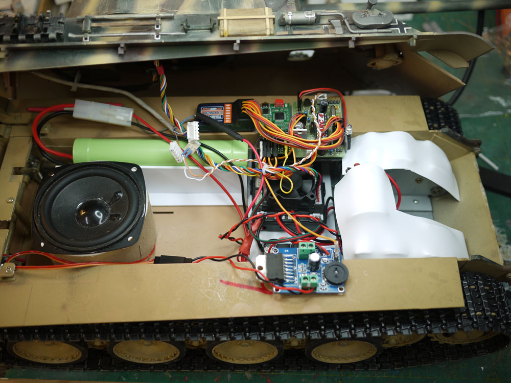

inside this is a typical Asiatam torsion bar insert. I had to change the battery position, and mount the battery standing on its narrow side to allow room for a 3" Visatron speaker
All the electronics were removed and then reinstalled with all the electroinics in the front of the tank. This has a 15 watt amp and power invertor to drive the amp with 12 volts
Taigen have the power switch and volume control on the bottom of the tank. I wish they would rethink this. These European ones also have a charging port wired in( Located underneath the rear end tool box)
Also I added vacuum formed plastic gear housing guards to keep the lube oil out of the rest of the tank

Looks good! I'm always looking for ideas of what and how things get mounted inside. How many ohms and watts on that speaker and what did you use for the housing?

Cool...thanks for the info. What did you make the speaker box out of?

There would be 7 watts going to this 8 ohm speaker, The housing is an old empty packing tape spool. Works good with these speakers in tight installations
The owner uses an acoustic smoke machine so the extra room will be filled up with that installation, and that is why it was imperative that I found a spot for the electronics up front. The acoustic smoke machine speaker will be hooked up to the the other side of the amp

I agree that controls on the bottom of the tank are no good. Would feel much better not having anything on the bottom that could get wet or take a hit. Had a corroded power switch on my JP, same metal hull as your panther I think. Relocated the controls and fit a piece of scrap plastic in place of the bottom plate. Not too difficult.

Is that a RX18 with a fan on it? I wasn't aware they had fans or they could be equiped with fans??

I used the fan off of the Taigen MFU an just added it to the RX18.

The metal tint or sheen to the weathering is really good, very realistic, what did you use?

Nice rebuild Dan. Weathering is great, I like the used but not abused look. A little metal shining through. Was the cast effect something you added to the mantel and MG Kugelblend?

This is an old thread. All I did was add some details and weather the tank. I don't think I added any casting details, but honestly can't remember. To metalize the paint I use a drybrush technique using silver paint with a soft metal brush in a drill.It gives the paint that look to it, and ends up making the whole tank seem heavy.
