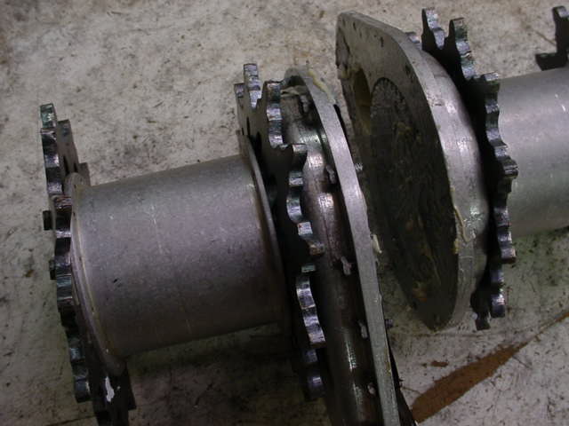

On opening the box I found that the sprockets on BOTH SIDES had been badly BENT. If it would have been ONE side that's an 'accident' but BOTH sprockets? I have been 'slightly perturbed' and 'mildly angry' as you can imagine these past two days. Fuming and depressed.

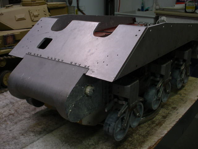

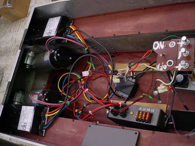

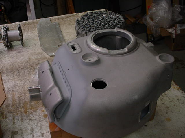

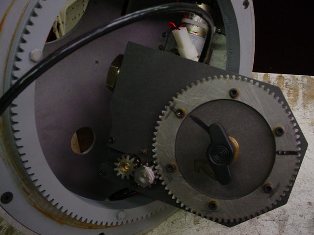

It's cold out in the garage so I haven't did anything with it so far. But I wanted to show ya what's out on the bench now. I haven't even opened other boxes/bags to inventory yet. I'll post more later on when I get around to messing with it.

What are the sprockets made of? Will a magnet stick to them? If you don't get any relief anywhere else I could probably straighten the sprocket with a press and then dust each face in a rotary surface grinder, but it will be a lot easier if the parts are magnetic and not aluminum or something. It can still be done if it's aluminum, I'd just have to make a fixture to hold them for grinding. And don't worry about reducing the thickness, I think I can straighten them enough that I'd only have to take about .020 off each side. So keep that in mind if you can't find replacement parts, Mike.

Mike, from the look of the damage to the sprockets the case must have been dropped or hit with a heavy force, the must also have had the tracks on as both inner and outer sprockets are bent in the same direction by the same amount, you should also inspect the tracks as I would imagine that the tracks must also have some damage as the sprockets have taken some force/impact to bent in this manner.

THANKS GARY! If funds for new sprockets are approved then I will let you know. The sprockets are thick steel. Now that the adjuster has been here tomorrow I'll take them apart (because I DIDN'T want to 'disturb' the 'crime scene' so I left everything like it came out of the box.)
And yes Rivetcounter, the tracks that came over the sprockets (where they were pinched) had damage. A couple of guide horns had been broken on one side (and I haven't looked closely at the other side). I KNEW I'd have to order a set of those '10 Sherman Sprockets' special that's on the Armortek main page, because there are only two links and ONE guide horn in this ziplock package.

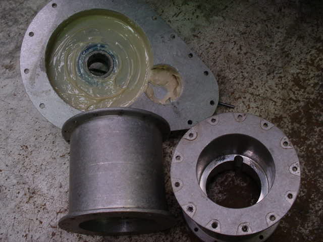

Naw Rudy. I haven't really checked anything yet so I don't know. Since the UPS adjuster has taken pictures, today I took the sprockets off. I know two sprocket bolts are broken off in one of the hub flanges (they're threaded). I quickly (not paying much attention) put the hubs and drive gear housings on my drill press table cause that's the only really FLAT surface close. I'll look closer at everything later (especially until I hear from UPS.)
What really bums me out is all these drive parts are 12 years old and BRAND NEW. Never even RAN!
Later on I'm going to take the suspension housings (trucks), front (HEAVY cast aluminum) trans cover off, and a bunch of other stuff. Heck, I was going to do that anyway so I could paint'em.
