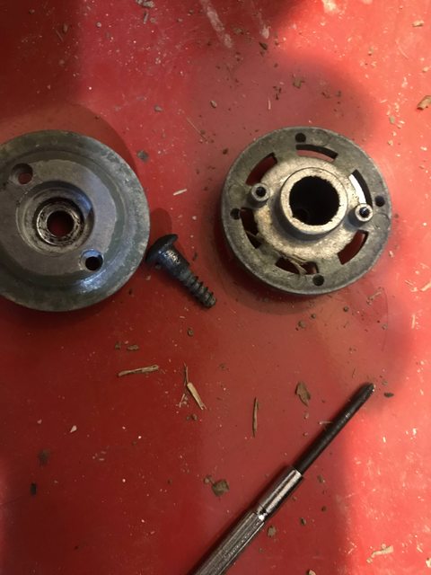

Hello Steve,
please send me your adress by mail or PM, I will send you 4mm axles.
Could you attach photo from your idler wheels here?
You do not have wrong idler wheels, but a plastic tub where only self-tapping screws hold.

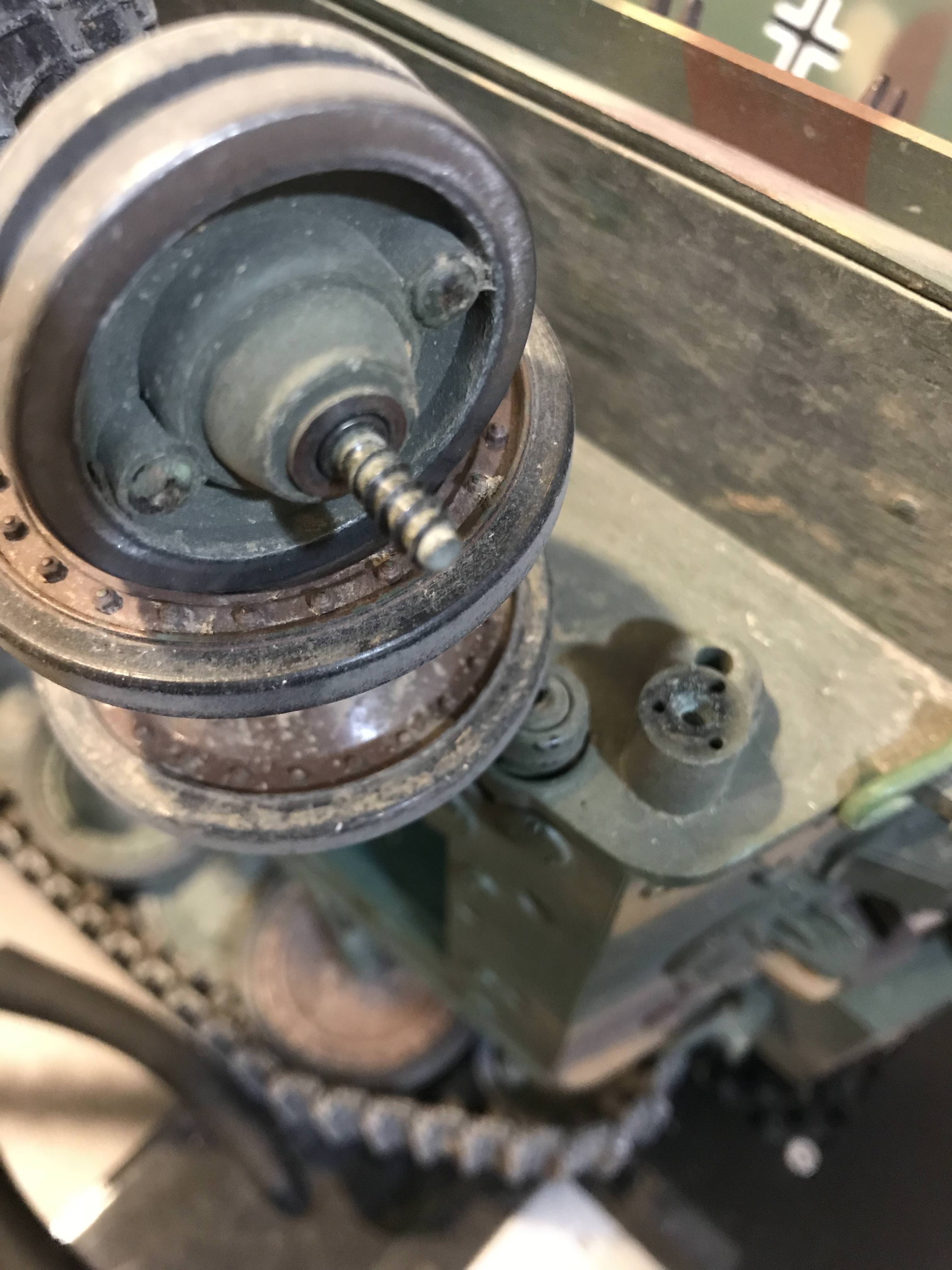

Pulled my idler on my Heng Long metal upgrade tank today. Here you can see what I have to work with:
The screw evidently is a shoulder screw which is intended to provide a shaft for the wheel to ride on. But it is not a close fit and there is substantial play in the wheel which allows the tracks to jump on the idler.
So I assume this wheel will not do with the Hennetec axle?

You need to buy the idler set for the metal lower hull. They ise an axle with set screw like Tamiya does. The stock Heng Long junk uses a sheet metal screw to hold the in place LOL. The ones in the link appear to be right. Make sure they are for the metal lower hull and you are good.

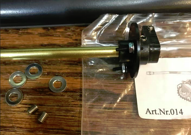

I received my Hennetec axle.
The instructions are in German. Does anyone have instructions in English?
I used Google Translate and it looks decent but I'd prefer clear instructions if they are available. I emailed forgebear we'll see if they have some, too.

Hi Steve,
be happy,because you have bought the updated tensioner. The tensoiner became an update 2016,forgebear had not updated his fotos in ebay.
The installing is with the updated version much more simple and the screws are bigger and more stable.

Hi Guido,
I was examining the item last night, and noticed that with the built-in flange on the outside of the tank, the height works out exactly to the height of the original plastic mounting boss. So I can see how it works without the backing washer.
Thanks!
