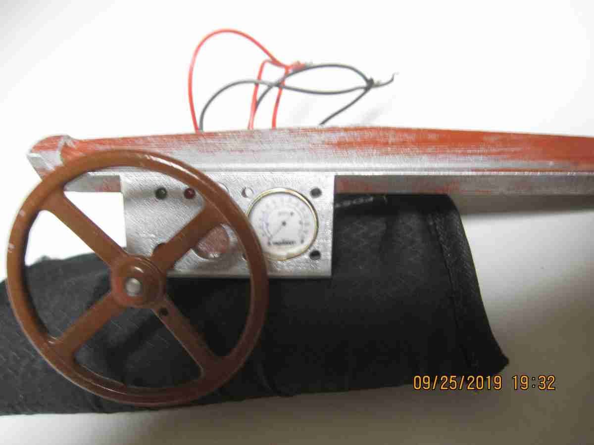

While I'm working on other projects I couldn't resist spending a little time on the dashboards of these trucks.
I've not yet found a photo of a dash of a full size truck so I'm purely just using imagination. Photo documentation on these trucks is scarce even in the Kaelble specific book I have: a few outside shots and that's it. In fact considering Kaelble built a few hundred of these machines for the German Army it's difficult imagine more photos weren't taken. I suppose perhaps the fact that they aren't as high profile as Tigers, Panthers and other all the other highly studied military hardware of the day contributes to the slim pickings for information. Anyway I've tried a few things using small, 3mm LEDs for lighting and photos of vehicle instruments I've massaged into the correct size. Below is a in progress first attempt at one dashboard. Apologies in advance for the poor quality of the lit-up dash photo. I'm still working out the instrument bezels/ rings. My first attempt came apart (as may be seen) while pressing it in place...also lighting the entire dial will be the next trick...
Jerry
