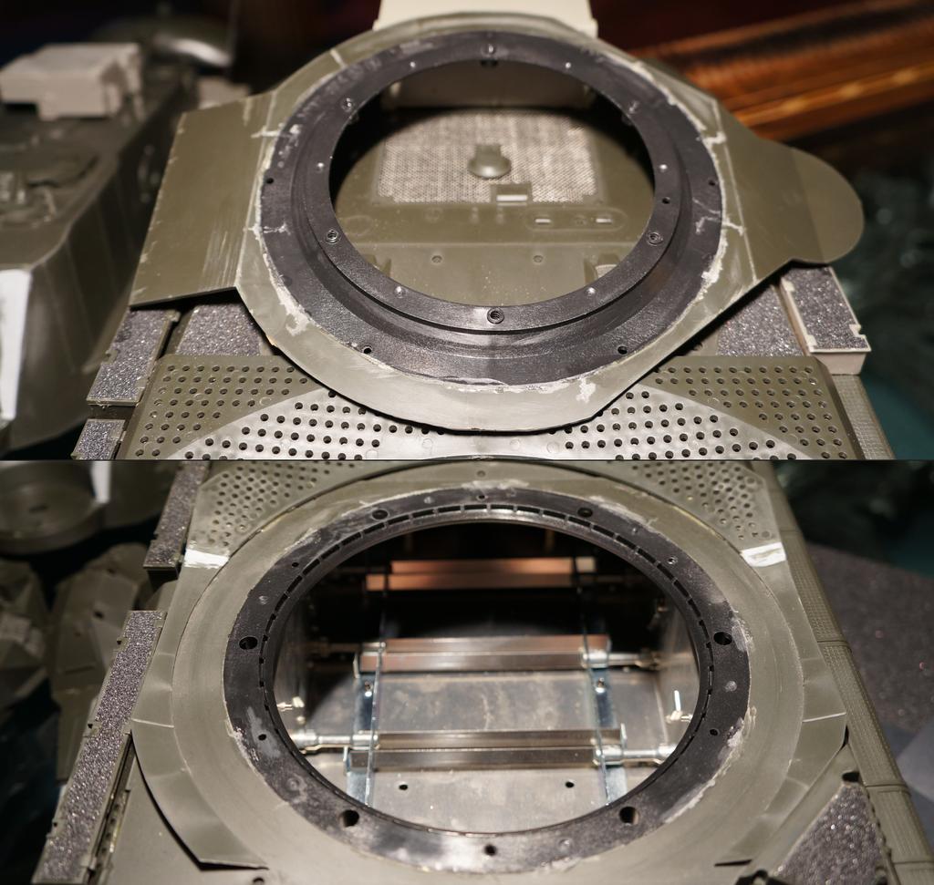

Tamiya has, with the release of the #56020 Leopard 2A6, introduced a Turret Bearing Race you can get as a standalone spare part ( you'll need 3 separate Bags: The 5-Piece Bearing Race, a Bag of Bearing Balls and a set of Tamiya self-tapping Screws ) that is super nice for any build that fits it and was so far also used in the JGSDF Type 10 and M1A2 Abrams - The concept has since also been adopted into the M551 Sheridan and Centurion Mk. III but there it is part of the Hull and or Turret itself and as such cannot be used elsewhere.
I've used it when I turned my Display Model #36208 Gepard into a Full Option Model and with my D.I.Y. E-100: E-100 Fidget Spinner - IMHO, highly recommended!

There is almost no room between the turret and the hull on the 1a4. The turret basically sits on the hull. How did you fit the thickness of that bearing race between your gepeard turret and the hull? Did you cut out the bottom of the turret to install it?
On my 1a7 build I glued a styrene strip around the hull ring and then cut the tabs off the turret and glued new ones under to allow it to raise up .010" Worked just fine so far.
I cut both the Turret and the Hull:
The respective Turret Ring Parts were mounted flush into the Upper Hull / Lower Turret parts after cutting the original Turret Ring out with the help of a Stencil.
Gaps between them were filled with micro sized glass beads and then Superglued ( after backing the rear with Masking Tape ) together.
Video of it in action:
