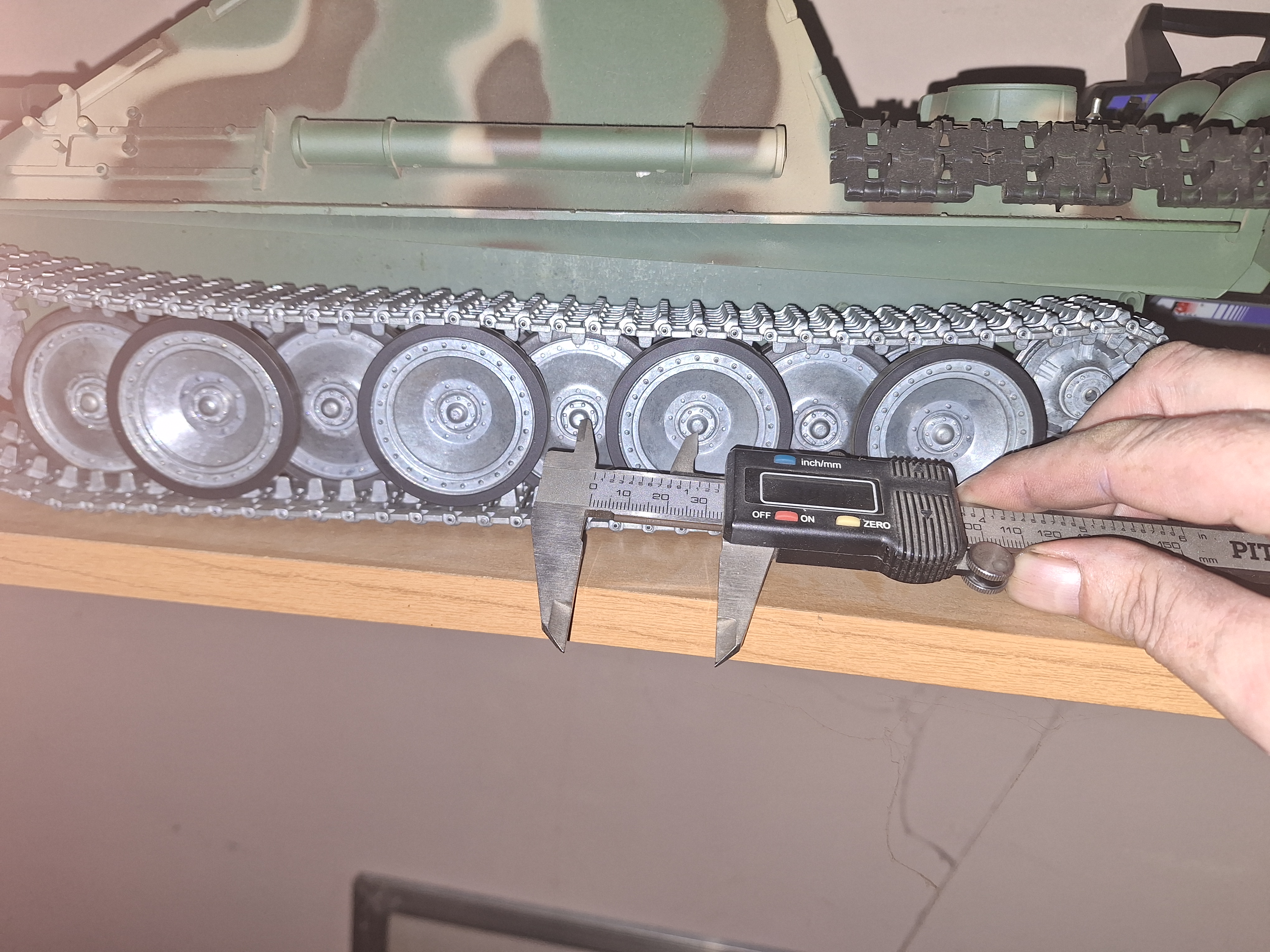

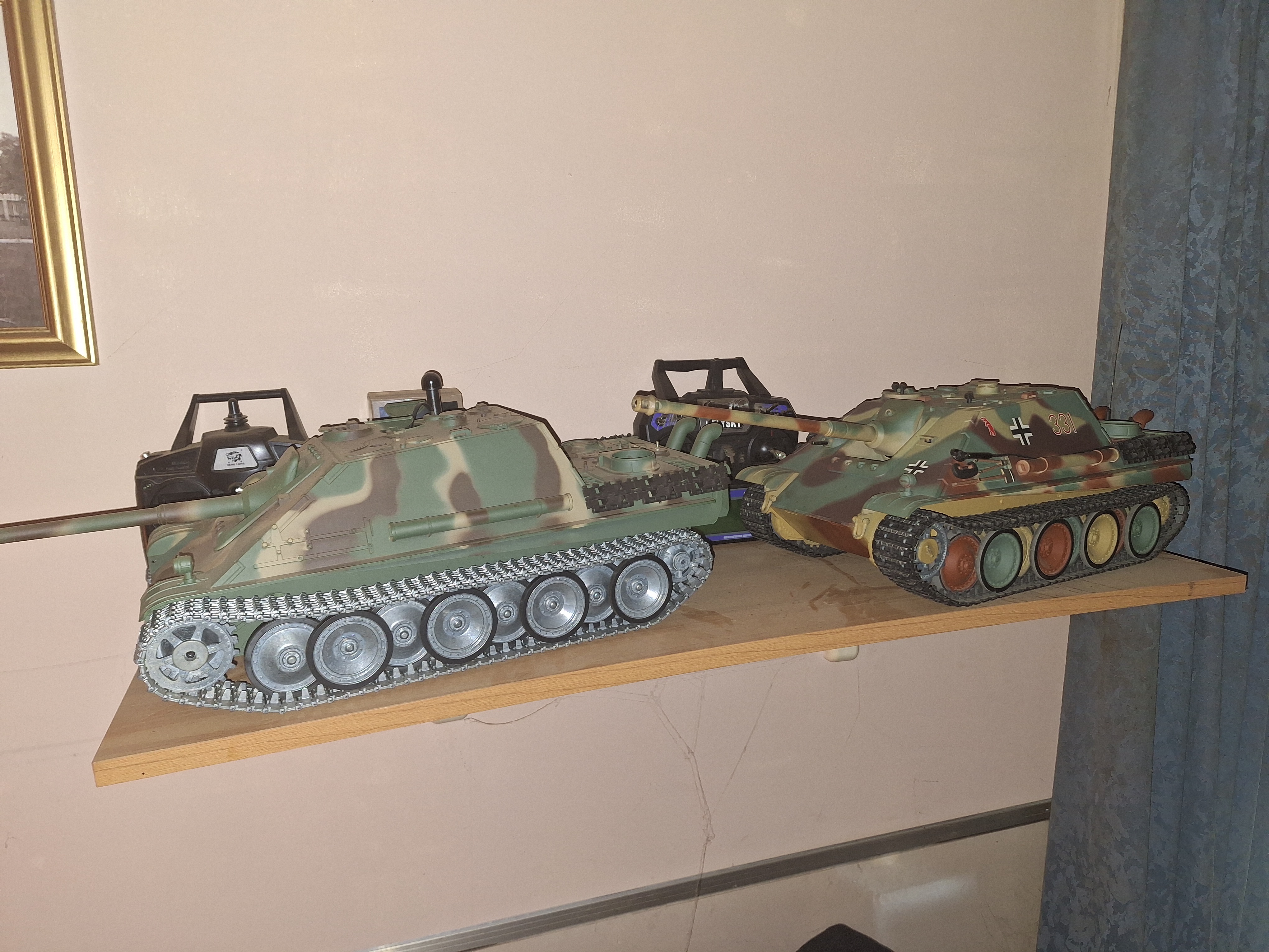

Old 08-22-2023 | 02:27 PM
Joined: Sep 2015
Posts: 4,678
Received 319 Likes on 263 Posts
From: Detroit Rock City
OK, now I'm home so I'm Crius. Can't post photos from the phone when I'm Max.
HL on the left, Asiatam lower on the right, both the same, checked several places down the line on each, 34.1 mm from center hub to center hub on the next, overlapped wheel.
The HL is the coil spring suspension, the asiatam is torsion bar, but they both have the same center to center distance.
