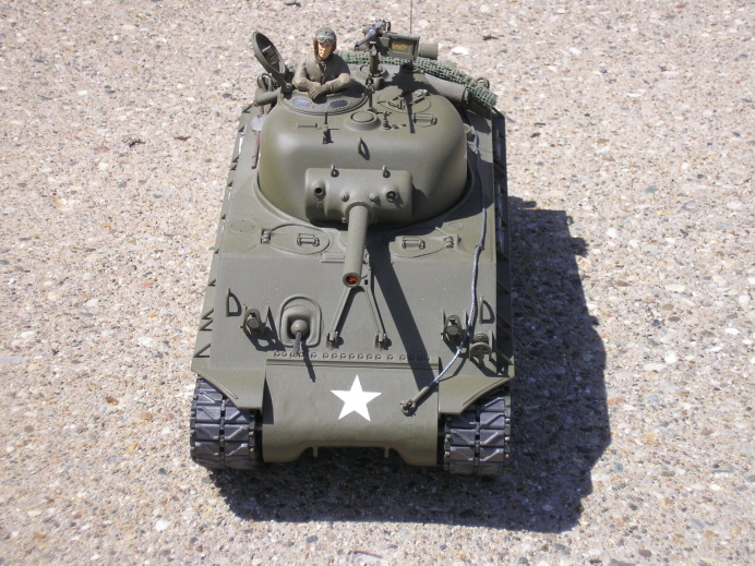

this is fun almost as good as building the first time
