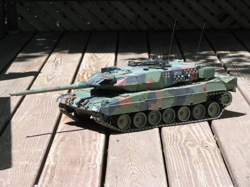

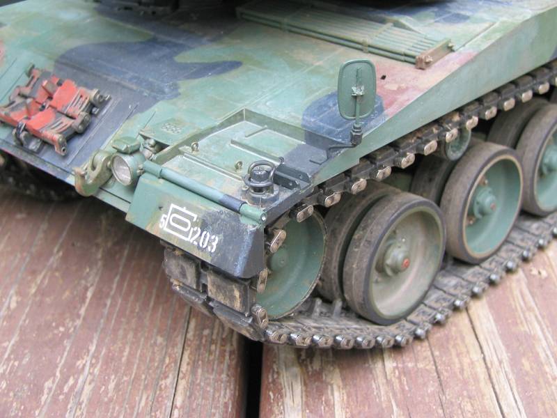

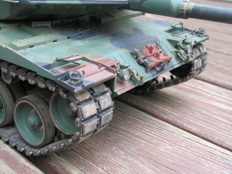

Took it out to an empty dirt lot and weathered it some. Not drastically, but enough.
Didn't get pictures of the actual event, but did take some upon returning and knocking some of the loose stuff off. Also included pictures of how the fenders can be removed and put back on. It's not 100% to the real one, but it works and doesn't distract from the overall look of it when they are in place.
Might have to find a better rust color for the spare track block. [:'(]

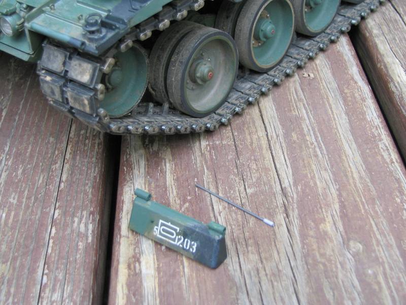

Once again, superb job on your L44 gunned Leopard; you certainly have great modeling skill, I like the removable front fenders, nice touch of realism[8D]
Man, I have been busy, hope you had a nice holiday weekend Cap, now down to business, I took Leo no 1 to this little area I found, the dirt is excellent, small granular and soft, perfect for scale tanking except for one thing, debris http://www.pbase.com/calvinwill/leo_repairs&page=all
It got all caught up in this plastic webbing, the webbing wrapped around the rear suspension arm and wound up breaking the arm, this is the first time in over a years worth of running anything broke on the suspension, no problem, it took me all of five minutes to replace the arm with a new one.
Let's talk about this for a minute, some people might think metal arms are called for here, I disagree, those stock arms are very tough and durable, it took a very tough piece of plastic webbing which wrapped around and then was forced by the drive sprocket to break the arm, a rare and unusual situation. Now some people can go out and get these http://www.afv-model.com/4711shop/pr...nfo=p255_.html for about $105.00, I would much rather go to Home Depot and spend $15.00 for a dirt rake, which is what I did. I plan on raking the area and getting the garbage out of the way before any more human debris damages my tanks. Those superb battlefields of Der Junge and Schoppy, along with the BTN and various battlefields didn't happen by accident, they were carefully manufactured for use by scale model tanks.
You gave me an idea about those side skirts, at first I took mine off so that if debris gets caught in the tracks, I could just remove the junk, and keep on motoring. Then something hit me, leave the screws which hold the skirts in place partially out, then you can both remove and add the skirts at will, scroll thru the photos and you'll see what I did.
With skirts in place I ran for about 15 minutes with no ill effects, the skirts held in place. This is still experimental; I'll keep you updated. You'll also notice I cut out the rear skirts.

Thanks, Will.
Making the fenders removable was something I had wanted to do since I built it. They are surprisingly tough, but I wouldn't go running them into anything and expect them to stay there. Also wanted to make the skirt mounting plate details and such, but I think I'll just leave them off, so I can keep the option to put the skirts back on.
As for your Leo's accident, that's too bad. Good to see it didn't tear it up really bad and that you got it fixed. That looked like a hefty piece of webbing.
Interesting deal for making the skirts removable, without having to take the hull top off to remove them.
