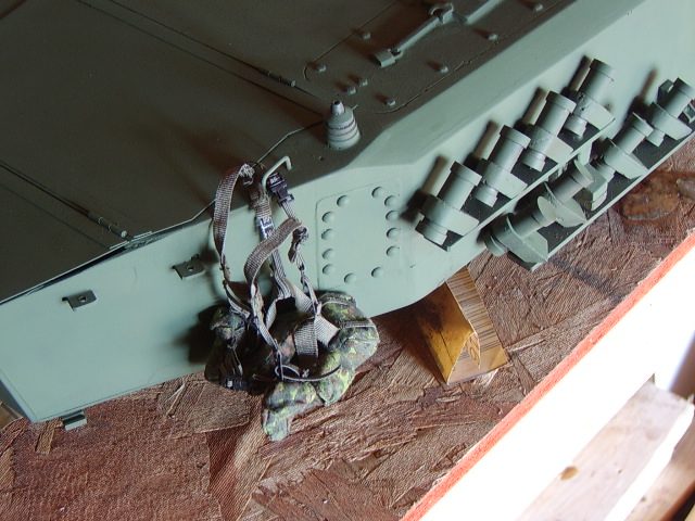

As you can tell in the above pics the colors on the paint were way off. I overlooked the model more fully yesterday and noticed some small cracks in places, with sink marks and high points oin others. They have been filled and sanded. The really fine detailing will have to wait until spring when its warm enough in the garage. For now though it will be getting repainted in the correct nato 3 tone color scheme. I have the vehicle base coated in nato green now. Waiting for time over the weekend to get the other 2 colors on.

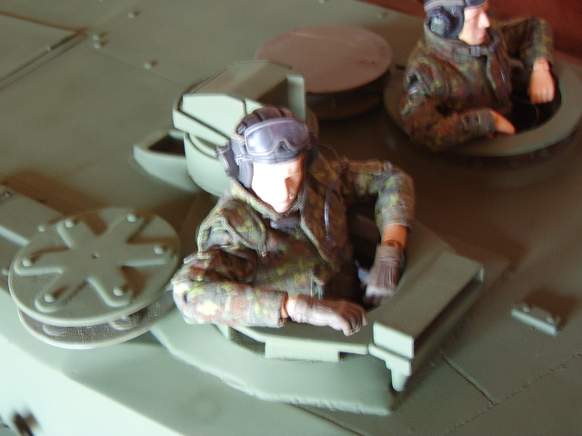

Heres the pics as it sits now.

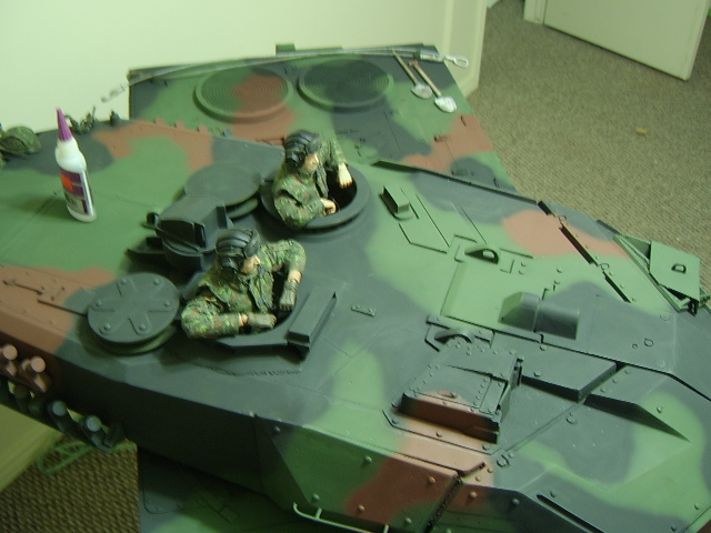

Heres an update of the paint work progress. References for the camo were taken off pics of the real vehicle online. Colors used were tha Nato colors by tamiya. They work perfectly even in this scale.

Wow! Cool model. Nice work with the figures. Verio; (www.tankmodel.com) makes a really nice MG34 in 1/6. It's hand made metal and he's probably proud of it, but it looks great. I'm still shopping for an MG for my (little) Tamiya Leopard 2A6. I bought a metal piece, but I'm concerned about it snapping off of the plastic skate ring.

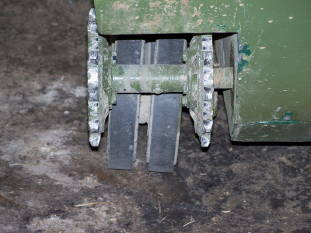

Well lost the good pics of it outside since that camera took a dump on me. But i do have a new camera AND have found the source of my recurring track snapping issue. A bent AXEL. look for yourself. The bottom of the wheel goes outward and the front face of it goes inward. This is whats causing the twisting and torqing to make the tracks break.

ya that would definitely do that. now, how does that warranty work?

I show the pics and then he sends the parts. This wheel problem could just be a mis alignment though. I ran out of daylight to check it fully. I may be able to loosen the clamp bolt inside the hull and adjust the angle and tow of the arm to get the wheel straight.

Wow! That road wheel axle's bent good. That would sure break the track. Surprised you couldn't hear that road wheel making all kinds of noise running over the track like that. Unless the volume was up on the sound system, that is.

Actually it didnt make any clunks or noise at all. Thats why it took so long to locate. With the track on it isnt anywhere near as noticeable.

Well i "adjusted" the wheel, Went over the tracks once more and ensured everything was aligned. Re installed the track, adjusted the tension, and ran it for a good 20 minutes doing all types of turns and starts and stops. Nothing came off. Well nothing outside. I also used this as a chance to adjust the drive chain tension on the motors. i guess i got it a little too tight since as i was driving i heard a POP and one of the links came flying out. Easy fix though. Popped it back together and drove it to the garagefor the night. Ill give it a longer run tomorrow with its upper hull on to give it load. Fingers crossed that nothing bad will happen. Im out of spare links until the new spares get sent to me.
