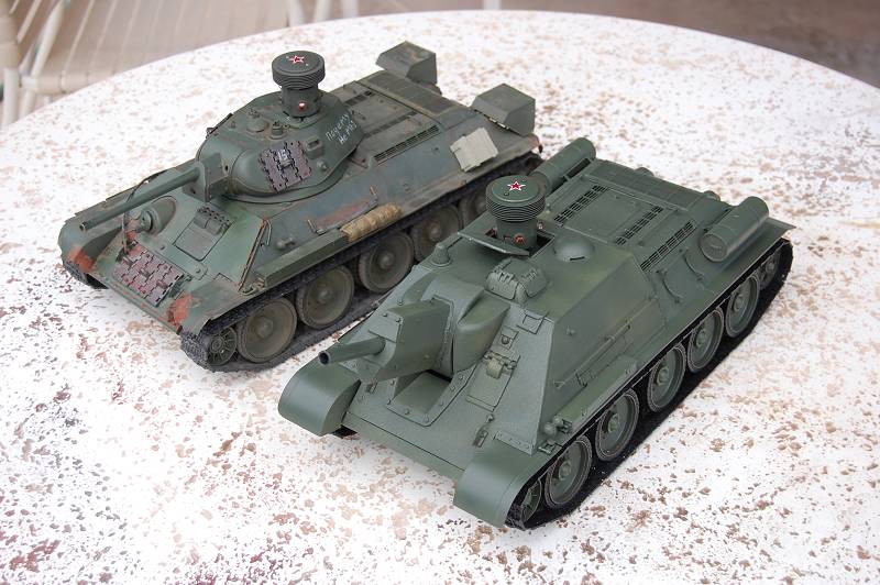

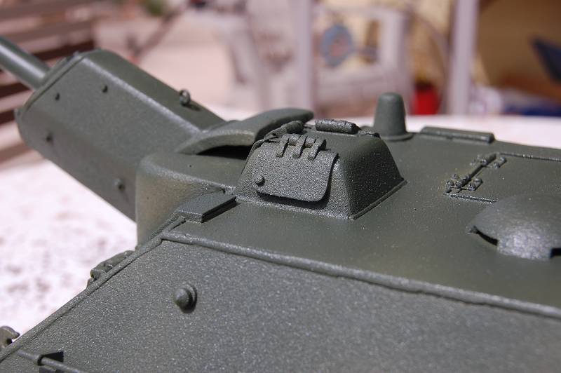

Ethan,
Nice job!
What did you use to get the texture in the paint (shot No 3)?
Kevin O
<S.C.A.T.>
Old 03-18-2007 | 07:24 PM
  #27
edoubleaz's Avatar
Joined: May 2005
Posts: 2,120
Received 113 Likes on 66 Posts
From: Phoenix, AZ
Default RE: SU-122 in progress
Two step process, I used the Mr. Surfacer but it didn't leave as much texture as I wanted so I sanded down a little an used some Rustoluem texture spray paint I had for our buildings. It is a lot thicker and I plan to use it for my non skid applications from now on.

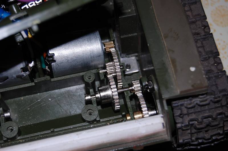

I just installed a TankToko metal upgrade kit to the gearboxes of my SU-122 and am truly impressed with the mobility this vehicle now has. The installation was fairly simple once I figured out how to remove the brass collar from the original vinyl drive gear. I used my cordless drill and chucked the collar and it came off no sweat. I used my small vice to put the new collar and gears on the stock parts and voila. The new set up is much noisier than my original T34 but I will work with that now that the suspension doesn't buckle and skip. Who knows, maybe I will add metal tracks?

Who did you get them from? I need some too. They look great.
Thanks!
Jeff

I used the email on the TANKTOKO web site to contact them and Gert sent me the sets after I paid via paypal.

I will concur. They make a big difference in this tank. No more skipping nylon gears. Now you have to be careful you don't stall the motors

I did the same thing, e-mailing Gert. My gears haven't arrived yet though. Paypal made it easy because it does the currency conversion for you. My T34 is undrivable due to the gears slipping.
Question, do the metal gears get rid of the stupid clutch? Also, don't understand what you did with the drill. Did you unscrew the collars or just use it to hold them so they could be pryed off?

The clutch is gone with the metal gears.

Cost was about $45 bucks for both sets. I used the drill to basically unscrew the collars. Low speed and a gentle tug removes the collar collar with little effort.
