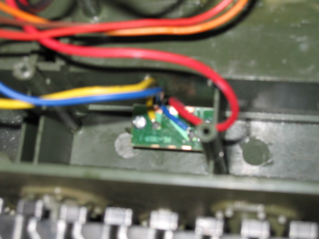

Old 04-23-2007 | 12:43 AM
Richard L.'s Avatar
My Feedback: (24)
Posts: 8,788
Received 4 Likes on 3 Posts
From: Renton, WA
Default RE: Please HELP! Board Conversion / Installation question
ORIGINAL: Fury25
If I were to go the full S&S upgrade how do I map across the wiring from the old (non S&S) board to the new (S&S) board?
I converted my HL Panther to S&S not too long ago. Here are some pics showing the boards:
