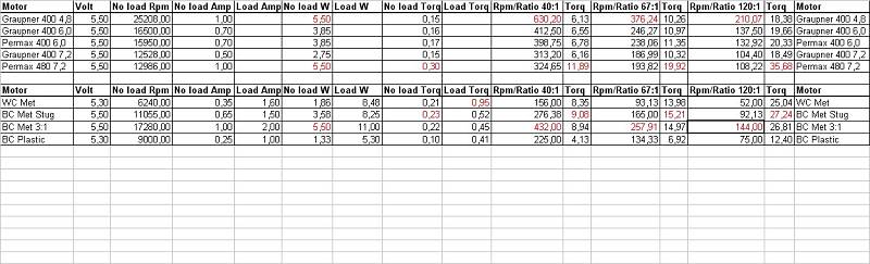

Hi,
Multiple threads on this subjec, maybe this could be a sticky?
Well, this is my testing/calculating results. Permax and Graupner motors is calculated values. HL motors is tested/measured in tank with El-Mod setup.
Regards
Jake
Regards
Jake

Hi jakeand.
Can you explain your table please?
1) What do you mean by 'no load Torque'
2) What units are you using?
3) What did you use to measure the motors?
Yours Simon M.
Yours Simon M.

Hi Simon,
1. For calculated values, No Load Amp. spec. from manufacturer (Motor spinning free, No prop, No gearbox) For measured values, Motor in tank with gearbox and tracks.
2. Newton
3. Tillquist multimeter and a Testo rpm meter. Kyoritsu amp meter was temporary.
More details: http://www.rcuniverse.com/forum/m_70...tm.htm#7044893
Regards
Jake
2. Newton
Regards
Jake

Hi Simon!
Thx for the link!
“I have a problem with you 'no load' torqueâ€
Yes me too…but the only way for me to compare
“surely this should be 0â€
Not 100% sure about that. If Torque 0, Amps/Watts also 0 ?
“And your torque should me in newtons per unit length, so what is your unit length?â€
Yep, using this: Watt / (Rpm / 702,3)=Ncm (Value 702,This value is maybe not 100% correct)
“Also why 5.5v not 7.2vâ€
As Swath stated, voltage cut by El-Mod for Tiger settings
“Finlay since these motors are quite weak, you would of been better to measure RPM with a strobeâ€
Yes, but with Motor+Gearbox, measuring at the drivesprocket is no problem
“When I measured these motors I found they were repeatable in volts to RPM, the so called 'K' factorâ€
Yes, used Volt/rpm konstant for calculated values (rpm at 5,5 volts)
“but the stall current was difficult to repeat, due to heating and phase positionâ€
Stall current is just a second before things begin to go up in smoke…
I think its better to load/brake the motor under control….
Its Time to build a Dynamometer!
“This is why I have not published themâ€
Feel free to publish your findings, you are with friends![)]
This was my way to compare different motor/gearbox setups, a combination of measured real values and calculated values. The method is a bit simplified, e.g. motor efficiency, gearbox efficiency, rpm when loaded.
Not 100% perfect, but give you a hint what you could expect.
Best regards
Jake

Hi Jake,
Sorry for the slow reply, my machine went down soon after I wrote my last piece.
No if this is so then efficiency of motor would be 100%. (true the motor Must be producing some torque, but this is only what is required to overcome any resistance, air or frictional, and thus unusable, so ignored)
For a DC motor and a fixed voltage it works like this
Max RPM = No Load = 0Nm
0 RPM = Max Load = Max Torque.
Since motor power is a function of torque and RPM it follows that the motor is producing no power at these points, BUT is using power, thus the efficiency is 0.
Referring to the link, http://www.mabuchi-motor.co.jp/en_US...ic/t_0201.html , if you click the About Performance Chart link in the left, it explains quite clearly the different bits of the graph. What you have produced in you chart is useful, but I think needs a little more work.
I tested my motors out of the gearboxes, as I wanted to remove as many vairabls as possible.
Then stepping the voltage up at 0.5v steps to 10v noting with a strobe the RPM. From this I was able to find the motors ‘K’ value, (Volts / RPM).
Regards stall current.
Again a bit of physics. When a motor is stationary it produces no back EMF, that is to say the source only ‘sees’ the DC resistance of the motor. Thus current can be found using ohms law. And since torque is a function of current, along with a ‘motor factor’, we can deduce what torque can be produced for a given current flow. So I again I measured the pull the motor gave at differing current limits, in 0.5A steps to 3A. I used a simple spring scale attached to the shaft of the motor via steel cable. Measured the diameter of the shaft and calculated is equivalent Nm.
This is where the repeatiabity failed, and I ran out of time to make a clutch type Dynamometer, hence not been published.
I chose not to included the gearboxes in my testing as I find all of them such poor engineering quality, there results will vary wildly from gearbox to gearbox.
Interesting that El-Mod choose to limit the voltage at 5.5v. I would of limited the RPM, especially since they seem to use quite a clever microcontroller setup.
Yours Simon M.

If you PM your e-mail address to me, I will send you my motor/gear spreadsheet, maybe we can develop it together for better accuracy? It could be a nice tool for other fellow tankers.
Regards
Regards
Jake
