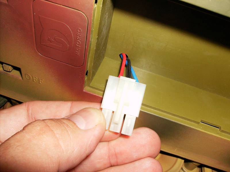

Is there any reason to believe that the electronics will suffer if I use a 7.2v in place of the 9.6v that camewith my Matorro Sturmtiger? The voltage is lower, after all. My plan is to remove the triple plugs from the tank and replace them with Deans', which has simply a positive and negative. By the way, if red is positive and black is negative then what is the blue wire...ground? Can I solder it with either the red or black or should I just omit all together?

[&o]Unfortionatly you can't do that the 3 wire plug is another voltage tap into the cells so the tank gets a certain voltage to run some stuff and the full 9.6 to run other things....
you would have to some how make taps into the 7.2 volt packs cells at the acording voltage that the tap is on the 9.6v pack.

ya that blue wire is tapped a cell or 2 before the stick ends. I would recomend just changing out the guts for a hl smoke and sound package. i cant see that not working out.

Since it uses this three wire plug, could the charge lead still be adapted to a decent charger (just using the red and black on the plug and cutting the blue off)?
The charger that the Sturmtiger comes with has only a red and black wire, so the blue is not involved when charging. I'm thinking now, that I may use two battery packs - 7.2 for running the motors and 9.6 for the electronics. There is enough space in the lower hull for both. If it all fries, I guess it won't matter since I don't plan to keep those boards in the tank.

I'd have asked " Where in the pack is the tap " as that will tell you the voltage needed by the 'limited' components. If this 'limit' is under 7.2v, sure, you can safely dispense with the blue tap, and just go red & black all the way.
If it ~isn't~ under the limit, perhaps a 5v regulator (like used for electronics boards) is called for, or a dropping diode or two. There ARE better ways to do this that critically unbalancing a battery pack.
