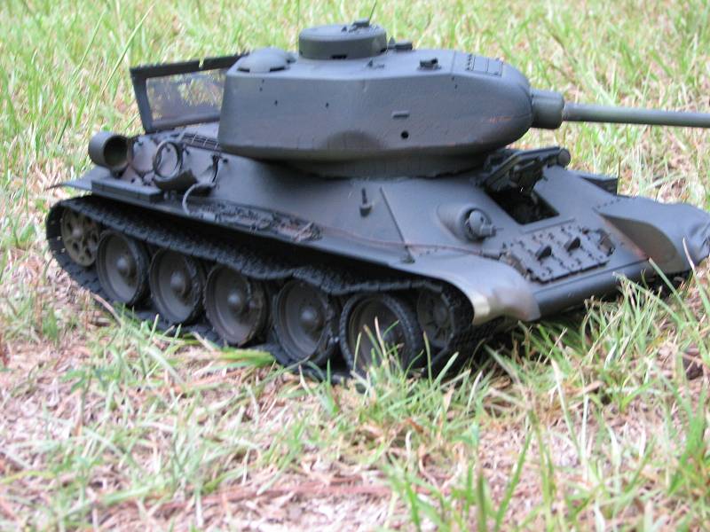

Just thought I would share pictures of my current project. I haven't posted pictures in a long time. The Color is Green just looks dark had to turn my flash off on the camera was making the pictures really bright. Did some Airbrushing on the base of the Tank. Over the weekend plan on adding all the Small Detail then will use the Airbrush again to tie it all in. When That happens I will take pictures again and try and get the camera to work better. You can see the Shadowing in person much better. The last Picture is Standard for me in adding ESC's and a mixer. Well hope you like them.

Looking good mate. Not to discredit your work in any way, but the T34 tractor/APV's I've seen have two hatches (cupola and another) on the welded steel plate over the turret circle.
*finds a pic*
[link=http://img528.imageshack.us/my.php?image=t34apvmu6.jpg][/link]
WSN T34 is 2nd/3rd on my "gotta have it" list... Hows the ESC and mixer going?
Old 10-27-2007 | 02:40 AM
ah64's Avatar
Joined: Jan 2006
Posts: 365
From: Colona, IL
Default RE: T34 APV
Thats the picture I was using as a referance.... I Didnt have a extra Hatch. and the one on the Turret of the T34 is molded in.[]
best I could have done was use a Sturm tiger hatch I had but there would be a periscope. I got My T34 On ebay about 2 weeks ago for 75 shipped fed ex. the Esc and mixer is the only way I will run my tanks. The T34 is my second Favorite Tiger being the first, Like everyone else.. But there are so many veriations with the T34 with russian and German. That I think I might try for another one. I like the T34 /german 2x20MM AA

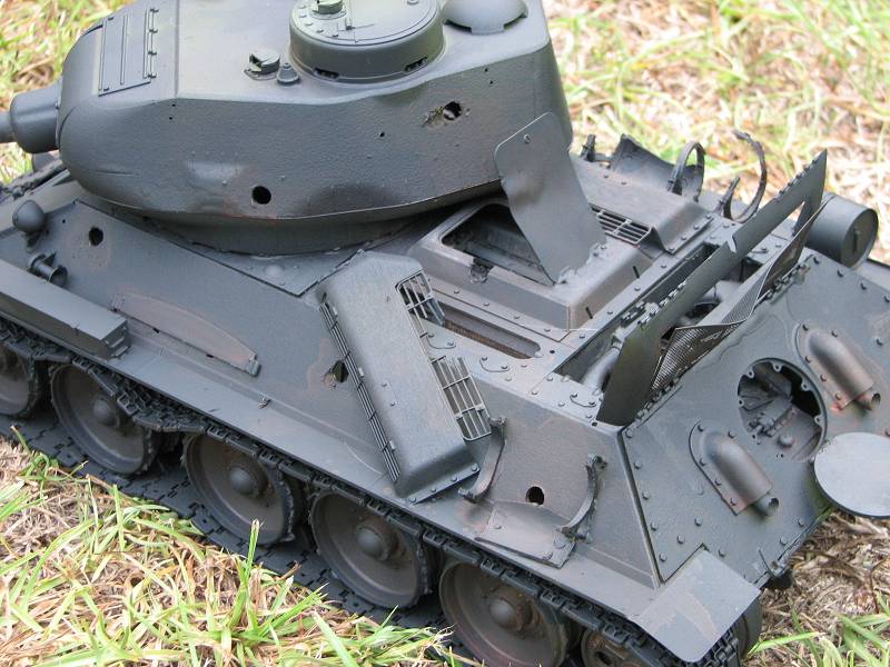

Here's a photo of some wire mesh I used for the engine grill on mine before painting. Got it at Micheals Crafts.

THAT turned out really nice! You just cut out the plastic mesh and left the frame as is?

The frame is thin sheet metal from a coffee can lid or something similar. I had it laying around. The bolts are plastic rod cutoffs.

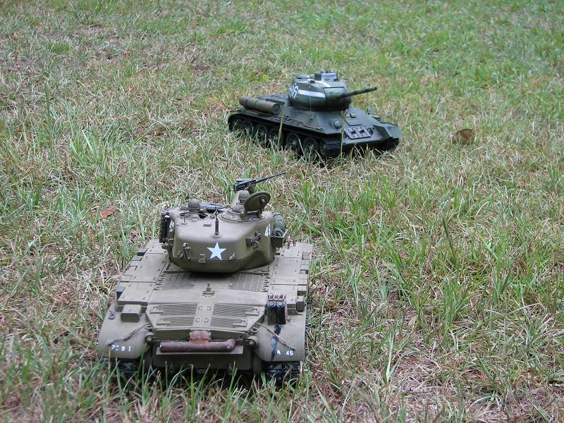

Old 10-29-2007 | 07:22 AM
pattoncommander's Avatar
Joined: Dec 2006
Posts: 5,058
From: Columbia, SC
Default RE: T34 APV
Jeff....good idea with the train smoker.[X(]..might just do that on a display setup. Think one would run on a 9v battery?
No 90mm....my scenario was a 105mm from an M-45 in korea. [:@] Photos.. the kill was easy...the "burned tires were made my demmeling the ridges meant for the rubber tires and leaving the residue in place and stabilizing with super glue. The other side was less burned and I actually burned the tires on the first two wheels with a micro torch, put all wheels in the max up position and got as much sag as possible on the tracks. Memories of ones I saw are still vivid. [] Note only the driver got out. [&o][&o]
