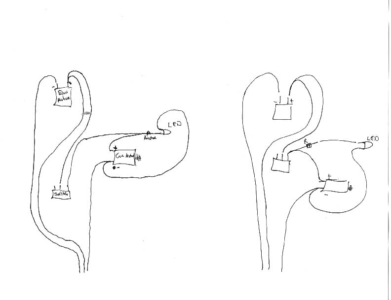

Here is the circuit you can make sure that you are wired correctly or that you are getting good contact from here!
The Blitz

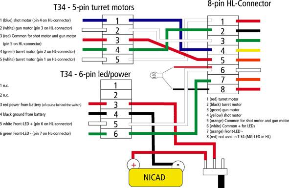

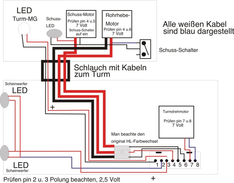

You trying to confuse the man Blitz? That's a conversion wiring diagram!
The ground wires control the functions in HL tanks, many people think it's the red and wire their tanks up wrong.

True it shows how it connects to the T-34 I guess I should have pointed that out, but at least he could see what & where the source is

Make sure you're plugging it in all the way, use a multimeter to check the pins on the loom coming from the board, especially the red and black on the edge (turret rotation) -- under power it should give 6.8-7.2v
Check your wires arent cut/crimped... I dunno what else to say

You probably got the 3 wires going from the turret to the junction block crossed and that's why nothing up there is working.

Taken from my thread [link=http://www.rcuniverse.com/forum/m_6571532/anchors_6573955/mpage_1/anchor/tm.htm#6573955]here.[/link] Hope it helps

Thanks Wackywheelz. Also had a look at your other thread out of interest. Few of the colours coincide, but it's where they go that counts.

Yep, wire colours/colors may vary, but placement is always the same (on the plug). I was gonna put that on the image, I host the image locally (in my own webspace) so it can be easily edited to clarify or correct something. Good luck with getting it back to life, shouldnt take much!
