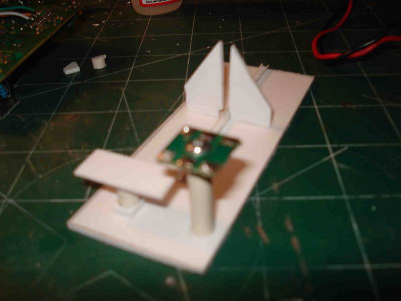

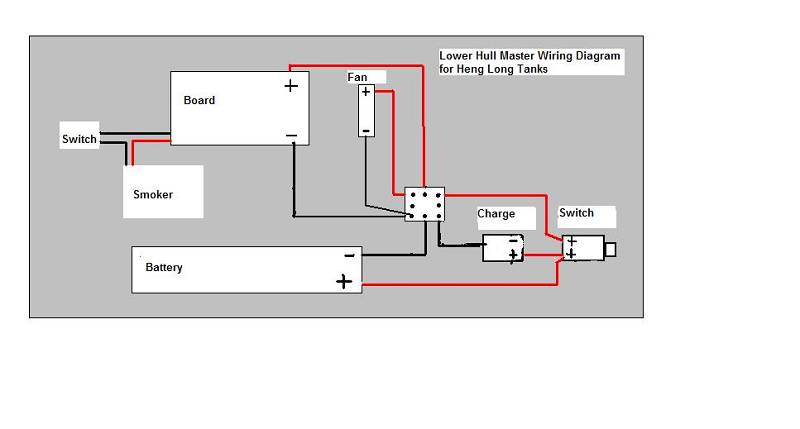

Do you have an old smoker? Or a spare?
Here's how I do it. The little stand in the picture is for the fan. The junction block can be mounted anywhere.

many thanks for the pics james but i just can't read a wiring diagram!!![:@][:-][>:] sorry mate..actually placing the fan is fine, its just the wiring? can i not go directly into the switch poles? thats what i did with the bulldog and its still working perfectly (and touch wood i haven't blown anything yet) just dunno how i did it and haven't got the bulldog here to look at?
sorry again for wasting your time posting pics for me!!
rgds stuart
p.s. am trying to borrow a camera right now so i might be able to post a pic(never done that)

Come on mate, that's easy to follow, red = power, black = negative. I made that to remind myself what to do for each tank because I'm a big dummy when it comes to wiring. Like I've posted elsewhere, I've got more blown boards then most guys have tanks due to learning the hard way!
If you don't want to use the junction block then solder the wires on top of the black and red on the board or switch, it doesn't matter. My little design let's you add multiple accessories to the power supply in an orderly manner.

james, got confused with the extra smoker junction on your pic, for now i just want to come off of the switch and having just woken up with a clearer head i'm raring to go..!!
