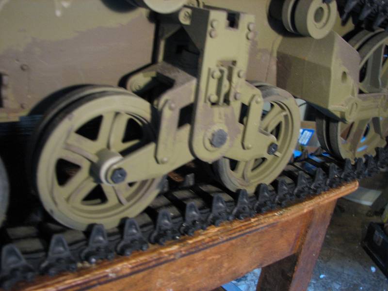

The tracks I have on my Stuart are the only ones used by the M-3/5 series, ie; single rubber block external track guides on the end connectors...NOT the double pin steel chevron combat track and center guides with split wheels like the M-26, like the Chinese manufacturer dreamed up. . Jack Yang makes these and they really do make a great difference. He also supplies hole plugs for the various screw holes in the suspension with his track. They are hand made and really not that expensive. You have a choice, either assemble them yourself at home at a cheaper cost (and faster) or he will assemble them complete where all you have to do is take off the old ones and install the new. Comes with extra blacks fo mounting on the bow etc.
[email protected]. Or M5stuartrctankbattalion.com .
As has been mentioned, a drawback is the single speed of the tank but some giuys have modified them. Also the gun is a fixed position thing which you can improve my pressing the plastic detent on the upper part of the mantlet. This releases the mantlet and gun and you can simply reverse it to point straight ahead, but you'll have tio clip off a bit at the back. Some guys had added elevation/depression and set up to shoot paintballs. Either way, it's an impressive tank and a defibate attention getter. Upgrade parts are available on a couple sites, just clock on 1;6 scale.

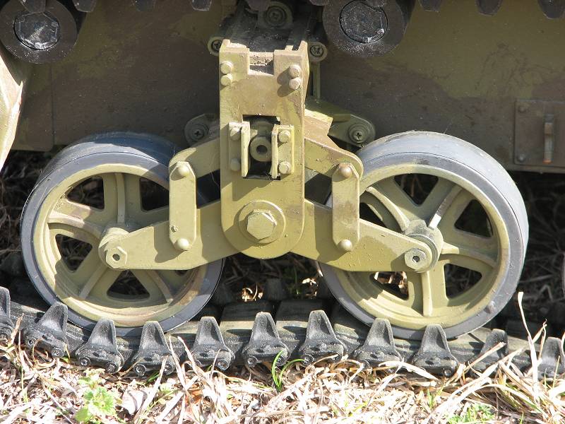

forgot to mention on the Stuart tracks....Jack is working on slot fillers to fill in the slot and make the bogies look like solid wheels. He has not been successful but is working on it. I used thin sheet styrene cut to size and suoer glued it in place....works nice.

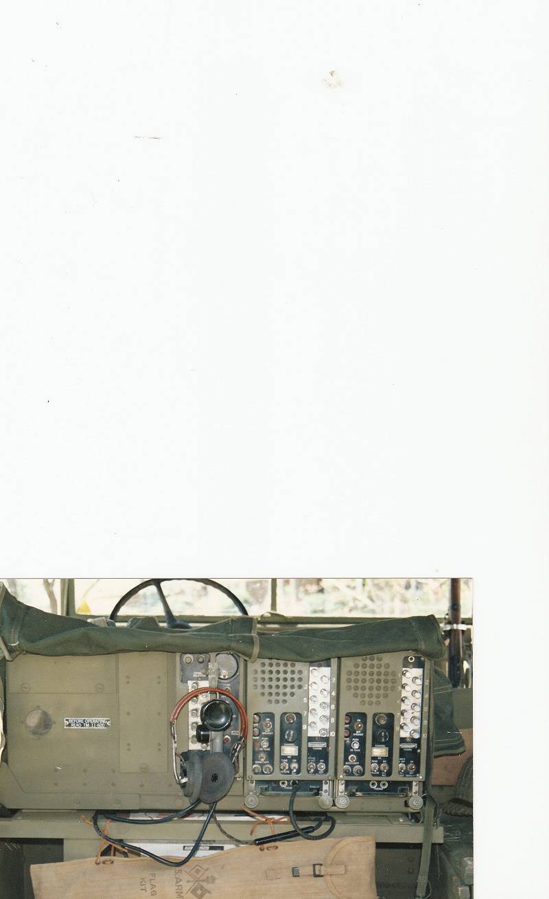

SCR-508 RADIO SET....GOES DIRECTLY IN BACK OF THE TC AND GUNNER

OK I sent the wrong photo, but this is an SCR-528 not 508, this has an additinal receiver in place of the storage box....so this is for a commander's tank.
