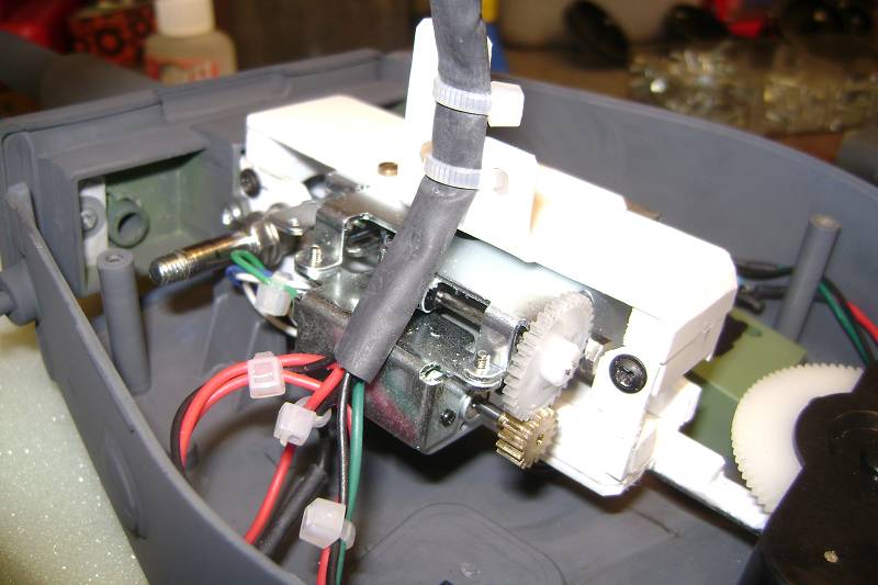

Urgent Help needed! Elmod System not Functioning Properly!
Hi, anyone can tell me what went wrong?
I connected the booster, TLS and blaster according to instruction. The TLS seems to be working properly - Turret rotation and elevation ok, BUT the Booster seems to have problem. When I push the control stick or the directional stick, the command LED lights up, but there is no voltage going to the motors at all. Also no engine starting up sound at all when I switch on the Tx followed by the tank. [
Just found out that the booster is working, but the problem is actually caused by the sound blaster switching the engine to off by default.
According to the instructions, I should move the left lever to the left lower position to switch on the engine. Tried but there is no response...no engine starting sound...nothing...[sm=confused.gif][sm=confused.gif]

I'm running Thinktank Pro (M).
Tried unplugging the Blaster, and the tank works perfectly - After switching on the tank, it is able to move properly, and the turret also function ok. So I guess the issue is how to ignite the engine when the Blaster is connected... I'm wondering why it won't respond to the Tx's diagonal input...[
BTW, I'm using a Mode 1 4chn TX.
] BTW, I'm using a Mode 1 4chn TX.

Mine is the Booster Prop 4Ch. So pushing the stick lower left should work right? By chance do you think the problem has to do with the setup on my transmitter, which is as follows:
Mode 1
Elevator up/down - Booster Accelation
Rudder - Booster Steering
Aileron - Turret left/right
Throttle - Gun elevation
Mode 1

Maybe you could post some pics off your installation?

Been trying to trouble-shoot the system for the past 4 days...and it's really quite frustrating at times...
Thus far - I have tested the booster and the TLs separately with the Blaster, and they all seems to work flawlessly. With the Booster and blaster, the tank engine self-ignites with sound and moves. With TLS and Blaster, the turret functions with the canon and MG sound. So now I think the problem is narrowed to only 2 possible causes:
1) There is something wrong with my Tx, which I got it cheap for use with my aircraft quite some time back. Somehow the diagonal input is not enough to trigger the ignition.
2) There is something wrong with the Blaster, which cannot accept diagonal input from the Tx.
What else did I missed? [

Hmmm...I posted a reply yesterday to say that I've already solved the problem. What happened to it? Seems that it just disappeared. Anything wrong with the forum? Hackers???[&:]
Anyway, as mentioned yesterday in my post that disappeared, I pointed out that the problem was caused mainly by the Tx confusion and some mistakes in the elmod manual.
Tx Confusion
In the elmod manual it gives the following connection to the receiver:
• Connect the four cables of the multi-connector cable P2 in the following
way:
cable black/brown: channel 1, acceleration (right stick, vertical)
cable red: channel 2, steering (right stick, horizontal)
cable yellow: channel 3, canon lift (left stick, vertical)
cable orange: channel 4, turret rotation (left stick, horizontal)
So I obediently followed the instructions - black/brown to channel 1, red to channel 2...etc, that is a big mistake. I forgot that on my TX, channel 1 is NOT right stick vertical, but right stick horizonal. Also, my channel 2 is NOT right stick horizontal, but left stick vertical...
After 4 frustrating days [:@] I finally decided to do it MY way. Black/brown to rightstick vertical? OK, let me check what channel is right stick vertical on my TX, and then connect accordingly on the receiver...the same goes with the rest of the cables
Finally, after connecting everything, time to try again...sigh. Now according to Elmod's FAQ section, here's how you are supposed to ignite the engine:
Question: The tank keeps not moving after installation of the Blaster. The turret works fine!
Answer: If a Blaster is installed, the engine has to be "ignited". Move the left stick to the uper left corner for HL-electronics (down-left for proportional) to turn the engine on and off.
So...I pushed the left stick to the lower left position...AND NOTHING. Not even a puff. Well, what's new, right? So, out of instinct, I just pushed the left stick to Upper Left...AND SUDDENLY, the tank roars into life!!!! [X(] It turns out that for my Tx, I need to push left stick upper left to ignite engine and lower left to switch on/off the light. Very strange...I'am not using HL electronics, and yet...

1) Add gun flashes with white LED
2) Change to Metal Gearbox.
3) Re-do some stock wirings which are getting loose. I'm really lousy with soldering...[:-]
4) Add LED MG
But frankly, I'm struggling whether to migrate the Elmod system to a bigger chasis e.g. Tiger, T-34, Pershing...etc in order to use the Elmod speaker. [&o]Thus far, only my Panzer III is running on metal track, but I just can't forget the SOLID sound effect from the elmod speaker...[sm=thumbup.gif]
I bought the battle circuit as well (known as CSI) BUT...I don't have space to squeeze in another circuit anymore![:@] The Panzer III interior is so cramp, I couldn't even put in the elmod's speaker, which will have sounded MUCH MUCH better than HL miserable speaker. [&o]
Currently, I'm using Futaba TX and WFLY Tx (for my KT running on Tamiya). Both have the same channel allocations for the two control sticks. That's why I encountered the problem when tried to follow the instructions from Elmod strictly.
Anyway, the Panzer III is not completed yet. Still have to:
4) Add LED MG

Hmmmm, I take it that you are runnning a NiCD or NIMH batt, else you can remove the battery bay and use lipo instead, that is if you have a lipo charger to start with. The other thing you can try is to change out teh speaker. I found a speaker from sim lim towers that is a 8ohm 0.25W same size as the HL's 8 ohm 1W speaker but some how with the lower watt rating i am getting a louder sound(not much louder)
Btw I noticed a potentia meter in front of your gear boxes, what is that for? Are you using the original elevation mechanism from teh HL tank? If the BB gun is disabled maybe removingteh bulk of it will allow you to mount the circuit there? The PZ 3 is too nice a tank not to battle with. Is there a port on teh el-mod to cater for the flash LED? Sorry about the 20 questions but am very curious about the elmod stuff and have been looking at them for a while but teh price was a lil too steep for me.
Maybe if I see it in real one of these days it will push me to get the set. I run my PZ3 with Darkiths battle circuits but seeing your tank firing with out that krazy jerk makes me think twice about upgrading it.
Yep...I'm currently using Ni-Cd. Yah...maybe I'll take out the battery bay and switch to Lipo. I have a couple of them which I use for my Blade CX2. As for substituting the elmod speaker for something else, never thought of that [X(] because after hearing the sound that came from it a few days back, I really don't think anything will match it IMHO. It really sounds very solid (like Altec Lansing PC speakers [sm=thumbs_up.gif]) because of the boombox. No matter what, I'll try to remove the stock speaker and squeeze it in...
The potentiameter is for volume adjustment of the speaker. The gun LED (any LED) can be easily connected to the TLS module via a connector. I did thought of removing the airsoft gun too to make space, but the problem is - the entire gun elevation system will be affected because it uses the airsoft gun as a hinge to move the barrel up/down. Hmm...maybe there's a way to remove it without affected the elevation.
Yah...the Panzer III is very nice (my favorite thus far too), BUT wait till you see the PANZER IV when it is properly painted/weathered and running on metal gears and tracks, then maybe you will change your mind.
