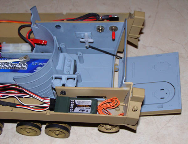

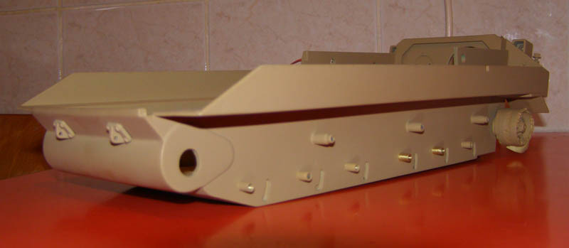

Hey, it looks great with metal treads! And the PIV sprockets doesn't look weird as I was thinking. I'm sure you'll be able to insert the 6th roadwheel somehow; looking at the picture seems to be enough space. My Bradley is growing too, even I hardly find some free time for spend on it.
All the best,
vamos

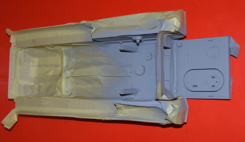

Old 02-01-2009 | 05:41 PM
  #33
Joined: Jan 2009
Posts: 11
From: , ROMANIA
Default RE: Bradley Conversion

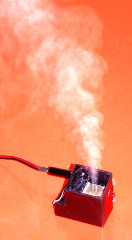

Ultrasonic water vaporizer used as "smoke generator". A lot of "smoke"

Old 02-02-2009 | 02:14 PM
  #34
pcsguy88's Avatar
Joined: Dec 2007
Posts: 809
From: KC
I have not had 5min to work on this project since I played around with the wheels. Looks like you should be up and running any day now vamos. Looks great. Is that a metal stair traction guard thingy that you used to anchor your swingarms too? That is my next step. I'm trying to figure out how to mount the swingarm springs. I have seriously considered cutting the PIII hull apart and gluing it to the Bradley, but this is too much of a shortcut for me to stomach.
Old 02-02-2009 | 02:55 PM
  #35
Joined: Jan 2009
Posts: 11
From: , ROMANIA

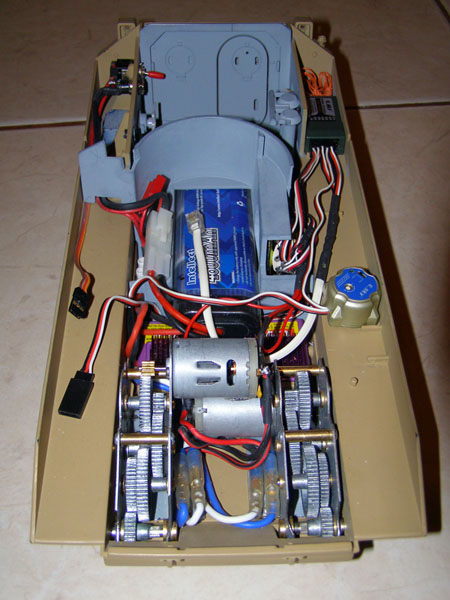

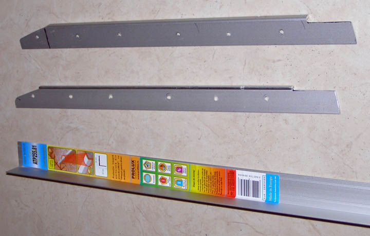

ORIGINAL: pcsguy88
Haha, we're in the same team then. I just have a "brand new" son and the poor Bradley will have to wait.
Yes, I used aluminium stair guard to reinforce the lower hull because around "4kg of tank" was to much for that plastic thing.
I'm happy with the smoke generator: it takes 0,3A@5V and 10ml of water per hour. I added a drop of aromatic oil and this tank will be an "mobile air freshner" )
All the best and keep up the good work,
Vamos

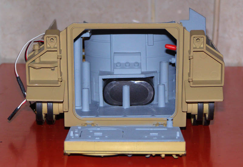

Not much to say about. Buy the humidifier, take out the magic stuff, discard the original case if is too big, fit the parts in an appropiate container and enjoy the smoke. If you have a specific question and I know the answer I'll be glad to help. My Bradley is pleased with this setup, i let it run almost every day and no complaints yet
Now it has engine sound too. I picked some schematics from the web, tried them, make some mods and adjustments and ended with a very pleasant diesel sound. If someone is interesed I can post the diagram.
