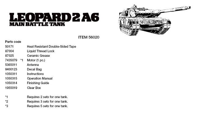

RE: Tamiya Leo 2 instructions
Order, online, a Tamiya Leo operations manual part number 1050315 here: https://www.tamiyausa.com/contact/index.php
Go here for rc setup basics: http://www.customrcmodels.com/Tanks/id92.htm
