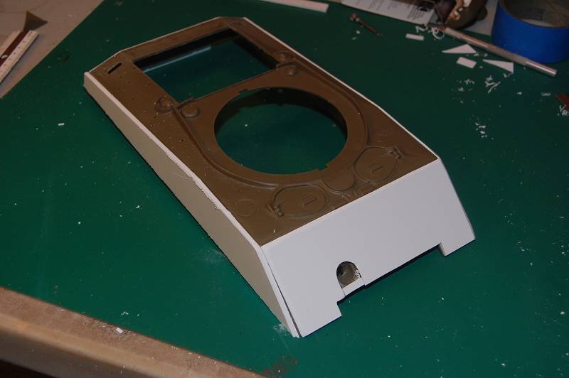

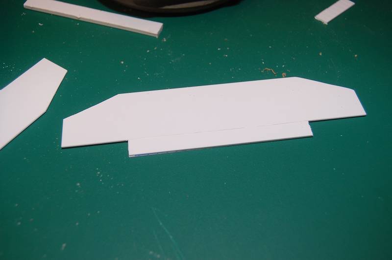

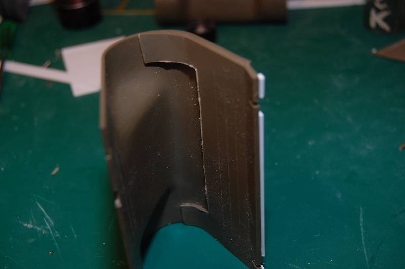

Alright gang, I have put my vehicle decisions up to a vote before but this time I am taking matters in to my own hands and proceeding with my JUMBObuild whether you like it or not! As we gear up to more allied heavies (KV I and II) Iwill keep busy with the spare parts I have.
First step, make the armor for the hull and correct the back deck.
For my full build progress, tryhttp://web.mac.com/ethandunsford/DAK_PROJECTS/JUMBO.html

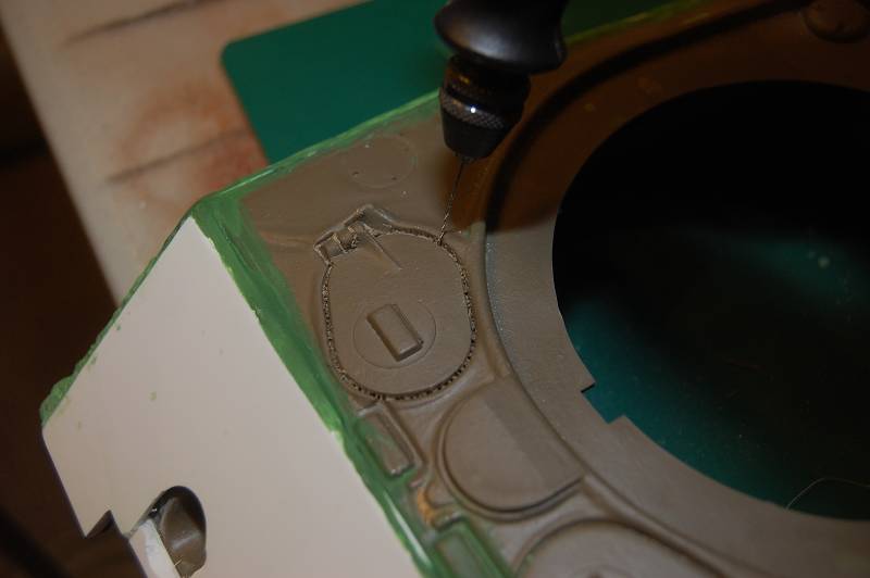

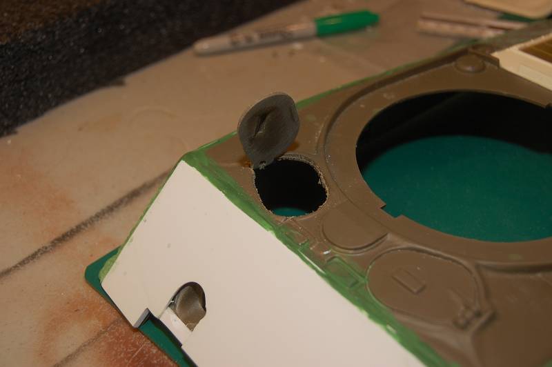

This time around I opened the Driver/Bowgunner hatch with the thread technique. Results are really good!

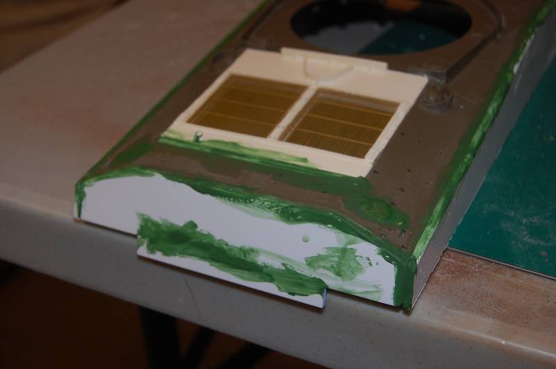

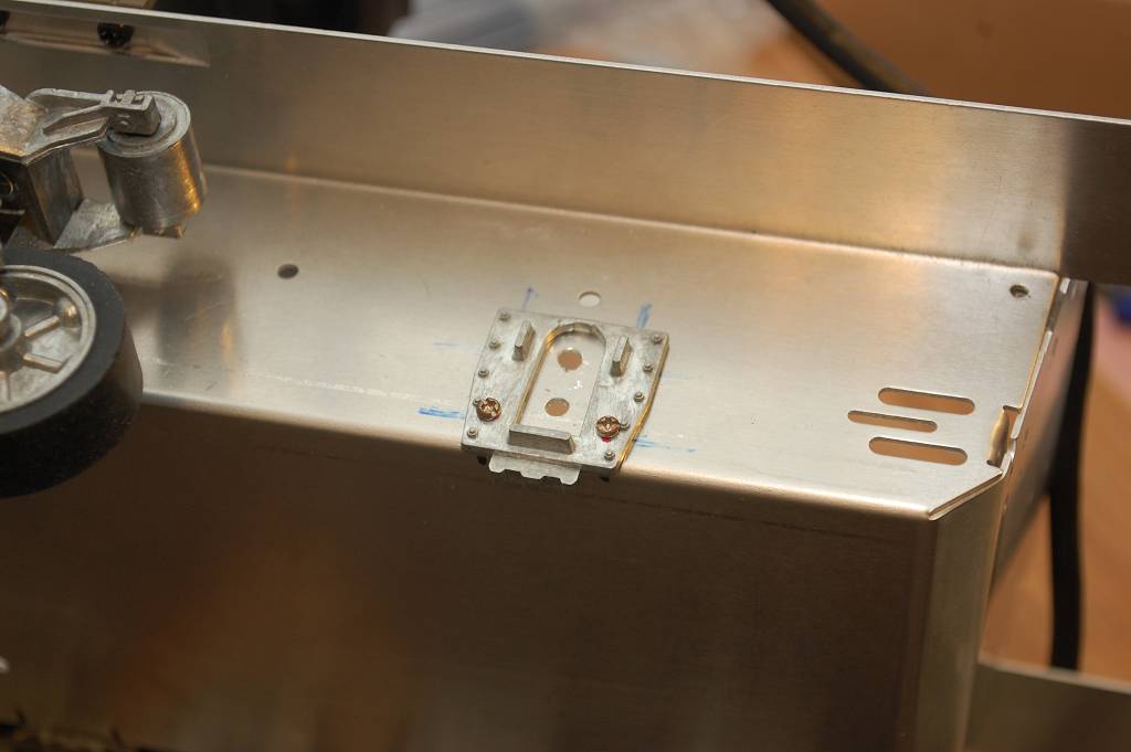

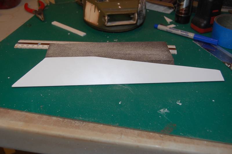

Hatches now have handles. Engine deck in place.... with handles. Armor plate ground down with simulated weld detail (thanks squid for the help). Next step is the double thickness on the transmission cover. Iam laminating two of the Tamiya covers to simulate the pattern. The upper portion will require new bolt holes as the jumbo's thicker material had no lip like earlier version.

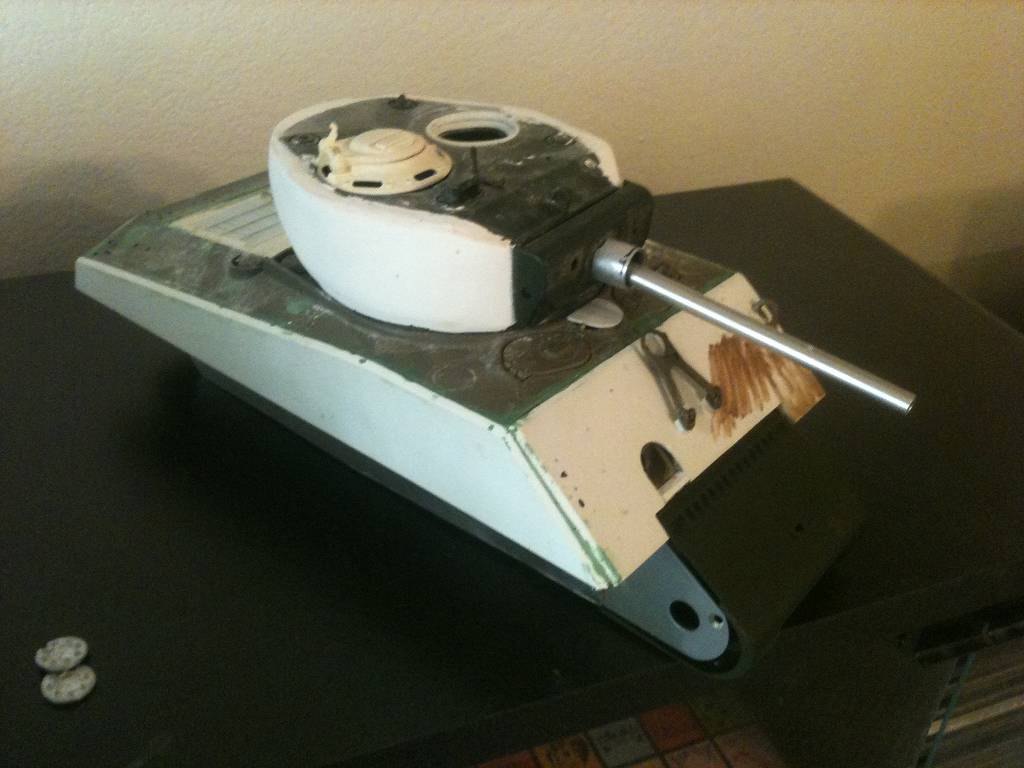

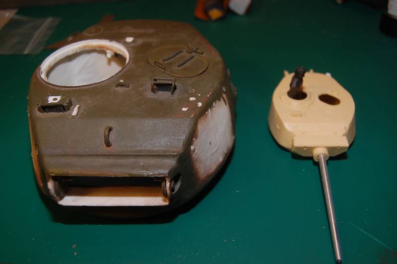

Back on this project after a few years.....

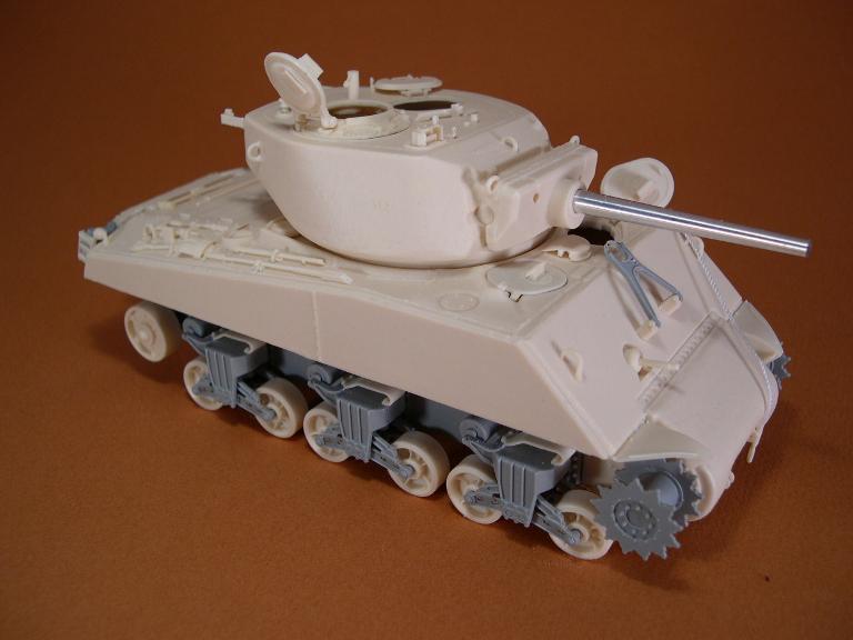

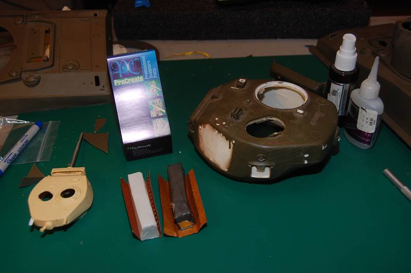

Junked the old BYA turret and used a surplus Mato and a load of Putty, CA, joint compound, and styrene to shape the new turret. This one will have a 75mm gun from my private stash. Metal sprockets, bogies, and duck billed track are on the horizon. I am now working on the Mantlet.
More to follow.

Engine deck in place.... with handles.......................
Dang that looks good! How did you build it? What did you use? Any chance of more photos of that grill?

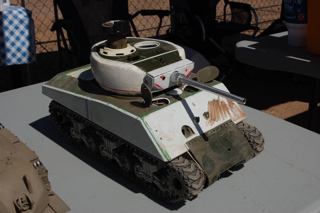

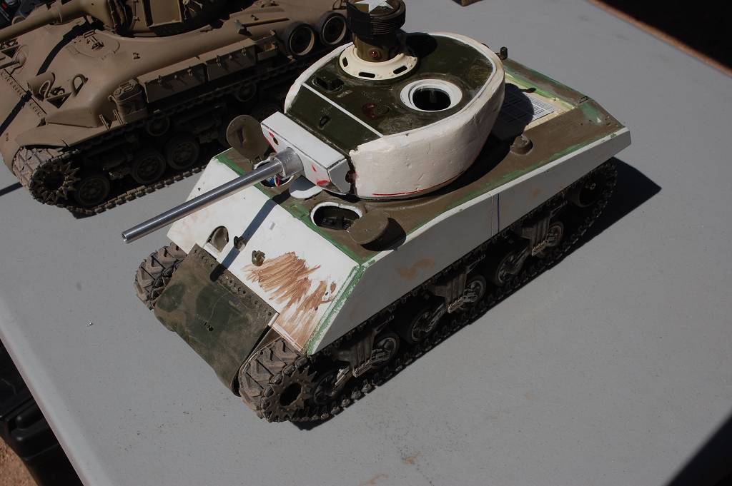

Pershing recoil unit, Pershing recoil stay, 75mm barrel is from the DAK private stock. Mantlet began as Mato with many layers of CA and Styrene. All sanded down repeatedly.
Elevation in simply the tamiya unit but this time it has standard RC arms from countless servo packs and no ball jounts. Metal elevation arm of course.

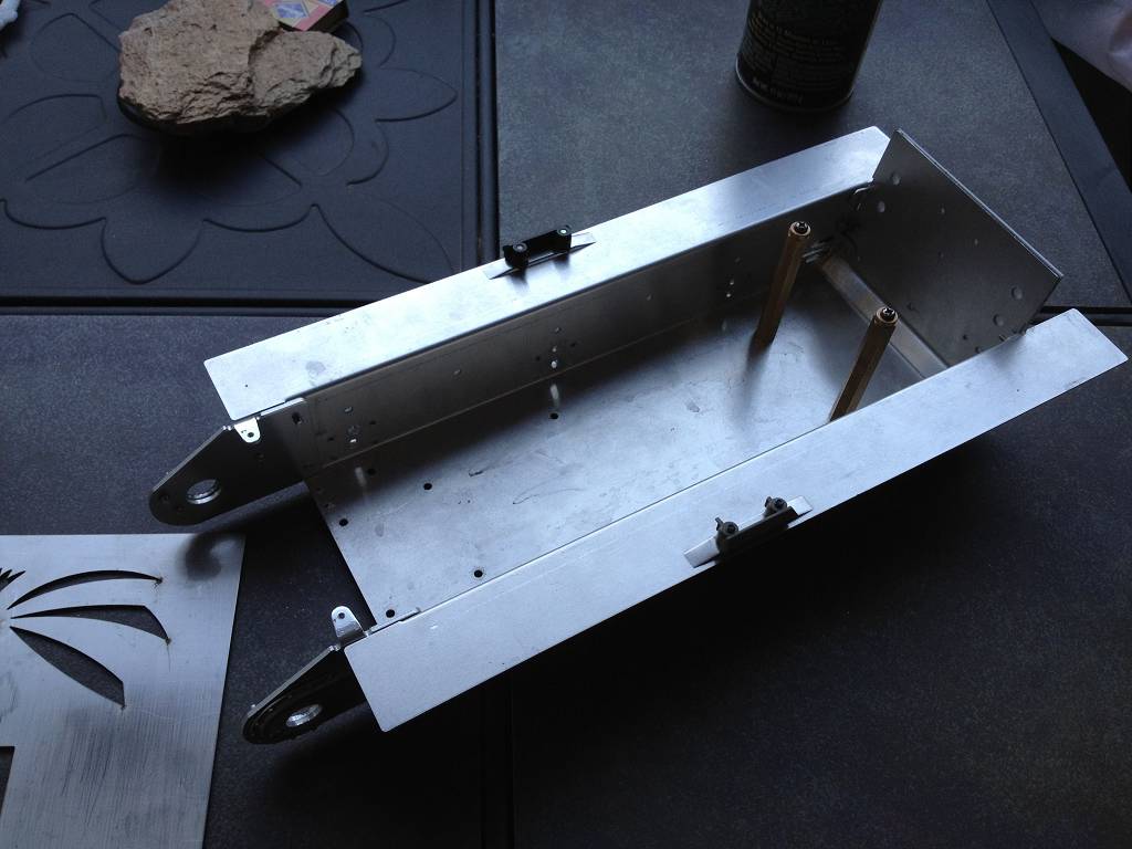

I also tried the spring conversion on the bogie wheels. I even purchased a metal spring set from BOB/ETO. I confess I spent so much time on it I was forced to just bolt the other 5 on as is. I will get back to them later...

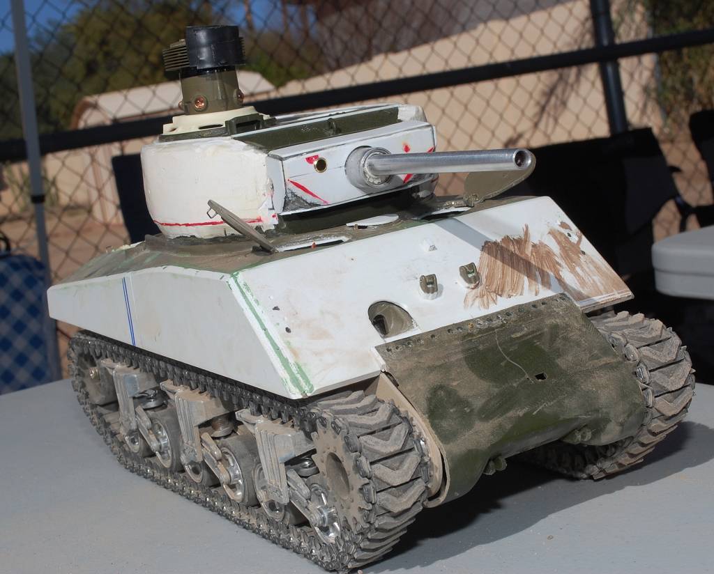

The little one (yes my first) is doing great and has adopted a fairly reasonable sleep schedule so daddy has actually been able to get back to the bench! (a few minutes at a time)

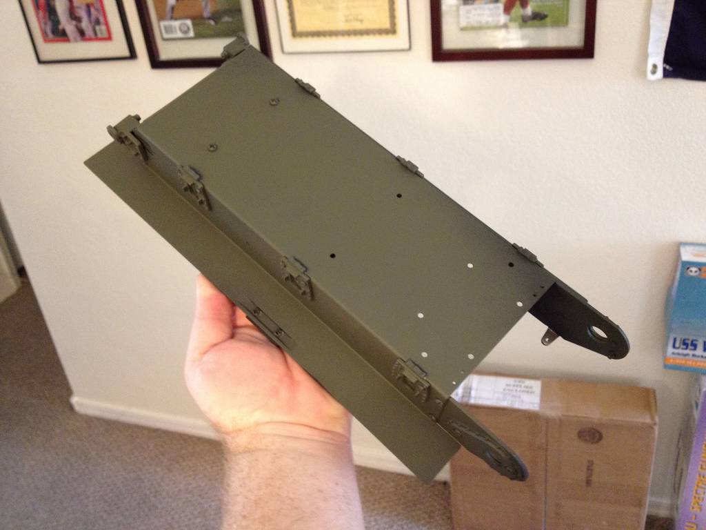

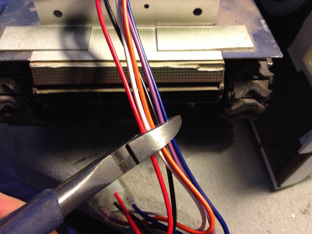

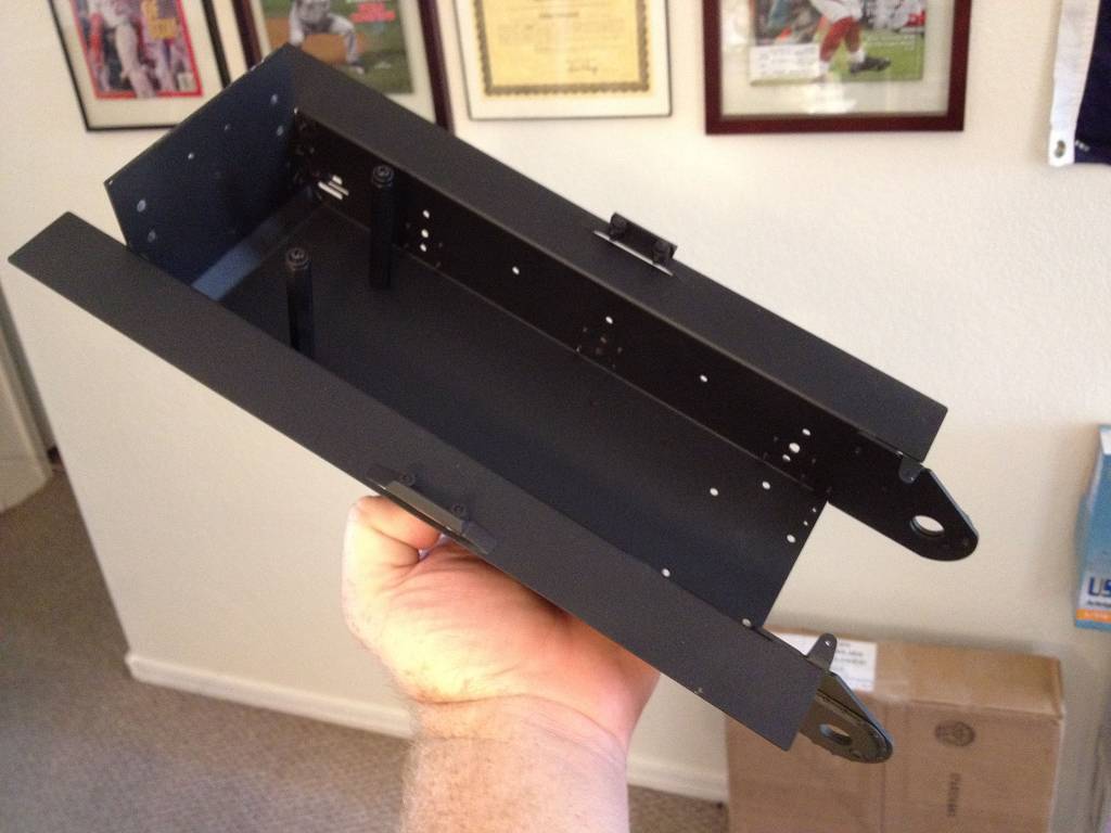

I had to buy another Pershing DMD and the usual dance begins with cutting the wires, adding dean's plugs and installing a customized charging system.
This time around I am priming and painting the hull black and then OD as a base coat.
