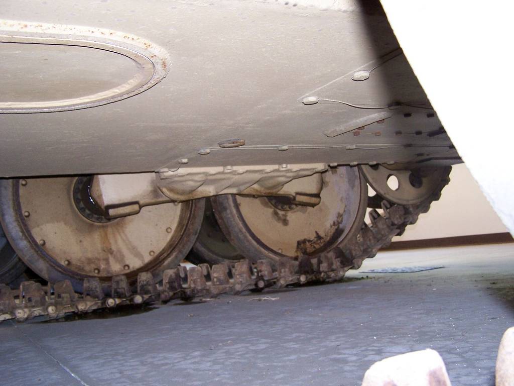

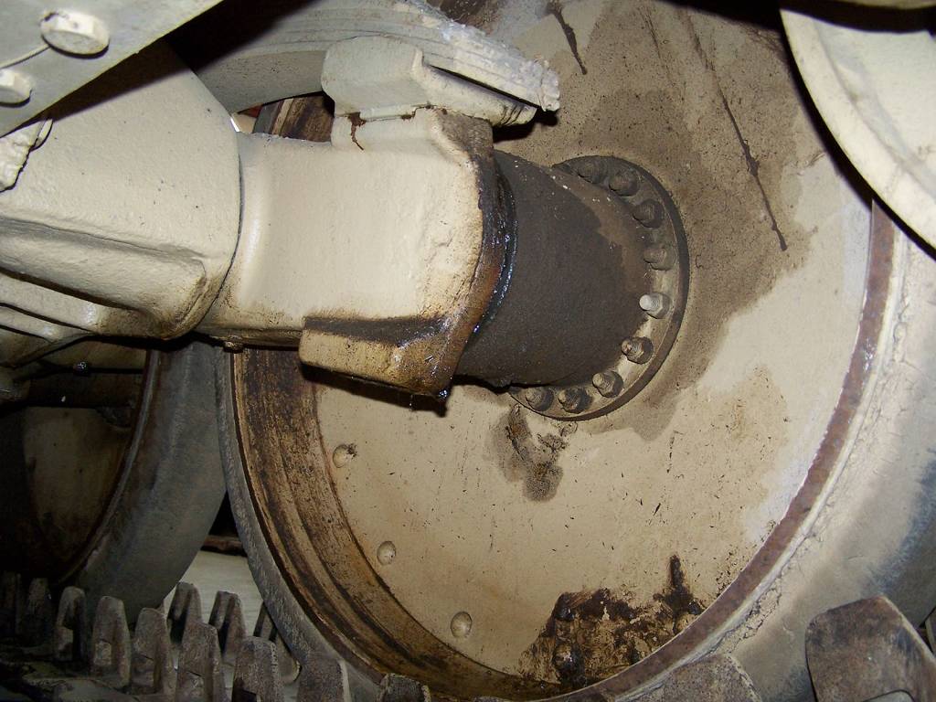

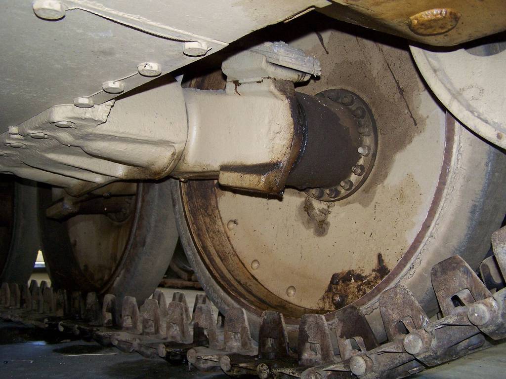

Hello all. I have a curiosity regarding Hetzer road wheels. I'm trying to work out the best way of making another set for my
current Hetzer project. Reason being I don't want to goof up the existing ones and on the other hand I want to make a better set.
My question is this: I believe the road wheels were pressed steel cups basically with the outboard side convex ( conic section),
with a tire retaining ring riveted( the later ones anyway) bolted ( early )/ partly welded to the outer side and the inner side open. I have good photos of the outside from a long past excursion to Jacques' place but I didn't think to take a photo underneath at the wheels to show they are open. I have one partial grainy photo that shows the wheel open inner side- I can just see the other side of the rivets/bolts but I's really like a better shot. If someone has such a photo I'd appreciate seeing it. In the old days I'd zip down to Jacques just to snap this but those days are sadly past. It is now difficult and far more rigid getting in and everything has a cost.
Alas my old friend Jacques is probably rolling in his grave for he was such a good supporter of information gathering....
In the end it probably won't really matter but I'd love to know for sure. I have to make a form for vulcanizing the tires and how
I make the rims will determine how I make the form....
Thanks in advance,
Jerry

Better (bigger) photos
http://www.pzfahrer.net/autopsy.html
RE: Hetzer Road Wheels - inner face
That's perfect you guys, just what I needed to confirm what I suspected. I have to confess I went by the website you
highlighted Rex but I blew right past that photo. Takes multiple sets of eyes to see the right information. Word to the wise:
never think I've seen something before; even if I've have there a chance that I've not really seen it...
Thanks Gunnar I've not seen that either or certainly don't recall it.

Hi Jerry
This image comes from the G-13 in the Jacques Littlefield collection at Portola, hope it helps to clarify your question.
Best regards
Jose
Best regards
Jose

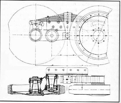

I have another question regarding the Hetzer road wheels. I've looked through the information( including Spielberger's light JagdPanzers book) I have and I cannot find a solid reference to
- the outer diameter of the wheel
- the thickness of the wheel at any section along the rubber part or of the metal rim that contacts the
rubber tire.
From what I see the tire is quite thick. There isn't a great deal of space beteen the tire and track link guide horns.
I'm planning on heeat vulcanizing the rubber tires and I'll provide a brief explanation when it is
complete. I passed this technique on to a fellow on the east coast many years ago; he's the only other person I've known to have used it. I've made quite a number of Panther and PzKw III tires with the technique. It isn't very difficult but the mold preparation takes longer than the actual tire making process.
One is limited to the type of tire made only by their ability to make the proper mold.
Any info or leads to it would be most appreciated!
Jerry
