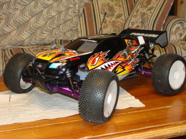

i think it worked i donnno just wanted to show my hellfire ss.. tell me what u think about it.. thanks
ID:	1136771   Click image for larger version

looks good polaris. What kind of masks did you use on the body?
