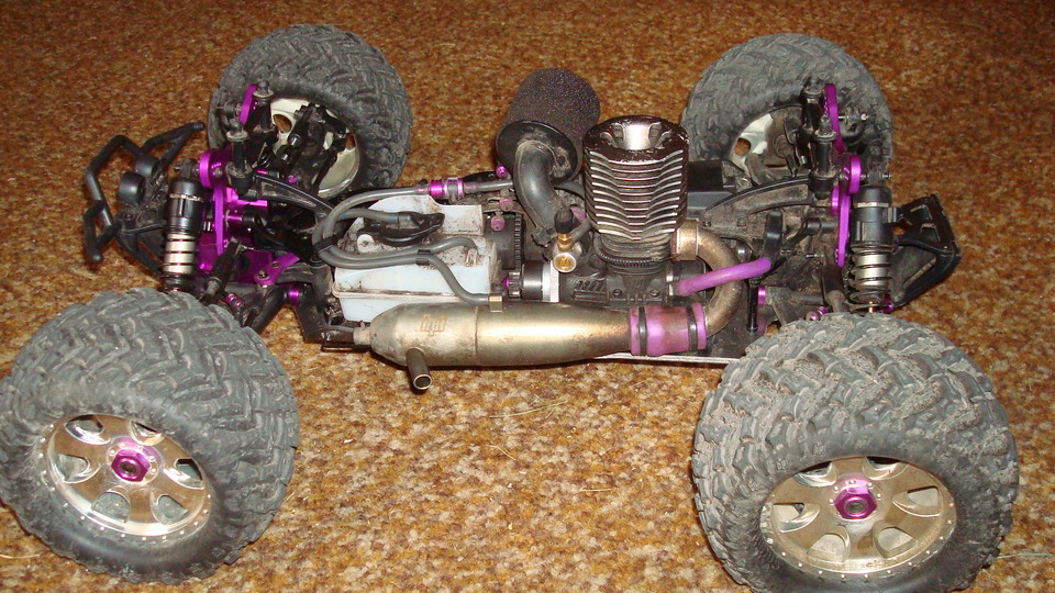

after 2 gallons:
ID:	1270674   Click image for larger version

Wow. what happened with that piston? Running too lean?

that what it looks like? thought it was a pretty good tune, fat if anything. Dont know what happened to it. Hope hpi tells me when they look at it.

Im just guessing. Its hard to tell from the pictures. I would think that the engine probably got too hot to cause the piston to crack like that. Unless you had some dirt or other debris in the cylinder.

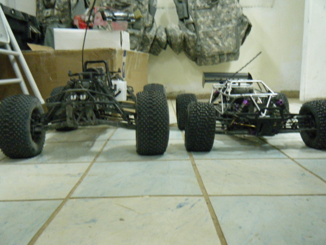

So I ordered this roll cage to try and save my engine and key components. How ever I added like 2 lbs to it. Does anyone have any suggestions? Im not racing just Bashing, and will it kill my diffs any more then if I didn't run it?

That cage weighs that much? [] Wow
If your diffs are shimmed properly the extra weight should make a difference. The big difference you'll see is in jumping. Especially if the weight changed the balance of the truck. The body does a pretty good job of protecting everything especially since its all mounted so low on the chassis.
You get any videos running on that track yet?

ya I got the diffs shimmed Im thinking I need to change out the diff fluid to 10/100/10 to help with the weight, also go back down to the 13CB. I was running 55W oil in the shocks but the front was sagging way bad, so I upped the fronts to 80W and 90W in the rear, hoping that will help......Out here in Iraq it takes forever to upload pictures, I tryed uploading a video but it was uploading all night and had timed out when I got up so there is no way I post a video. Maybe when I go home for R&R I can post it then..........I ran that Savage XL 5.9 on the track, wow that things a tank..........Im taking my time with the HF dont wanna rush in and blow it up....as far as the weight of the roll cage, the HF RTR weighs in at about 9.5 and that roll cage is heavy.......I mean it put a load on the front shocks..they were about half way compressed.........Like I tell my buddies go big or go home.....I will find a way to post a video when I return home in about a month.....Laters
