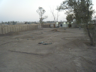

Ok so here are some pictures of the track we have built, its suprising what you can do when you get alot ofSoldiers who have nothing better to do with their time off.......My HF is tearin it up, the New revo is giving it a run forts money but off the line the revo cant hang LOL. I tried uploading acouple of shortvideos but they weretoo large so im trying todown size them. Still having problemswith the heat (but that willhappen) I checked all the simple things, Ithink its too running rich, I tuned it to where the smoke isn't as blue and I adjusted the mid range on it alittle, it helped. How ever when Im giving it throttle(about half)it bogs for a second then takes off like a raped ape......but its not running lean. One other problemthats got me concernedis theservo saver, it keeps locking up on me and wont give? should I leave italittle sloppy? I knowStussman said tighten it up but I think thats howI blew the stock one.....the one I borrowed stripped out one side of the gears so I had to improvise and rig it so it would work...any suggestions?
Go Bigor Go Home

Mc that track looks great. Definitely need bigger pictures though. As far as the video goes, upload it to youtube and then post a link to it.
