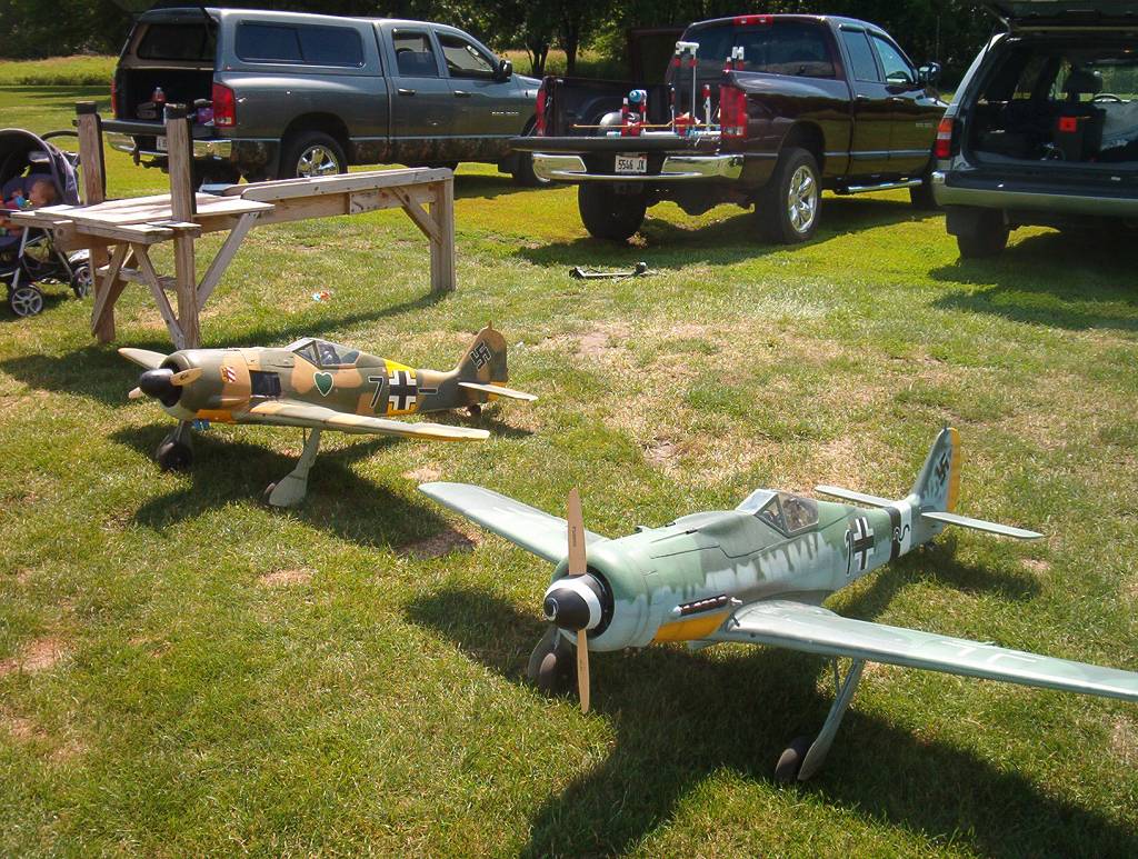

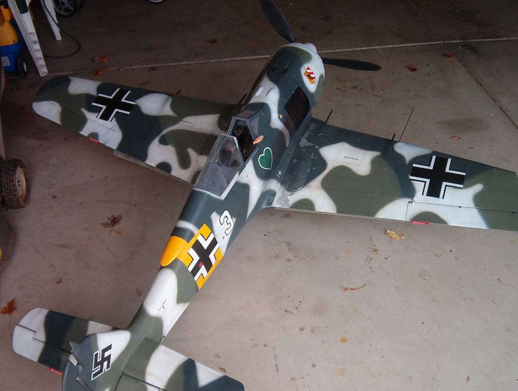

Try Bob Holman. He carries the Don Lien FW kits, both the D9 and the A5-A8 versions. Samples.....

Love the scheme on the first pic ! very cool !

The guns look beautiful.

Thanks fellas. It's one of Nowotny's mounts from JG 54. I think one can get the gun set from Impscale.
Not sure the Devine kit would still be attainable or not, but the Holman kit is tough to beat and has a better scale profile IMHO.
