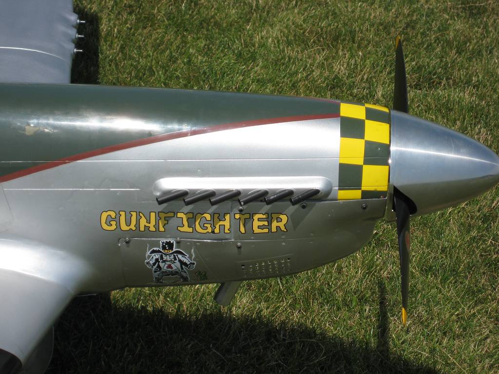

anyone know what is a good engine to put in byron p51 im thinking of taken out reduction drive and going direct drive? 3w75 maybe?

How much does your P-51 weigh? I'm flying mine with a Zenoah G62 and 2 blade Mejzlik 22x10, my P-51 weighs in at 29 lbs. If you want turn a 4 blade prop directly then maybe 3W75 is a good choice. I have 3W75 in another plane with a 24x10 mejzlik and it has signficantly more power than the G62. Not sure how the 3W75 will do with a 4 blade.

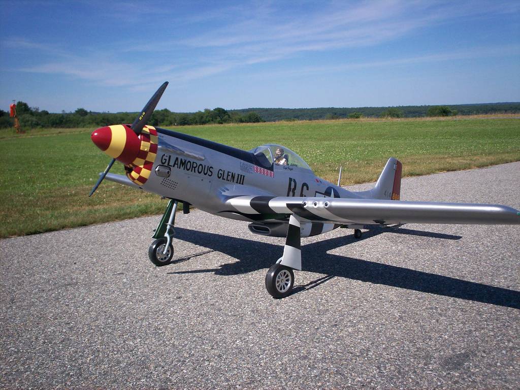

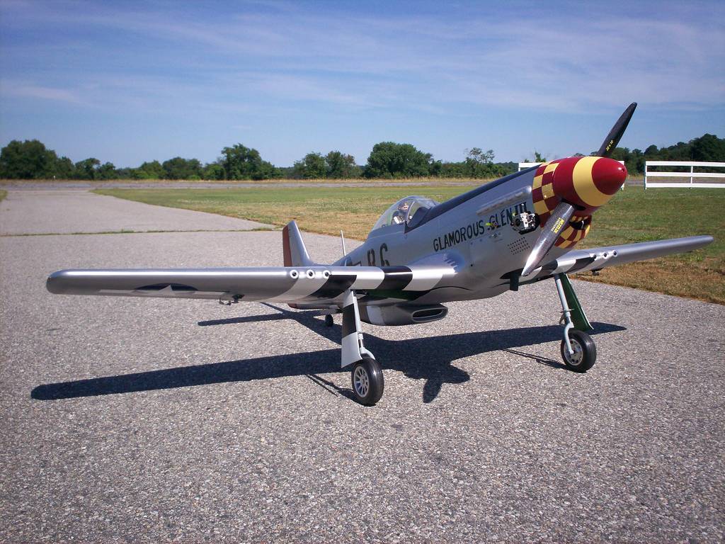

Here's a few pics to show how well the G62 fits. Unfortunately the carb sticks out a bit on the right side and just a piece of the purr power muffler on the left. I think with a wrap around muffler and engine slightly rotated the muffler can be completely hidden.

Old 06-17-2012 | 06:50 PM
Joined: Feb 2012
Posts: 131
From: manorville, NY
Default RE: Byron p51 engine conversion
what do you mean by the old byron mounting sceme? I take it you left the old firewall and made a box type coming out to move engine forward or what? im wondering if they make motor mounts that long to push motor forward, or do i make one from wood?
Old 06-17-2012 | 06:56 PM
Joined: Feb 2012
Posts: 131
plane  looks  great   how  did you cover old  hole  where motor  use to stick out?

The old Byron mounting scheme (at least for the purr power muffler) had two U shaped bulkheads that allowed you to clamp the muffler/engine assembly to. I think the reduction drive is a little different and reduction drive/engine assembly is mounted to the bulkhead (the one just in front of the wing) and a sub bulkhead up front.
What you need to do is add a completely new firewall (1/2" thick aircraft ply) and glass it into the fiberglass fuselage. It will be quite bit further up front than the existing bulkhead (the one just in front of the wing). A buddy of mine, Fred Menna a.k.a. check6 has done a few of these in the past. With a new firewall you can then use a cup mount (Bennett or similar) to mount the G62.

Yes there is  a u type  bulkhead that is  a  upside dowu   glued to the fusalage  like  5  1/2 inches   behind  the  nose cone. so you are saying you   just added a bulkhead there  and  glued it to the cowl that already   has  reinforcement going horizontal  and the upside down u bulkhead. If i understand you  have no other   square box that you built going from the original bulkhead forward to the rear of the new engine?? If i understand you correctly you didnt do that but just added a bulkhead   near front  and  glued to the cowling??????
Old 06-17-2012 | 07:32 PM
ccostant's Avatar
My Feedback: (38)
Joined: Jan 2004
Posts: 581
From: Hopkinton, MA
Right. I did not build a square box extended from the wing bulkhead. As far as how far back from the spinner the new firewall needs to be, you will need to come up with that distance based on the length of the G62 plus cup mount, 5 1/2 inches sounds a little short. I can't say what that dimension is without removing my cowl. I'm not sure what you mean by glued to the cowling? You shouldn't need to glass the new firewall to the cowling just glass it to the fuselage proper. The cowl still needs to be removal for access.

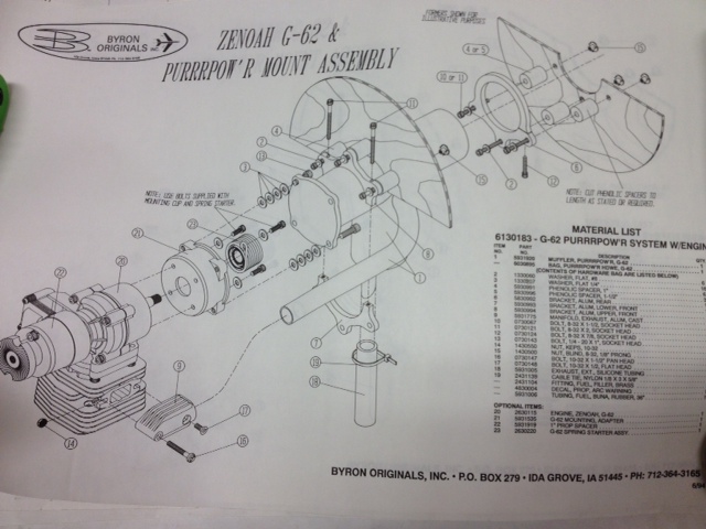

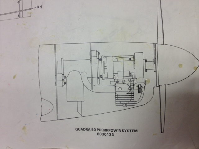

Q-50 and G-62 installation.

Old 06-19-2012 | 07:00 AM
Joined: Feb 2012
Posts: 131
Thanks king air you know where i can get this conversion

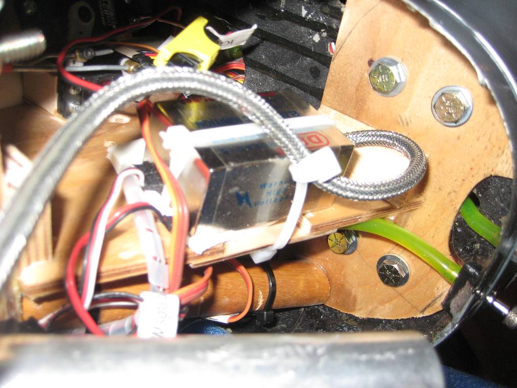

Old 06-19-2012 | 06:01 PM
My Feedback: (7)
Joined: Dec 2008
Posts: 226
From: Owatonna, MN
Comanche,
I aquired a Byron early last year and converted to a direct drive. It has an early DLE 50 in it and does extremely well in the air. My buddies Top FLight with a G45 will out run it but not by much. We essentially built a second firewall forward of the original and it is braced with Basewood blocks, a broom handle & Ply in the center point . I have enclose some pics for you. Please laugh at my expense the broom handle came with the plane. Ended up being a very sturdy brace I inherited. As a testimate to the bracing and forward firewall the pics taken are 2 days after an deadstick that had the plane go nose first into a culvert. Nose foward there is no damage and not a loose joint. Ripped the gear out but that was the worst. In short I have no reservations in moving a second firewall forward and adequately bracing it.
