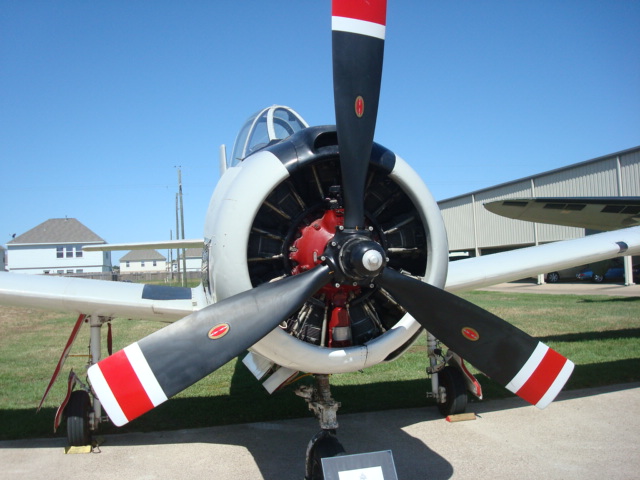

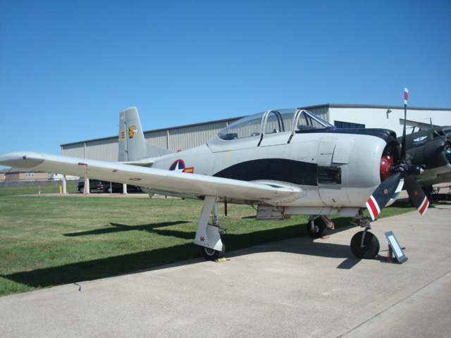

Here is a real low wing T 28 trainer and check out the amount of downthrust it has. Paul
