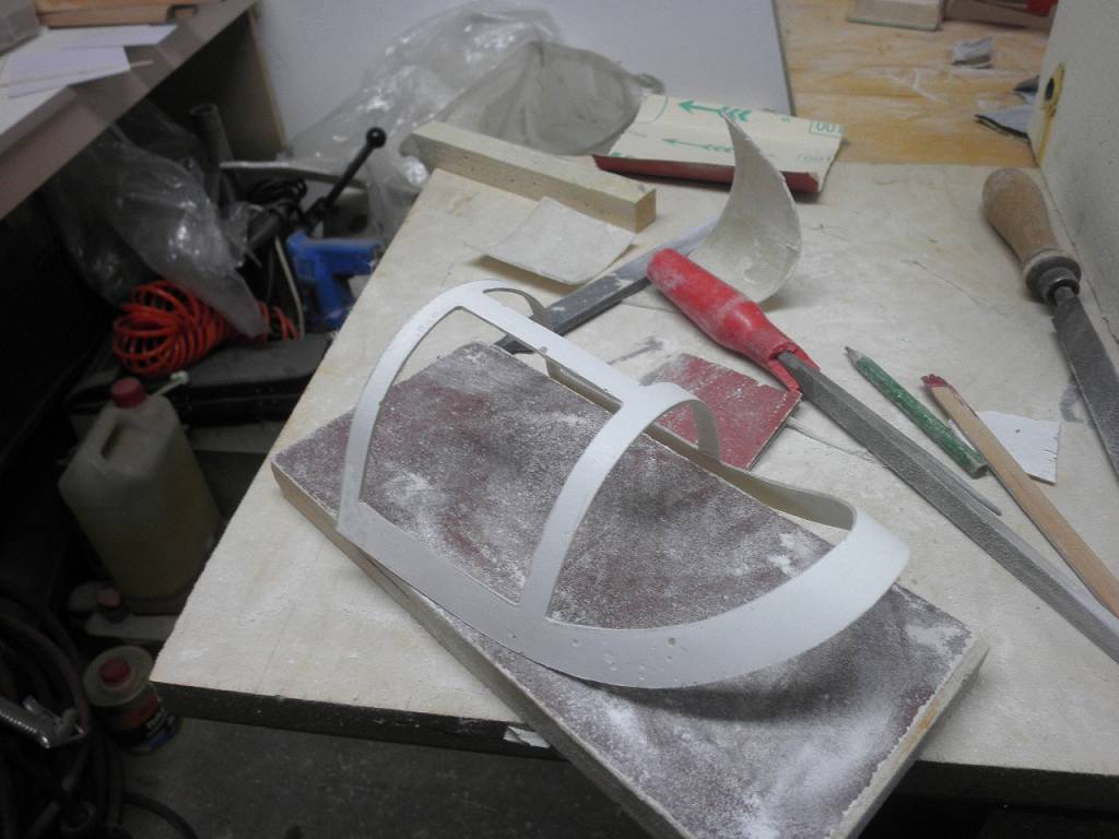

any ideas about how to make canopy frames ? i really dont have a clue

Fiberglass layed up over your canopy, then remove the glass layup, trim to shape c

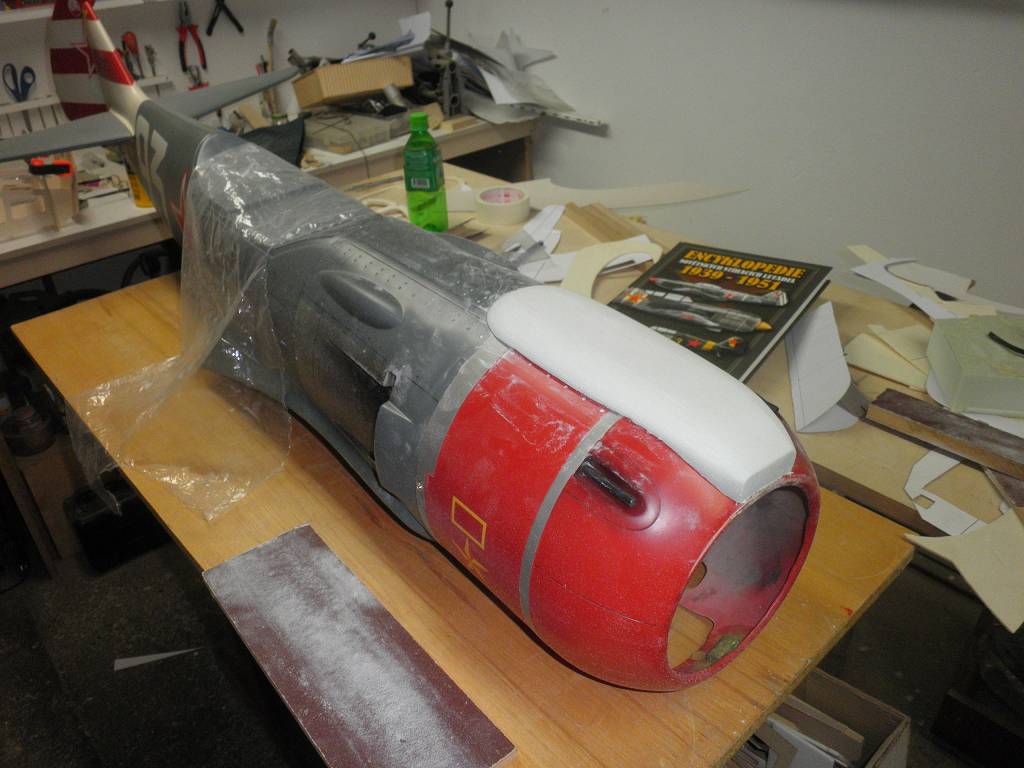

Probably the fiberglass canopy frame is the easiest way how to do it. Here are some pictures. You can make a fiberglass form, or make the frame on the model, which is made from some polystyrene foam (it is in the last three pictures).

Invertmast is right, thats a great way. But don't forget a good release agent!<div>

what would be a good release agent ?

Wax and pva
If its a simple canopy (like FW190, me109, etc) G10 works really well to
