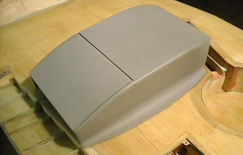

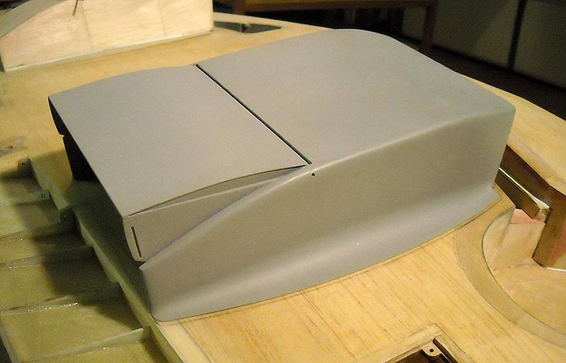

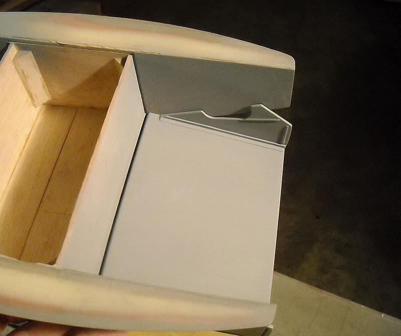

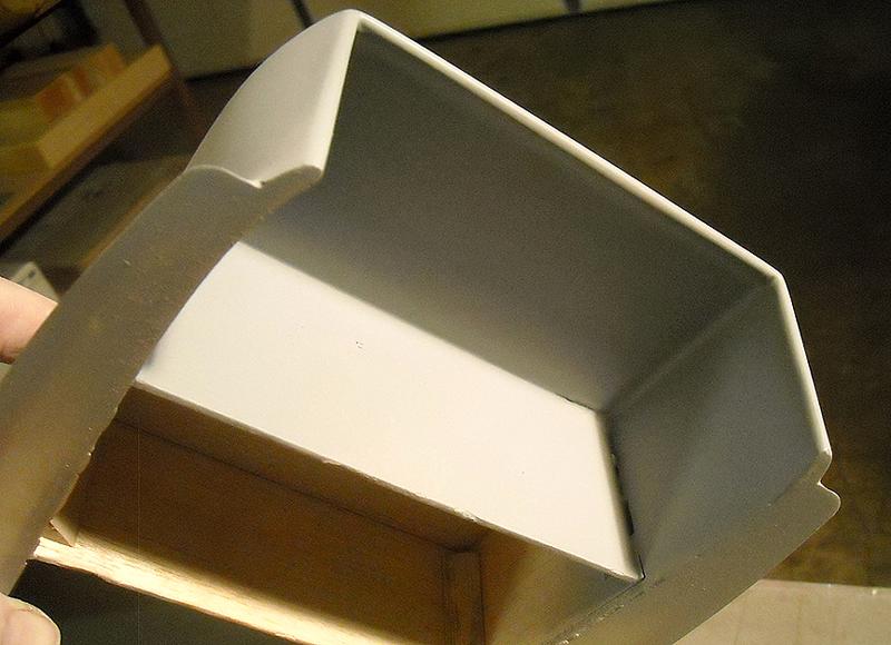

Current efforts are focused on creating a couple of radiator "dog houses" for the Spit. The molded items that came with the kit are nicely done but only bear a passing resemblance to those found on the full size Mk.XIV Spitfire. I was able to track down the engineering drawings and those, combined with some very nice photos I found, were used to make up the new units in wood. We have also decided that the cooling doors will be functional and operated by mini servos. They will probably be tied to either the gear or flaps so that they are open at slow speeds and cleaned up for cruise and high speed flight. I think I have stumbled upon a really neat way to simulate the radiator itself and hope to show that in a day or two. There are still some other details to be added as well so stay tuned.

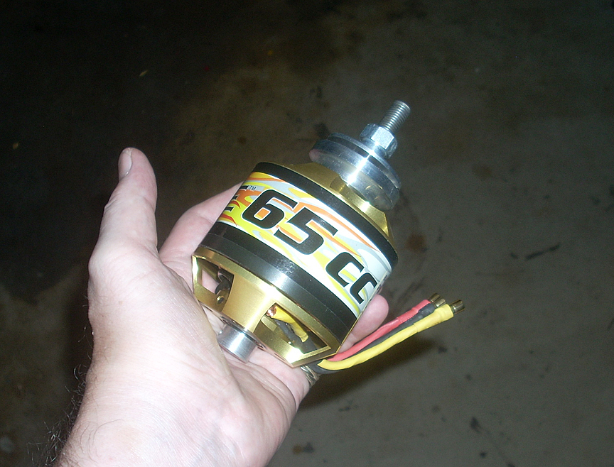

I'm about to get rolling on the construction of a Yellow Spitfire for a friend and thought there may be some interest in the build. I will be doing the majority of the work necessary to get the airplane ready to finish and then we will be working together to do the final detail and paint. With any luck the model will be built to competition level standards in the hopes of attending a few team scale events with it when completed. It will also serve to showcase a few of the products that I currently offer including my built up stab to replace the supplied fiberglass unit, my cockpit kit, my laser cut vinyl surface details, and maybe a few other items if opportunity arrises. In the interest of scale fidelity and with an eye towards competing I intend to modify the wing with scale flaps (including the short inner segments) and scale Friese type ailerons. I'm sure there will be other modifications as the build proceeds. The model will be equipped with a Rimfire 65cc electric motor for power and will be supported by Sierra main gear retracts converted to electric (using Down and Locked components I believe) and a Lado electric tail wheel retract. I will start gluing parts together within the next few days. Construction will not be at lightning speed but, as this is a commission build, progress should come at a steady pace.
Since I am totally illiterate when it comes to electric power I will let the owner chime in if he so chooses with more details about the power system. What I do know is that the Rimfire is a fist full of motor!

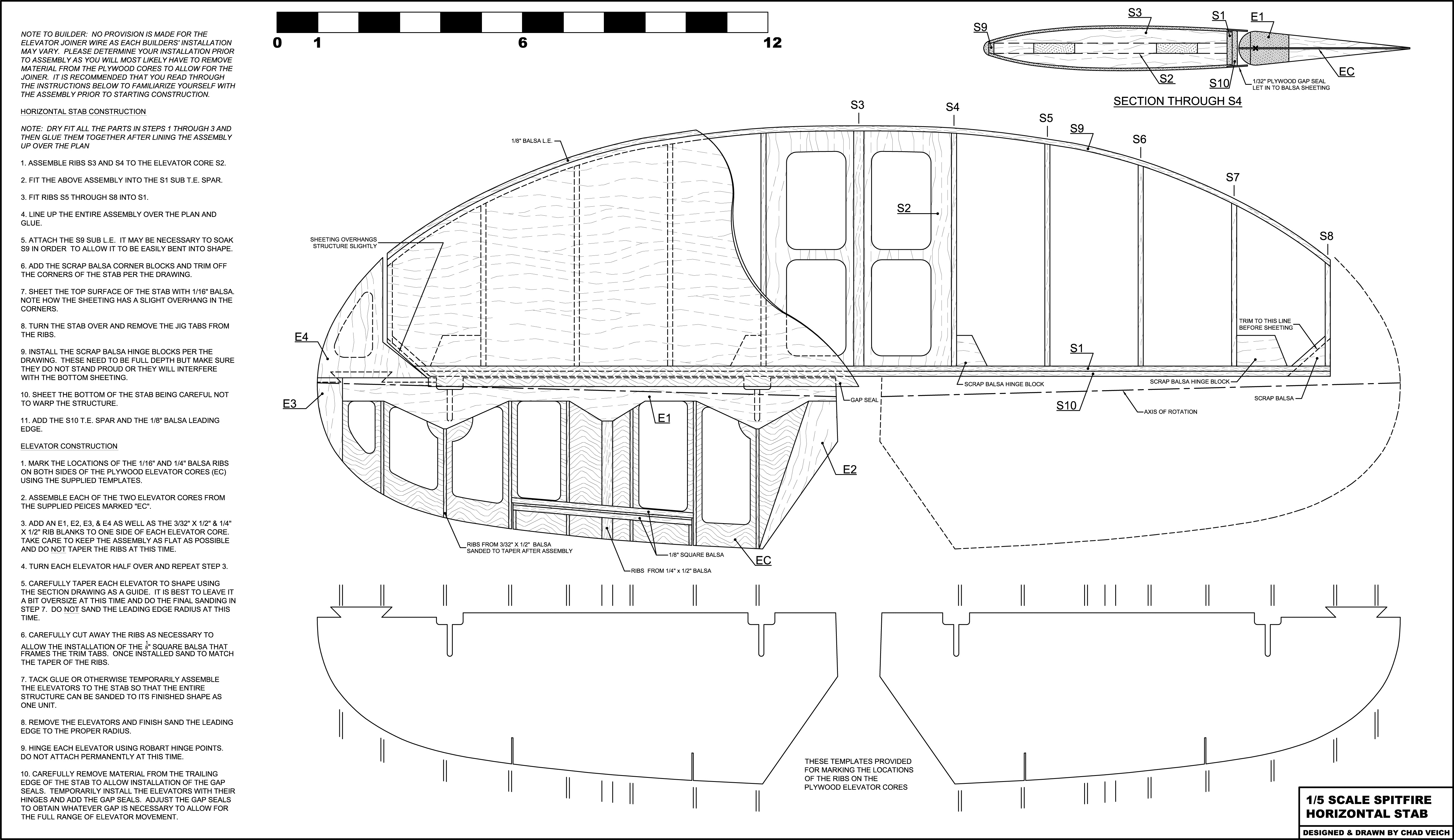

Construction will start with the new built up tail feathers for which I have already cut the parts. Here's the plan and kit.
Attachment 2235327
Attachment 2235328
