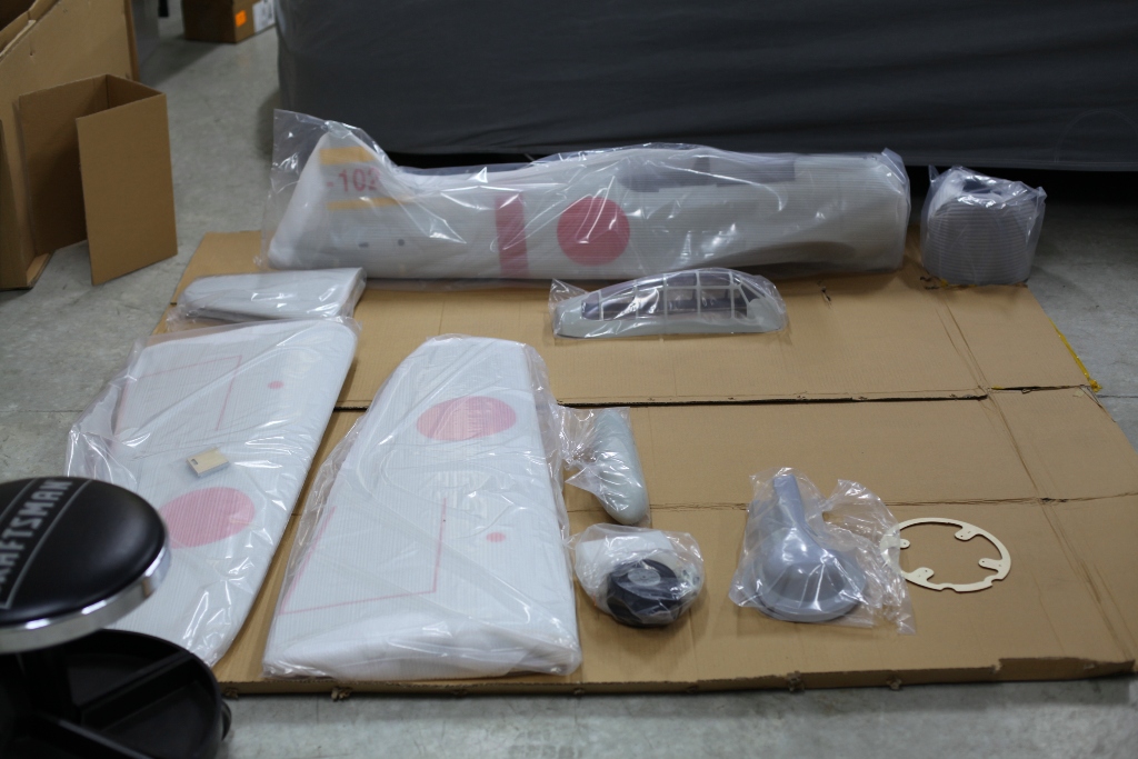

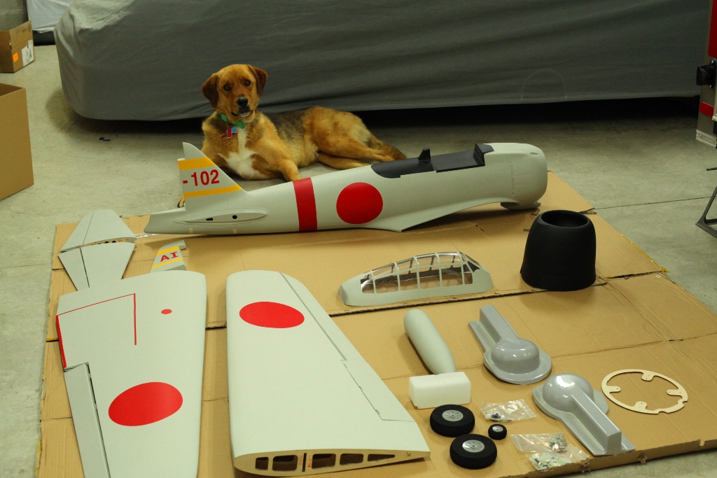

ESM Zero. 88" Wing Span.
Finally got her today from TBM of FL.
<div>This will be my very first warbird build, so suggestions are very much welcome.</div><div>Ordered the factory electric retracts. TBM recommends DA-50 or DLE-50 for engine. Leaning on getting the DA-50.</div><div></div><div>Need suggestions on kind/brand of servos to use for the primary flight controls. Would like to install RELIABLE and BEST Quality servos.</div><div></div><div>Thanks in advance.</div><div>Mike</div>

Use these. Dan.
http://www3.towerhobbies.com/cgi-bin...?&I=LXH305&P=7

The plane will almost certainly come out tail heavy. So a light weight engine is not needed or desirable. A heavier engine will not hurt. Also in your build keep all weight as far forward as possible including building mounts for you batteries and ignition module in the cowl as far forward as possible and keep everything in the tail as light as possible. You will probably still need to add nose weight but maybe not too much. Thats how it was on my 72" wingspan CMP Zero. However, it should be a great flying airplane.

Hs645mg are more the enough for this size plane at half the price of those futabas. You also don't need a $650+ motor like the da50. Being a round cowl...you could fit in an eme60 easily and could also equip it with an electric starter unit. That would be usable nose weight.

Wow! Lots of good tips gents. Thanks! Those are all new to me.
Flying weight would be around 18~20lbs, what minimum torque of the servos should I get?<div></div><div>TIA</div>

These make great flap servos.
http://www.valuehobby.com/radio-syst...hd-1501mg.html

75 inch-ounces. Dan.

Your zero is more then likely going to be closer to 22 pounds. ESMs listed flying weights don't include retracts. Also....troybuiltkodels has PowerHD metal gear servos with 270oz of torque for $14. I have a bunch of them in my 89" spitfire and they work great.

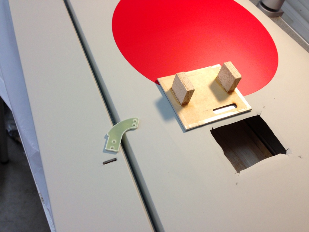

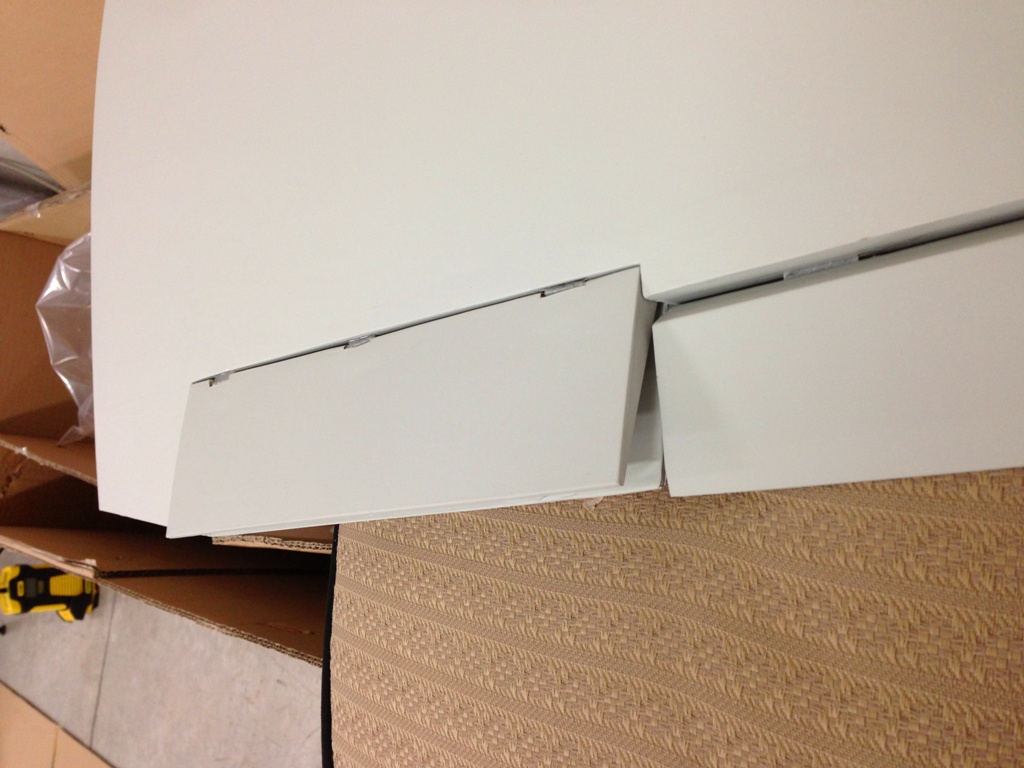

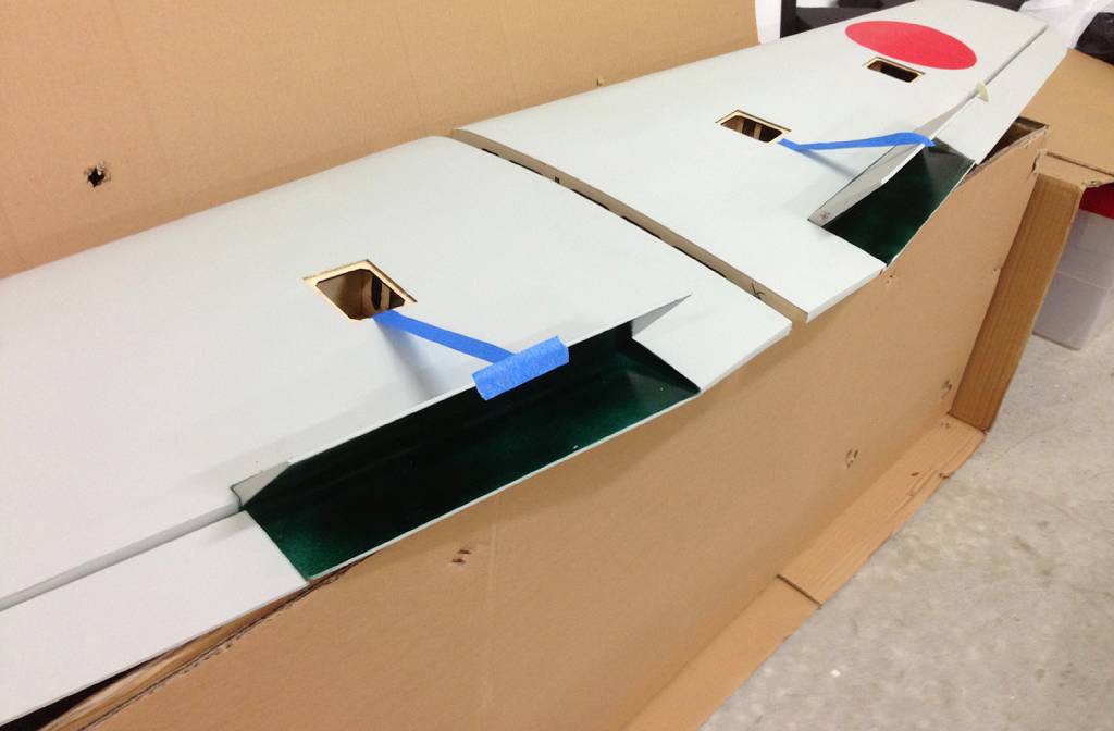

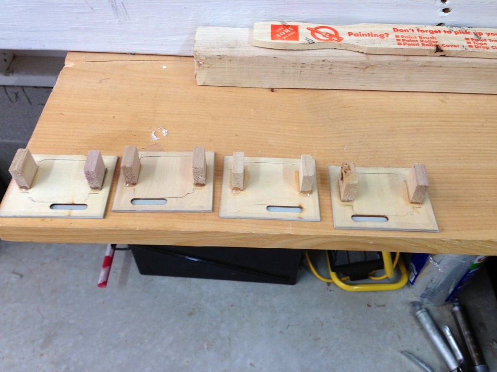

<span style="font-family: Arial;">TGIF! Able to work on the wings and installed the aileron and flaps, plus getting them set up for the servo and horn.</span>

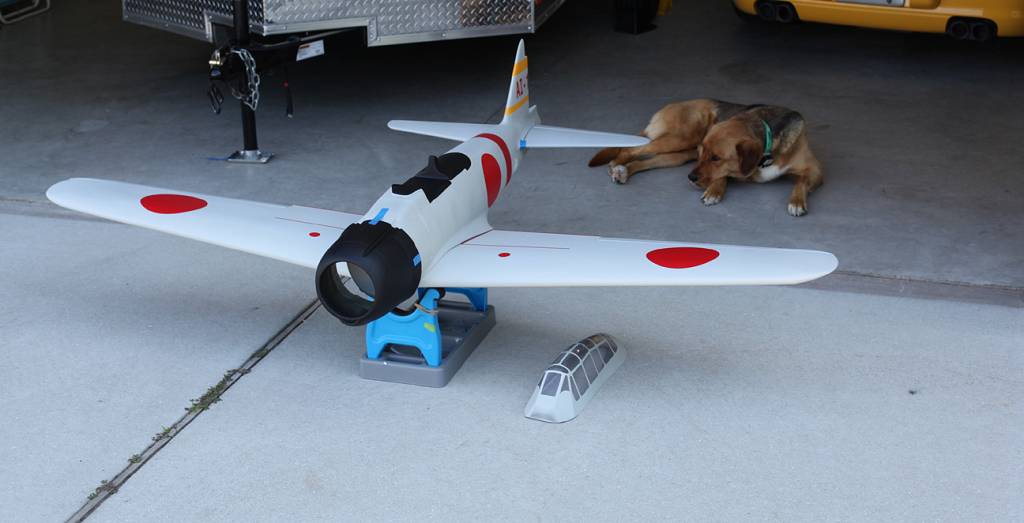

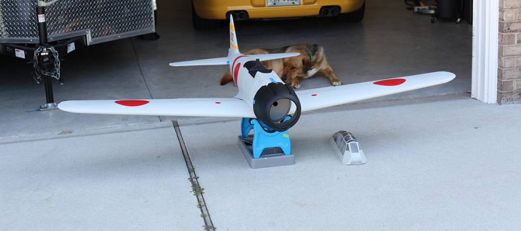

<span style="font-family: arial, helvetica, sans-serif; font-size: 15px;">Found a test pilot too whos brave enough to do the functional flights in few weeks..</span>

That is my #1 worry.... how much weight I will need up front to balance. Great advice in picking the heavy parts for the front (i.e. servos, batts, engine)
Gettign the DA-50 and pitts by the way. Though Im curious about the 80 cc. I do want to stick with scale flight characteristics.

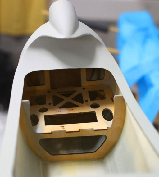

Default RE: ESM ZERO BUILD
Mike,
I am looking to purchase one of these.
Any pictures of the interior(Servo trays and/or formers). I am wondering if there is enough room for a smoke pump and tank.
I am preferring one servo for the flaps with bellcranks.
Mahalo
Mark

ORIGINAL: Flyin Hwn
Mike,
Mahalo
Mark
here you go. I could take more if you want..
Thanks Mike,
Is that all the formers? Pre-glued?
Are the wings glassed or covered? I like to do panel lines and weather
Cowl diameter? I have a G-62 looking for a home
How about a picture of the wheel wells
Sorry for all the questions but TBM site lacks necessary info

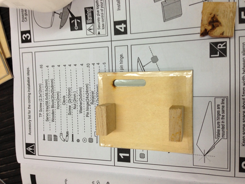

ORIGINAL: carrera mike
<span style=''font-family: Arial;''>TGIF! Able to work on the wings and installed the aileron and flaps, plus getting them set up for the servo and horn.</span>
You should glue your servo blocks grain wise perpendicular to the hatch plates and not parallel to prevent them from splitting from the plates.

Is that all the formers? Pre-glued.
<span style="color: rgb(255, 0, 0); ">Yes</span>
<span style="color: rgb(255, 0, 0); ">Covered</span>
Cowl diameter?
<span style="color: rgb(255, 0, 0); ">Will measure tomorrow</span>
<span style="color: rgb(255, 0, 0); ">I have not cut out the covering.</span>

ORIGINAL: fw190
<span style="">TGIF! Able to work on the wings and installed the aileron and flaps, plus getting them set up for the servo and horn.</span>
thanks for the tip! I did realize that after I dry fit the servos.. I repositioned all the blocks now..
<span style="background-color: rgba(255, 255, 255, 0);">also thinking of screwing and strip of popsicle stick on the backside to tie both of those blocks over the servo.</span>
